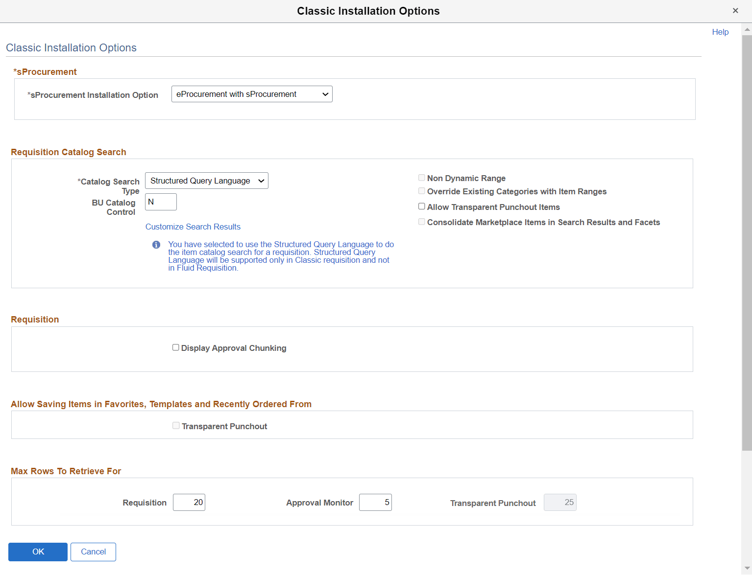

Setting Up Installation Options for Classic eProcurement
PV_CLASSIC_INS_SEC
Determine requisition options for classic user interface pages.
Access is limited to users with the SYSTEM_ADMIN action role.

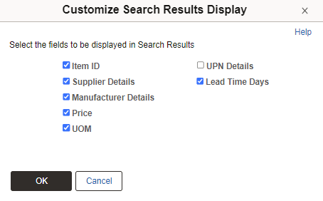

Customize Search Results
Use the Customize Search Results page to determine the fields to display in search results.

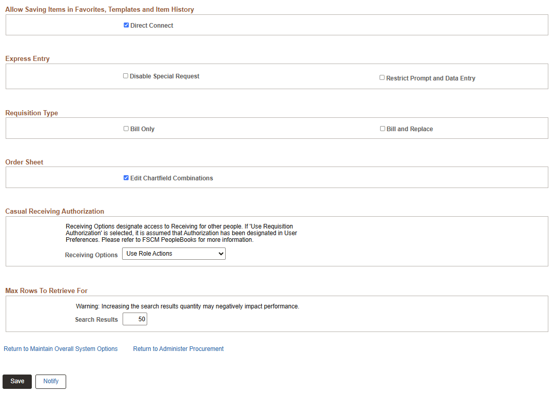

Allow Saving Items in Favorites, Templates and Item History
The field within this group box is used to determine the type of direct connect items that can be saved as a favorite item or on a template list.
Field or Control Description
Direct Connect
Select this check box to allow Punchout and Roundtrip direct connect items to be saved as favorites or as items on a template. This method saves the requester time when creating additional requisitions for the same item.
Deselect this check box to prevent Punchout and Roundtrip items from being added as favorites or template items. Each time the direct connect item is ordered, the requester must use the Web page of the Create Requisition component to access the supplier's online catalog, select the item, and then return to the eProcurement requisition.
Express Entry
Disable Special Request
If the check box is selected, special request item lines will not be available on the Express Entry page. That is, you will be able to add only catalog items. The description field will be display only.
Restrict Prompt and Data Entry
If the check box is not selected, the prompts on the Supplier Information and Manufacturer Information tabs will be open.
If the check box is selected, then:
  • The Supplier ID prompt will display only those suppliers, who have been defined for the item.
  • The Supplier Item ID, Supplier’s Catalog, and UPN ID fields will be display only and will be updated when the Supplier or Manufacturing ID is changed.
  • If the Item and supplier fields are non-blank and the Item/Supplier manufacturers exist, then the Manufacturer ID displays those values. Else, it displays the Item level Manufacturers. If neither of the Item/Supplier or Item level manufacturers exists, the prompt will be blank.
    If the Supplier field is blank, then it displays the Item level prompt.
  • When the Supplier field is blanked out, the system updates the Supplier Item ID, Supplier’s Catalog and details on the Manufacturer Information tab, if the manufacturing information was set up at the Item/ Supplier level. If the manufacturing information was set up at the Item level, then that would not change.
    Note:If the Express Entry Options are unchecked, the fluid Express Entry pages will act very similar to the classic Express Item pages with regard to the prompt values.
Requisition Type
Bill Only and Bill and Replace
  • Bill Only requisition means items were used but no replacements are needed.
  • Bill and Replace requisition means that the part which was used needs to be billed, but a replacement part is also required.
Select any or both the check boxes to configure Requisition Type for the requisition pages. Users can create and manage requisitions for the selected requisition type.
If none of the check boxes are selected, users can create and manage Standard requisitions only.
Order Sheet
Edit ChartField Combinations
Select the Edit ChartField Combinations check box to check the valid ChartField combinations on the distribution lines for an order sheet. If this check box is selected, an error message displays when you save an order sheet with invalid ChartField combinations.
Casual Receiving Authorization
The field within this group box is used to determine the requisition authorization to create Receipt.
Receiving Options
This section allows the requester to receive the requisitions on behalf of another requester. The default action is Use Role Actions.
Select a Receiving Option:
  • Use Role Actions: If selected, the requester can Receive a requisition for others based on certain role actions.
    If RECV_BY_SHIPTO is enabled against a role, the requester can receive all the transactions for a particular Ship To ID that is set up in the user preferences for the user, irrespective of being a requester of record for the transaction.
    If RECV_ALL_SHIPTO is enabled against a role, then the requester with that role will be able to receive for all Ship Tos in the system.
    Note:If both role actions are enabled, then RECV_ALL_SHIPTO will be the one that is used to determine what pending receipt lines the requester can receive against.
  • Use Requisition Authorization: If selected, the requester can receive the requisition based on authorization configuration defined on the Requisition Authorization page.
    The Requisition Authorization page grants a user the authority to perform specific actions for additional requesters. The user can receive on behalf of any requesters (if the check box Full Auth for All Requesters is enabled) or other requesters when Add authority is given. For more details, see Application Fundamentals: User Preferences – Requisition Authorizations Page.
Max Rows To Retrieve For
The field within this group box is used to determine the maximum number of items that can be displayed.
Search Results
Enter the maximum number of values that the system retrieves on page searches. This field only applies to the following pages:
Search Catalog
Advanced Search
Item History
Manage Requisitions
Manage Purchase Orders
Receipts for a Power User
Receipts for a Casual User
My Requisition

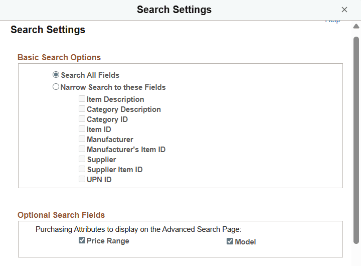

Basic Search Options
Select the attributes in the Basic Search Options to appear on the Advanced Search page.
Optional Search Fields
Select from the given two Purchasing Attributes to be displayed on the Advanced Search page. Attributes are Price Range and Model.
These are optional search fields, which you can select to appear on the Advanced Search page.

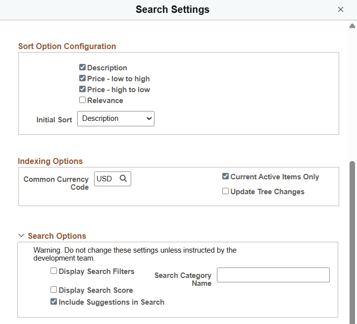

Sort Option Configuration
Select the check boxes to configure the sort options for eProcurement. The selected sort options are displayed in the Sort By drop-down of Create Requisition Search Results page.
Depending on the Initial Sort Option, the Create Requisition search results will be sorted. Once the search result is displayed, you can sort the result as per desired sort option.
Note: Relevance sort option is visible only when the PeopleTools version is 8.59.18, 8.60.06, 8.61, or above. To make Relevance Sort Option available, APPLY_WEIGHTED_SORT Role Action should be enabled for the requester and an active Weighted Sort Rule. To know more about Role Actions, see Maintaining System Users and Roles. To configure Weighted Sort Rules, see Manage Weighted Sort Rules Page.
Indexing Options
  • Common Currency Code:
    Select a common currency code to be used when indexing item prices to facilitate sorting and comparison with indexed prices.
    If the default value of USD is changed after indexing then a full index is required as all item pricing that is stored in the search framework repository would be in this default currency code.
  • Current Active Items Only
  • Update Tree Changes:
    Select this check box for running the Tree update during incremental run.
Search Options
Select required search framework options.
Select Display Search Score check box to display the search score on the requisition catalog search result. This option is intended for developers only.
Select the Include Suggestions in Search check box to view a list of suggested items as you type in the search bar on the Create Requisition: Browse Catalogs Page. These suggestions help you quickly find relevant items. To display items in the suggestion list, you must deploy the following Search Definitions for each category on the Deploy Search Definition page and ensure they are enabled for RTI.
  • EP_PV_SRCH_CO_TMPL_SD
  • EP_PV_SRCH_DC_SD
  • EP_PV_SRCH_FORM_SD
  • EP_PV_SRCH_FVRT_SD
  • EP_PV_SRCH_FVGP_SD
  • EP_PV_SRCH_OS_SD
  • EP_PV_SRCH_RCNT_SD
  • EP_PV_SRCH_TMPL_SD
Note: This field only appears when the Search Widget feature is taken, or the customer is on image 56 or higher and also has the correct Tools version.

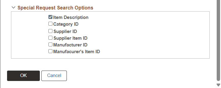

Special Request Search Options
Select the attributes in the Special Request Search Options to appear on the Advanced Search page.
Customize Search Results Display Page
Use the Customize Search Results Display page (PV_SRCH_DISP_SEC) to determine the fields to display in search results.

This example illustrates the fields and controls on the Customize Search Results Display page.
Use the Classic Installation Options page (PV_CLASSIC_INS_SEC) to determine requisition options for classic user interface pages.
Navigation:
eProcurement, and then Administer Procurement, and then Maintain Overall System Options, and then eProcurement Installation Options
Select Classic Installation Options link.
This example illustrates the fields and controls on the Classic Installation Options Page. You can find definitions for fields and controls later on this page.
sProcurement
sProcurement Installation Option
Select the type of PeopleSoft Services Procurement options that you want to use. You can integrate PeopleSoft eProcurement with PeopleSoft Services Procurement, use PeopleSoft Services Procurement as a standalone application, or select not to use the PeopleSoft Services Procurement application.
Requisition Catalog Search
The fields within the Requisition Catalog Search group box are used to configure the item search and catalog browse abilities within the Create Requisition component.
Catalog Search Type
Select the type of catalog and item search to use on the Catalog page in the Create Requisition component.
Options are:
  • Search Engine: Select for quick and effective search.
    Note:Select this option once specific eProcurement search definitions and search categories have been deployed and indexing has been run for the search definitions.
  • Structured Query Language: Used for limited search and is not recommended to be used in production environments.
BU Catalog control (business unit catalog control) business unit catalog control catalog control, business unit
To limit the access of item catalogs within certain business units, enter Y, and access the Assign Catalog to Business Unit page to set up the item catalogs to use in each business unit. Enter N to enable every business unit to access all catalogs. If you are using the rule-based item catalog security feature, use this field and the Assign Catalogs to Business Unit page in coordination with the Catalog Security page.
This field is available only when rule based catalog security is activated for the business unit.
Non Dynamic Range
Select this check box to use non-dynamic range categories for the item search and catalog browse feature within the Create Requisition component. If an item category is marked as a non-dynamic range in PeopleTool Tree Manager then the item search returns only those items that belong to the catalogs that the user has access to and are within the item ranges specified in the item categories and sub-categories of the accessible catalogs. In addition, selecting this check box enables the item load processes for CUP file sources and Catalog Management sources to load non-dynamic item ranges defined for a category.
Deselect this check box to treat all item categories as dynamic ranges within the item search and catalog browse feature of the Create Requisition component. Search results include all items belonging to the specified category and is not limited to any item ranges defined for the category. In addition, deselecting this check box prevents the item load processes for CUP file sources and Catalog Management sources from loading non-dynamic item ranges.
Override Existing Categories with Item Ranges
Select this check box to enable the item load processes for CUP file sources and Catalog Management sources to change categories from dynamic to non-dynamic when loading items into an existing category. In other words, if items loaded belong to existing categories, these categories will all have non-dynamic item ranges loaded regardless of its original type; a category that was originally a dynamic category, is now changed to non-dynamic with item ranges. Any new categories are created as non-dynamic ranges.
Deselect this check box to enable the item load processes for CUP file sources and Catalog Management sources to retain the category type (dynamic or non-dynamic) when loading items into an existing category. In other words, if the existing categories have item ranges, then new item ranges are loaded; however, if the existing categories are dynamic, then no new item ranges are loaded. Any new categories are created as non-dynamic ranges.
Allow Transparent Punchout Items
Select to enable the Transparent Punchout feature and display the Transparent Punchout Node field on the Linked Supplier page.
Note: Only if this field is selected, the Transparent Punchout field in Allow Saving Items in Favorites and Templates From and Max Rows To Retrieve For section is enabled for editing.
Consolidate Marketplace Items in Search Results and Facets
Select to display internal and external marketplace items in a single search result tab. Also facets will combine both external and internal items while filtering.
Note: This check box is available only when the field Catalog Search Type is set to Search Engine option and Allow Transparent Punchout Items check box is selected.

Allow Saving Items in Favorites, Templates and Recently Ordered From
Click this check box to allow Transparent Punchout items to be added as a favorite or included in a template.
For more information on Transparent Punchout see Understanding Transparent Punchout
Note: This check box is enabled for editing only if Allow Transparent Punchout Items check box is selected.
The fields within this group box are used to determine the maximum number of items that can be displayed.
Requisition
Enter a value that determines the number of requisition lines to be displayed in chunks on the Edit Requisition - Review and Submit page. The system automatically defaults to value 9999. You can override this value. However, this value does not impact the number of requisitions retrieved while searching for requisitions.
Approval Monitor
Enter a value to control the display of requisition lines for approval on the Requisition Confirmation page and Requisition Approval page.
Chunking displays the requisition lines in groups to make large requisitions more manageable. The size of the group is determined by the value entered for this field.
If Display Approval Chunking check box is selected and Approval Monitor value is set to for example 5, then the requisition with line level approval will trigger approval chunking on eProcurement Confirmation and Manage Requisition Approval pages when the requisition lines for approval exceed five.
