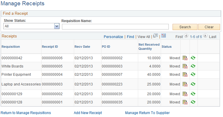

Manage Receipts Page
PV_RECV_UPDATE_REQ
View recorded receipts. Add details, return items to supplier, or cancel a receipt.

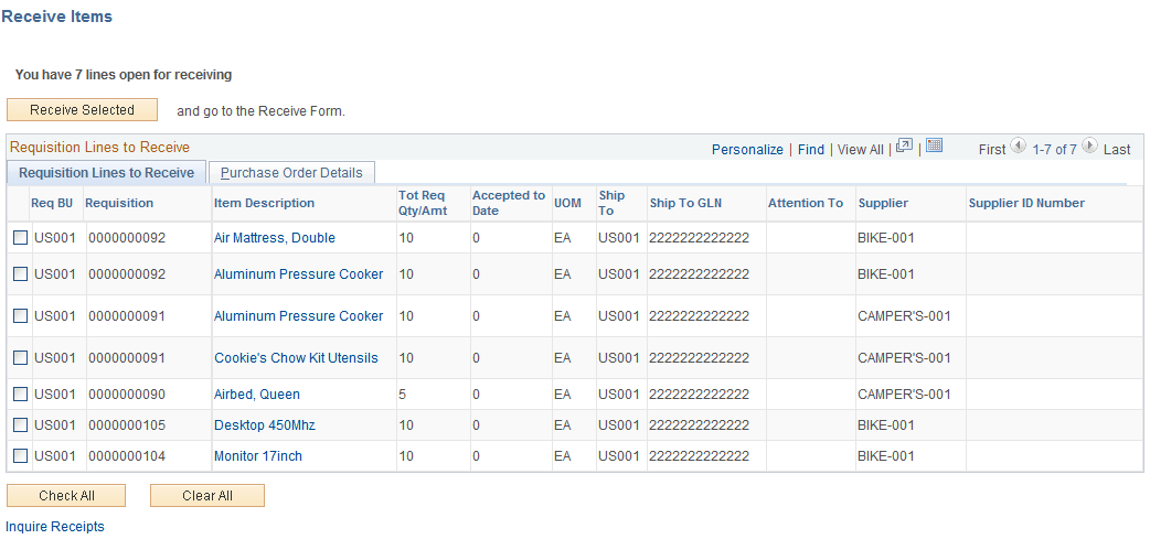

Receive Items Page
Use the Receive Items page (PV_PO_PICK_ORDERSC) to select items to receive.
Navigation:
eProcurement, and then Receive Items
This example illustrates the fields and controls on the Receive Items page. You can find definitions for the fields and controls later on this page.
Receive Items page
For a requisition line to appear on this page, the item must have been placed on a PO and dispatched to the supplier. You can view the requisitions that you entered and those that were purchased for you. When the entire quantity of the item has been received, the requisition line no longer appears on this page.
Requisition Lines to Receive Tab
Field or Control Description
Receive Selected
Click to receive the requisition lines that you select on this page. The system displays the Receive page, where you can make changes to the receipt quantity, review requisition details, and add comments.
Requisition
Select the check box to the left of the line, and click Receive Selected to display the Receive page.
Item Description
Click to access the Item Description page, where you can review item details and an item image, if it's available.
Total Req Qty/Amt (total requested quantity/amount)
Displays a quantity only if one of the lines was over received and a return to supplier (RTV) was created to return the excess stock. This is the quantity that you expect to receive (the requisition quantity or the overage amount).
Accepted to Date
Displays the number of items that have been accepted to date.
Ship To
Displays the business unit to which the requisition item is going to be shipped.
Attention To
Displays the name of the individual who should receive the items or services on this requisition line. Once the shipment is physically received, this individual should record the receipt, enabling the buyers to track the quality and promptness of the supplier.
Supplier
Displays the supplier who is supplying the item.
Check All
Click this button to select all requisition lines with the same supplier as the first line or as the line you have already selected. One receipt can include only one supplier; therefore, not all displayed lines are selected by this button.
Inquire Receipts and Manage Return to Suppliers
Click these links to display previously recorded receipts or RTVs for the requisitions. This information verifies that a receipt form or an RTV has been entered for this shipment.
WARNING:
Do not change the RTV Adjust Sourcing option after transactions have been recorded in PeopleSoft eProcurement. Changing this option may alter the quantities that appear so that they become inconsistent in the PeopleSoft eProcurement receiving and RTV transactions.
Purchase Order Details Tab
Select the Purchase Order Details tab.
PO Qty (purchase order quantity)
Displays the quantity for this PO.
Recv Reqd (receiving required)
Displays Y (yes) or N (no) to indicate whether the item requires receiving to pay the supplier for the goods. You do not need to enter a receipt for any item that is marked with N.

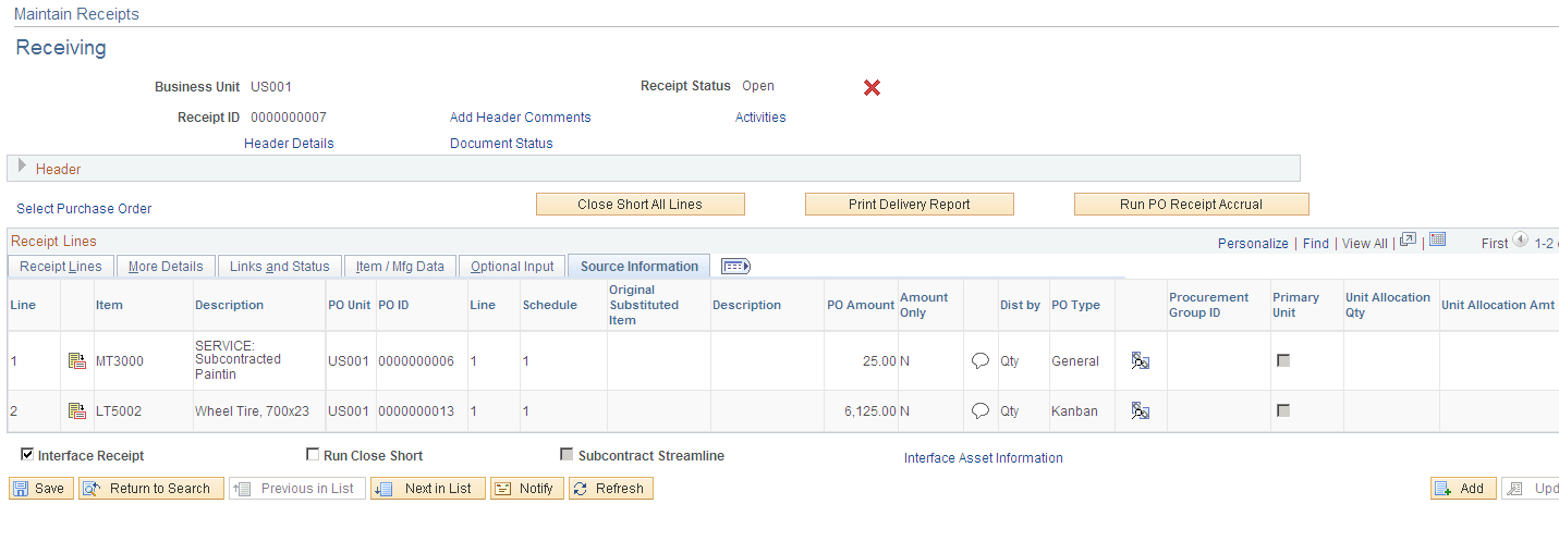

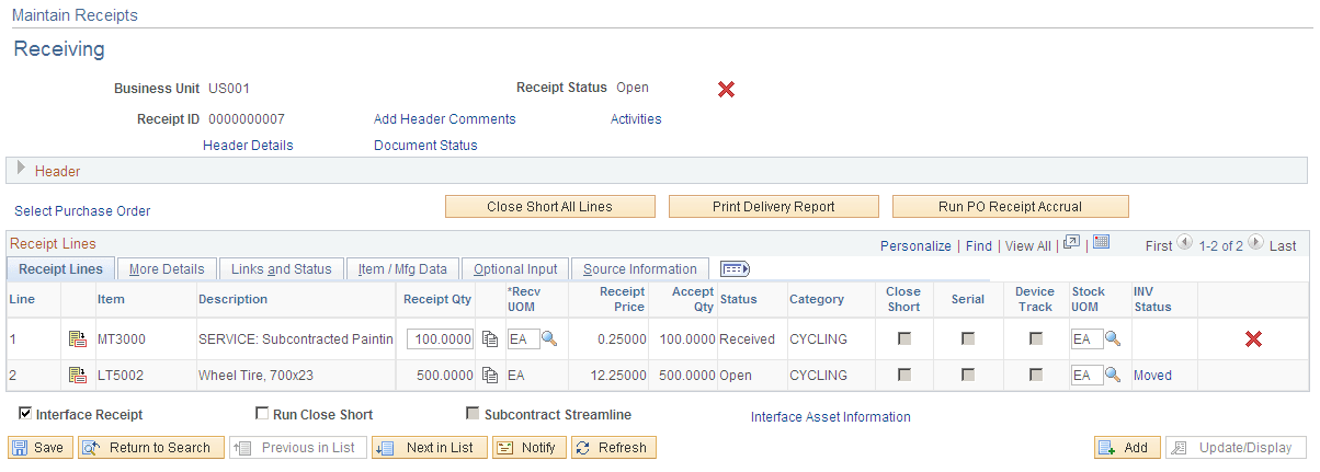

Receive Page
Use the Receive page (PV_RECV_WPO) to add or change a receipt.
Navigation:
Search for items to retrieve, and then click the Details icon of the item to review or update.
This example illustrates the fields and controls on the Receive page. You can find definitions for the fields and controls later on this page.
Receive page
This example illustrates the fields and controls on the Source Information page. You can find definitions for the fields and controls later on this page.
Add a new receipt of one or more PO lines and reject and inspect received quantities. Before creating a receipt, verify that the PO was dispatched.
Receipt No (receipt number) or New Receipt
Displays the receipt ID that was assigned when the receipt was entered. If you are adding a new receipt, the words New Receipt appear until the page is saved. Then a receipt ID is assigned automatically.
Received Date
Enter the date that the shipment arrived. The default is today's date, but you can change it if the shipment arrived earlier.
Add Header Comments
Select to access the Receipt Header Comments page, where you can record one or more comments at the header-level of this receipt and add attachments. This link is not visible unless your user ID is linked to the eProcurement role action of MULTI_COMMENTS.
Reject Shipment
Click to access the Reject Shipment page, where you can reject some or all of the items that are sent to you.
Item Description
Click this link to view a detailed description and picture (if available) of the item.
Received Qty (received quantity)
Enter the quantity of the items that you received.
Clone Quantity
Click the Clone Quantity button to copy the received quantity from one line to all other lines on this form. This button saves data entry steps when you have many line items.
UOM (unit of measure)
Select the type of unit by which the item was shipped to you, for example, by box, each, and so on.
Accept Qty (accept quantity)
Displays the number of items that you are accepting. If you do not reject any items by clicking the Reject Shipment link and entering the quantity that you are rejecting on the Reject Shipment page, the system assumes that you are accepting all of the items that you received. If you rejected any items, the system automatically calculates the accepted quantity when you click OK.
Details icon
Click the Details button to access the Line Details page, where you can view more data about the item, the PO that you are receiving, and the previous and current receipts.
Receive Comments icon(Receive Comments icon)
Select this icon to access the Receipt Line Comments page, where you can record the condition of the shipment when it arrived at the location (good, fair, or damaged), add comments about the receipt line, and add attachments to the receipt line. You are limited to one comment and no attachments unless your user ID is linked to the eProcurement role action of MULTI_COMMENTS.
PO Comments icon(PO Comments icon)
Select this icon to view comments added on the purchase order at the header-level, line-level, or ship to level. To appear here, the purchase order comments must have been marked with the Show at Receipt check box.
Asset Status
Click to access the Asset Management Information page, where you can view or change the fixed asset information, such as serial ID and asset profile ID. This link appears only if the item is designated as a fixed asset for PeopleSoft Asset Management.
Inventory Status
Click to access the Inventory Putaway Information page, where you can view or change the inventory information, such as serial ID and warehouse location. This link appears only if the item is designated as a PeopleSoft Inventory item.
Device Tracking icon (Device Tracking icon)
Click the Device Tracking button to access the Device Tracking page.
Inquire Return to Suppliers
Click to access the Manage Return to Suppliers page, where you can view a list of suppliers from which you have canceled orders, closed orders, open orders, or shipped orders.
Inquire Receipts
Click to access the Manage Receipts page, where you can view a list of requisitions, receipt numbers, received date, PO IDs, received quantity, and status of receipts.

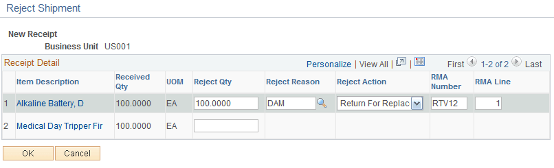

Reject Shipment Page
Use the Reject Shipment page (PV_RECV_REJECT) to reject a shipment.
Navigation:
Click the Reject Shipment link on the Receive page.
This example illustrates the fields and controls on the Reject Shipment page. You can find definitions for the fields and controls later on this page.
Reject some or all of the items that you are recording in this receipt by entering information about each item that you are rejecting.
Reject Qty (reject quantity)
Enter the quantity of the item that you are rejecting. This can be all or part of the quantity that was delivered to you (the received quantity). When you enter a quantity and move out of the field, the remaining fields on this page are available for entry.
Reject Reason
Select the reason why you are rejecting the items.
Reject Action
Select how you want the supplier to correct the mistake. This is an information field; to return stock to the supplier, use the Return to Supplier page.
RMA Number (return material authorization number) and RMA Line (return material authorization line)
Enter the return material authorization number and line number that the supplier provided .

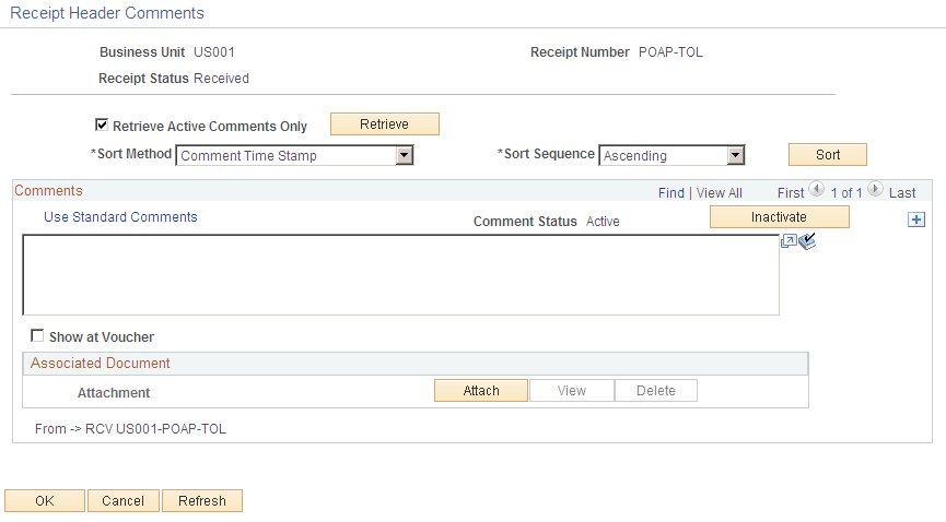

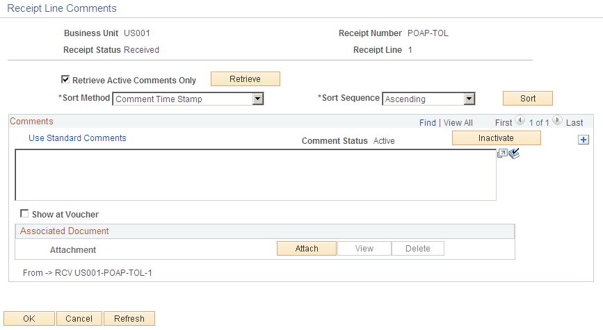

Receipt Header Comments Page
The Receipt Header Comments page and the Receipt Line Comments page use the same fields. Navigation is different and each page adds comments and attachments to a different part of the receipt.
Use the Receipt Header Comments page (PV_RECV_COMMENTS) to record one or more comments at the header level of this receipt and add attachments.
You cannot access this page unless your user ID is linked to the eProcurement role action of MULTI_COMMENTS.
Navigation:
Click the Add Header Comments link on the Receive page.
This example illustrates the fields and controls on the Receipt Header Comments page. You can find definitions for the fields and controls later on this page.
This example illustrates the fields and controls on the Receipt Line Comments page. You can find definitions for the fields and controls later on this page.
Condition
(Receipt Line Comment page only) Select the general condition of the shipment; the options are Good, Fair, and Damaged.
Add a New Row icon(Add a New Row icon)
Select to add a new comment field. Comments are numbered as you add them.
Use Standard Comments
Click to access the Standard Comments page (PV_STD_COMM_SEC), where you can select a standard comment to be applied as a comment to this receipt. Standard comments are frequently used comments that have been defined in the system using the Standard Comments (STANDARD_COMMENTS) and Standard Comment Type (STD_COMMENT_TYPE) components.
See PeopleSoft Source to Settle Common Information: Setting Up Standard Comments.
Spell Check Comment icon(Spell Check Comment icon)
Click to perform a spell check on the comment.
Add Attachments
Click to access the File Attachments window, where you can browse and select a file to be attached to this comment. Only one file can be attached to each comment. Once a file is attached, the Attachment group box displays the file details including file name, the user who attached it, and the date and time it was attached. The Send Supplier check box applies to each file separately.
Show at Voucher
Select if you want this comment to appear on the voucher.
OK
Select to return to the Receive page with the comments and attachments that you have added on this page.
Cancel
Select to return to the Receive page without saving the changes that were added to this page.
Use the Manage Receipts page (PV_RECV_UPDATE_REQ) to view recorded receipts.
Navigation:
Click the Inquire Receipts link on the Receive page.
This example illustrates the fields and controls on the Manage Receipts page. You can find definitions for the fields and controls later on this page.
The maximum number of rows that are retrieved and that appear on this page can be defined on the eProcurement Installation Options page. If the search returns more than the defined number of rows, an error message appears.
Show Status
Select to view receipts with these statuses:
  • All: Receipts of any status.
  • Closed/Cancelled: Receipts that have been closed or canceled.
  • Closed: Receipts have been completed. No further processing is required.
  • Moved: Receipts that have been entered, have passed all edits, and have been sent to PeopleSoft Inventory or Asset Management.
  • Received/Open: Receipts with the status Open or Received. This is the default status.
Requisition Name
Search by the name of a specific requisition. The requisition name is the name that the requester assigned when creating the requisition. If a name was not assigned, the system uses the requisition ID as the name. This limits the search results to one specific requisition.
Details icon
Click the Details button to access the Receive page, where you can view and change this receipt.
RTV Setup icon
Click the RTV Setup button to access the Select Receipts to Return page, where you can enter the information that is needed to return the items to the supplier. If this button is unavailable, the item is a PeopleSoft Inventory or Asset Management item, and you must Move the status of the receipt before you can enter an RTV.
Cancel icon
Click the Cancel button to access the Cancel Receipt page, where you can view a list of the items on the receipt and then either choose to cancel the receipt or return to the Manage Receipts page.
