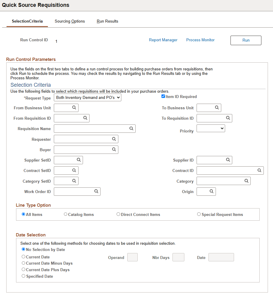

Use the Selection Criteria page (PV_RUN_REQSORC_1) to enter parameters for the AutoSelect Requisitions process.
Navigation:
eProcurement, and then Buyer Center, and then Quick Source Requisitions, and then Selection Criteria
This example illustrates the fields and controls on the Selection Criteria page of the Quick Source Requisitions component. You can find definitions for the fields and controls later on this page.
