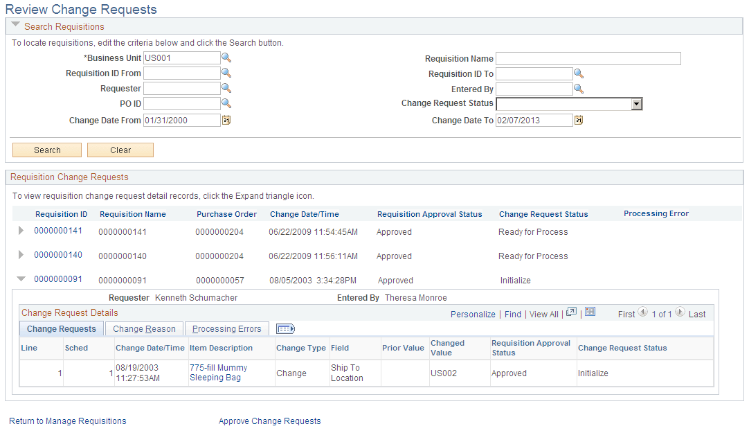

Review Change Requests (Classic) Page
Use the Review Change Requests (Classic) page (PV_CHNG_RQST_LIST) to view and monitor the approval status of your change requests using the Classic User Interface.
Navigation:
eProcurement, and then Manage Requisitions
Click the Inquire Change Request link on the Manage Requisitions page.
This example illustrates the fields and controls on the Review Change Requests (Classic) page. You can find definitions for the fields and controls later on this page.
Review Change Requests page
Search Requisitions group box
Enter search criteria and the click the Search button to display change requests in the Requisition Change Requests group box.
Field or Control Description
Business Unit
Enter the Purchasing business unit of the change request. This is a required field.
Requisition ID From and Requisition ID To
Enter one or a range of requisition IDs.
Entered By
Search by the user ID who entered the requisition. This is the REQ_HDR.OPRID field in the REQ_HDR table.
Change Process Status
Select the status of the change requests you want to view. This is the CHG_PROCESS_STATUS field in the CHNG_RQST_DTL table. Values are:
  • Initialized: The change request has been added but it has not been picked up by PeopleSoft Purchasing.
  • In Process: The system is currently using this change request to update a purchase order and maybe build a PO change order.
  • Complete: The purchase order has been updated with the changes from this change request and a PO change order may have been created.
  • Errors: The Change Purchase Order process attempted to update the purchase order with the changes from this change request but an error was encountered.
The Requisition Change Requests group box displays the change requests that match your search criteria.
Expand Section icon
Click the Expand Section icon to display information about each requisition change request, including; the individual requisition lines, the changes made to the original requisition, change reason codes and comments, and any processing errors.
Requisition ID
Click the requisition ID link to access the Requisition Details page (PV_REQ_PO_DTLS) where you can review each line, the purchase order line it was sourced to, and the status of the purchase order.
See Requisition Details Page.
Purchase Order
Displays the purchase order ID linked to this sourced requisition.
Change Date/Time
Displays the date and time of the changes to the requisition.
Re-Approval Status
Displays the approval status of the changed requisition within the approval workflow framework. The options are pending, denied, approved, or see below (lines do not have the same status).
Change Request Status
Displays the status of the requisition change request. This is the CHG_PROCESS_STATUS field in the CHNG_RQST_DTL table. Values are:
  • Initialize: The change request has been added.
  • Ready for Process: The change request is ready to be picked up by PeopleSoft Purchasing.
Processing Error
Displays Y if any of the change request lines have processing errors. The message set, message number, and message are displayed in the Processing Errors tab under the Expand Section icon. This processing error occurs when the change request is pick up by the Change Purchase Orders process in PeopleSoft Purchasing.

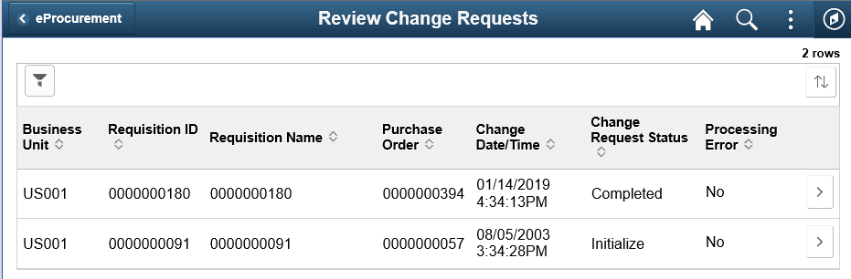

Review Change Requests (Fluid) Page
Use the Review Change Request (Fluid) page (PV_MOV_855_CHNG_FL) to view all of your change requests using the Fluid User Interface.
Navigation:
eProcurement Tile, and then Change Requests tile
This example illustrates the fields and controls on the Review Change Requests (Fluid) Page.
Use filters to narrow the displayed result. The From Date that appears on this page is based on the entered Fluid Filter Default Days on the Installation Options page. If no From Date is defined, then the default From Date is 14 days from the current date. You can also configure common filter values retention and filter search field options on the Installation Options page. To know more, refer to the Filter Retention Options section on the Setting Up Installation Options for Fluid eProcurement.

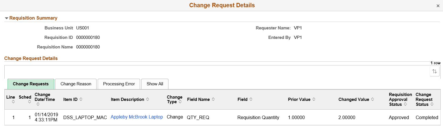

Change Request Details (Fluid) Page
Use the Change Request Details (Fluid) page (PV_MOB_855_CHNGSCF) to monitor the approval status of a change request using the Fluid User Interface.
Navigation:
eProcurement Tile, and then Change Requests tile. Select the Details button.
This example illustrates the fields and controls on the Change Request Details (Fluid) page. You can find definitions for the fields and controls later on this page.
Change Requests Tab
Item Description link
Select to access the Item Description window, which provides a requisition summary.
Change Reason Tab
Use this information to view the change reason.
