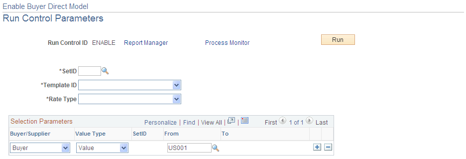

Enable Buyer Direct Model - Run Control Parameters Page
Use the Enable Buyer Direct Model - Run Control Parameters page (EM_ENABLE_AP_RUN) to specify run parameters for the Enable AP BUs & Suppliers for BD (enable payables business units and suppliers for buyer direct model) Application Engine process (EM_ENABLE_BU) and run the process.
It creates a PeopleSoft eSettlements buyer for each PeopleSoft Payables business unit, and a PeopleSoft eSettlements supplier for each PeopleSoft Payables supplier. You can specify which particular Payables business units and suppliers to convert to eSettlements buyers and suppliers.

This example illustrates the fields and controls on the Enable Buyer Direct Model – Run Control Parameters page. You can find definitions for the fields and controls later on this page.
Field or Control Description
SetID
Enter a SetID; this must be the same SetID value as established for the buyer template. The value entered here determines the values available to buyers in the Selection Parameters region.
Template ID
Select either MKTPAYVAT (market pay VAT template) or MRKTPAY (market pay template).
Rate Type
Select a currency rate type value. You set up rate types using the Market Rate Type page. This becomes the default rate type for all users associated with a PeopleSoft eSettlements role for business unit. You can override this default on the Review User Profiles - Buyer User Details page for buyer users, and on the Review User Profiles - Supplier User Details page for supplier users.
Buyer/Supplier
Select Buyer to enable PeopleSoft Payables business units, or Supplier to enable suppliers.
Value Type
Establish parameters to define if the system processes all, a few, or just one PeopleSoft Payables business units or suppliers. Select from the following:
All: Select to enable all PeopleSoft Payables entities (of the specified field name value) to PeopleSoft eSettlements entities. For example, if you specify the Buyer value, the process enables all PeopleSoft Payables business units as eSettlement business units.
Range: Select to enable a range of business units or suppliers, and complete the From and To fields.
Value: Select to enable one business unit or supplier, and complete the From field.
SetID
Specify a SetID when enabling one supplier or a range of suppliers. You can add multiple supplier rows under different setIDs for supplier registration.
After you specify the fields, click the Run button.
On the Process Scheduler Request page, select the Enable AP BUs & Suppliers for BD (enable payables business units and suppliers for buyer direct model) check box to enable PeopleSoft Payables business units as PeopleSoft eSettlements buyers and Payables suppliers as eSettlements suppliers.
Click the OK button to run the processes.
