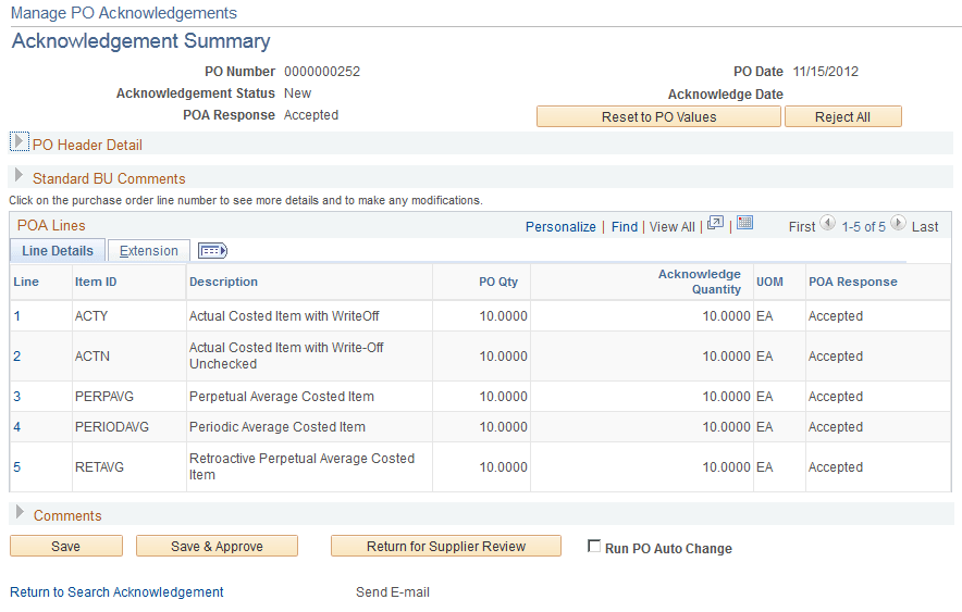

Use the Manage PO Acknowledgements - Acknowledgement Summary page (PO_SS_POA_SUMMARY) to view the acknowledgement information for the selected online purchase order.
Navigation:
Purchasing, and then Purchase Orders, and then Acknowledgements, and then Manage PO Acknowledgements
Click a linked purchase order number on the Manage PO Acknowledgements search page.
This example illustrates the fields and controls on the Manage PO Acknowledgements - Acknowledgement Summary page. You can find definitions for the fields and controls later on this page.
The fields on this page essentially duplicate those on the Acknowledge Purchase Orders - Acknowledgement Summary page, although the suppliers always access this page in "create" mode, while your buyers are able to use "create, review, modify, and approve" mode.
In addition, the buyers have the option to immediately create change orders by selecting the Run PO Auto Change check box and then saving and approving the POA.
See Creating Online POAs (Suppliers).
POAs that are created by way of EDX are visible in the summary results but not visible within this collaborative POA page. Clicking a POA that was created from EDX will transfer the buyer to the EDX review pages discussed in the purchasing section.
See PeopleSoft Purchasing: Using Purchase Order Acknowledgements.
Field or Control Description
Reset to PO Values
Click this button to revert the POA to the values submitted on the original purchase order.
Save
Click this button to save any changes; acknowledgement status remains as Supplier Responded or Buyer Accepted.
Save & Approve
Click this button to save any changes and set the acknowledgement status to Buyer Accepted. This enables the POA to be processed by the PeopleSoft Purchasing Load Change Request process. This also marks any worklist entry as worked for the buyer associated to the purchase order, if workflow is enabled.
Return for Supplier Review
Routes the POA back to the supplier. Acknowledgement status is changed to Supplier Review. Buyer can include comments for the supplier, which the supplier can review as part of an iterative review and acknowledgement process on the supply side.
Run PO Auto Change
Select this check box if you want the system to automatically create change orders that are reflected on the POA. Once you select this check box and click the Save & Approve button the system will automatically run the Purchase Order Auto Change process. This process runs the Load Change Requests process and then the Process Change Order process in the background. You should have the PO Business Unit setting to enable auto approval of buyer approved POAs turned on, for this to work successfully. Otherwise the changes will stop in between the two jobs pending another approval step.
