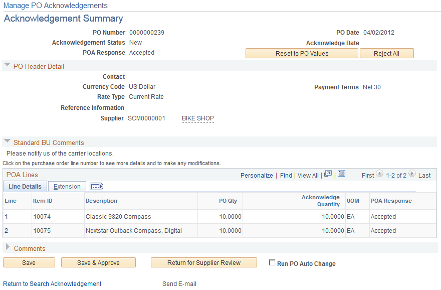

Acknowledge Purchase Orders - Acknowledgement Summary Page
Use the Acknowledge Purchase Orders - Acknowledgement Summary page (PO_SS_POA_SUMMARY) to create new POAs, maintain existing POAs, or view accepted POAs.
Navigation:
  • Click a linked purchase order number value on the Acknowledge Purchase Orders - Search/Filter Acknowledgements page.
  • Click a linked Acknowledge Status value on the Recently Dispatched POs pagelet.
This example illustrates the fields and controls on the Acknowledge Purchase Orders - Acknowledgement Summary page. You can find definitions for the fields and controls later on this page.
The fields on this page essentially duplicate those on the Managing PO Acknowledgements - Acknowledgement Summary page, although the suppliers always access this page in create mode, while buyers can create, review, and approve POAs.
See PeopleSoft Purchasing: Manage PO Acknowledgements - Header Page.
The system displays purchase order or POA history details in view-only fields. The supplier can accept or reject the entire purchase order or the selected line item, or enter changes in the editable fields. In particular:

Line
Click the linked line number to review and modify the details of the line such as quantity or date.
Reset to PO Values
Click this button to restore all POA values to the values specified on the current purchase order, forgoing any changes made on the POA.
PO Header Detail
Click the arrow to expand this section. This section displays the purchase order header details.
Standard BU Comments
Click this arrow to expand this section. This section displays any comments that are associated to the PeopleSoft Purchasing business unit. If there are no business unit level comments, the system doesn't display this section.
PO Header Comments
Click this arrow to expand this section. This section displays any purchase order header comments or attachments associated with the selected purchase order. If there are no header comments or attachments, the system doesn't display this section. If there are multiple rows of header comments/attachments, you can scroll through them or click View All to display all of them.
PO Qty (purchase order quantity)
Displays the sum of all schedule quantities for this line on the purchase order that is being requested.
Acknowledge Quantity
Displays the sum of all schedule acknowledge quantities being replied. The purchase order quantity appears as the default when you first view the purchase order acknowledgement.
Change Order
Click this link for each line that has a change order to access more detail about the change. This shows the details of what changes were made from the last time this purchase order was dispatched. (For example, if this purchase order is on change order 3, it shows the changes made from change order 2 to change order 3.) This link will only appear when viewing a purchase order revision.
Comments
Click this arrow to expand this section. The supplier can enter comments for the buyer, and in subsequent sessions, view any buyer responses.
Save
Click this button to save any changes and have the system set the acknowledgement status to Supplier Review. This will indicate to the system that this POA is in process and still under review.
Save & Send Acknowledgement
Click this button to save any changes and:
  • Change the POA mode for the supplier from editable to view-only.
  • Set the acknowledgement status to Buyer Accepted if there is no change or the changes that are made do not exceed the tolerances specified for the supplier.
  • Sets the acknowledgement status to Supplier Responded if there are changes the buyer needs to approve.
    If workflow is enabled, this also sends notification to the buyer for the POA with changes needing review.
  • Updates the Purchasing EC tables (PO_POA_HDR_HIST, PO_POA_LN_HIST, PO_POA_SHIPHIST) to capture supplier response history and pertinent purchase order values at the time the response is made.
Send Email
Click this link to access the Acknowledge Purchase Orders - Email Message page. Using this page the supplier can send an ad hoc email containing URLs to access the POA directly.

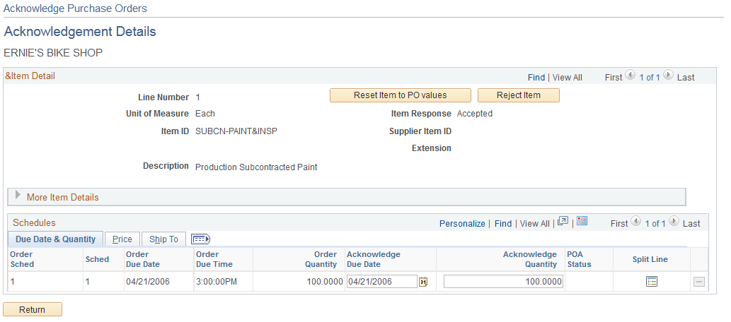

Acknowledge Purchase Orders - Acknowledgement Details Page
Use the Acknowledge Purchase Orders - Acknowledgement Details page (PO_SS_POA) to view POA line details.
Navigation:
Click a line number link on the Acknowledge Purchase Orders - Acknowledgement Summary page.
This example illustrates the fields and controls on the Acknowledge Purchase Orders - Acknowledgement Details page. You can find definitions for the fields and controls later on this page.
Field or Control Description
Change Order
Click the Change Order link to access more detail about changes to schedules. This shows the details of what changes were made from the last time this purchase order was dispatched. For example, if this purchase order is on change order 3, it shows the changes made from change order 2 to change order 3.
Change Order check box
The system displays the check box if there is a change order for this schedule. To view these changes, you must click the Change Order link. This is a visual indicator to help identify which schedules were modified from the last dispatch.
Acknowledge Due Date and Acknowledge Quantity
The system provides these fields as a default to the Purchase Order. Suppliers can modify Due Date, Quantity, and other values for the line/schedule to indicate a change.
Split Line
Click the Split Line icon to split the schedule if the scheduled quantity is to be back-ordered between two or more dates. After clicking the split line button, adjust the quantities between the original and new line and enter a new acknowledge due date for the new schedules quantity.
Comments
Click this button for each schedule that includes Ship To comments or attachments to view the comments on the Ship to Comments page (PO_SS_SHIPCOMM_SP). The comments and attachments are specific to each ship to location, so if all lines and schedules have the same ship to address, all the ship to comments and attachments will be the same.
This button only appears if there are Ship To comments.
