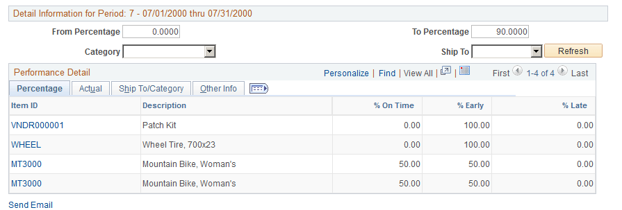

From Percentage/To Percentage displays all items where the on-time, quantity, or quality percentage falls in a specific percentage range. Initially, From Percentage is set to 0, and To Percentage is set to the target percentage for the metric.
If the from and to criteria don't return any data, the system changes the To Percentage to 100, and the system displays the selection again so that at least one row is returned in the grid.
If the from and to criteria return more rows than the Max Rows setting allows, the system displays an error message prompting the user to modify the from and to percentages to reduce the number of returned rows.
Performance Detail
Once you refresh a performance detail page, the system redisplays the page and adds further detail for the selected period. In particular:

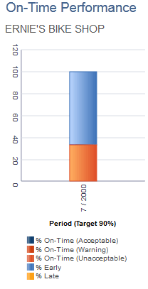

This example illustrates the fields and controls on the Example of the View Supplier Shipment Performance - On-Time Performance page before clicking the Period/Year link. You can find definitions for the fields and controls later on this page.
This example illustrates the fields and controls on the Example of the appended Detail Information section after clicking the Period/Year link. You can find definitions for the fields and controls later on this page.
The system displays on-time performance summary information. This table displays the equations that the system uses to derive this page's metric fields:
Metric Name Equation Used to Derive Metric
% On Time
Depending on the early/late metric display setting that you select, the number of receipts minus early ships minus late ships divided by:
The total number of receipts.
The total receipt quantity.
% Early
Depending on the early/late metric display setting that you select, the early ships divided by:
% Late
Depending on the early/late metric display setting that you select, the late ships divided by:
