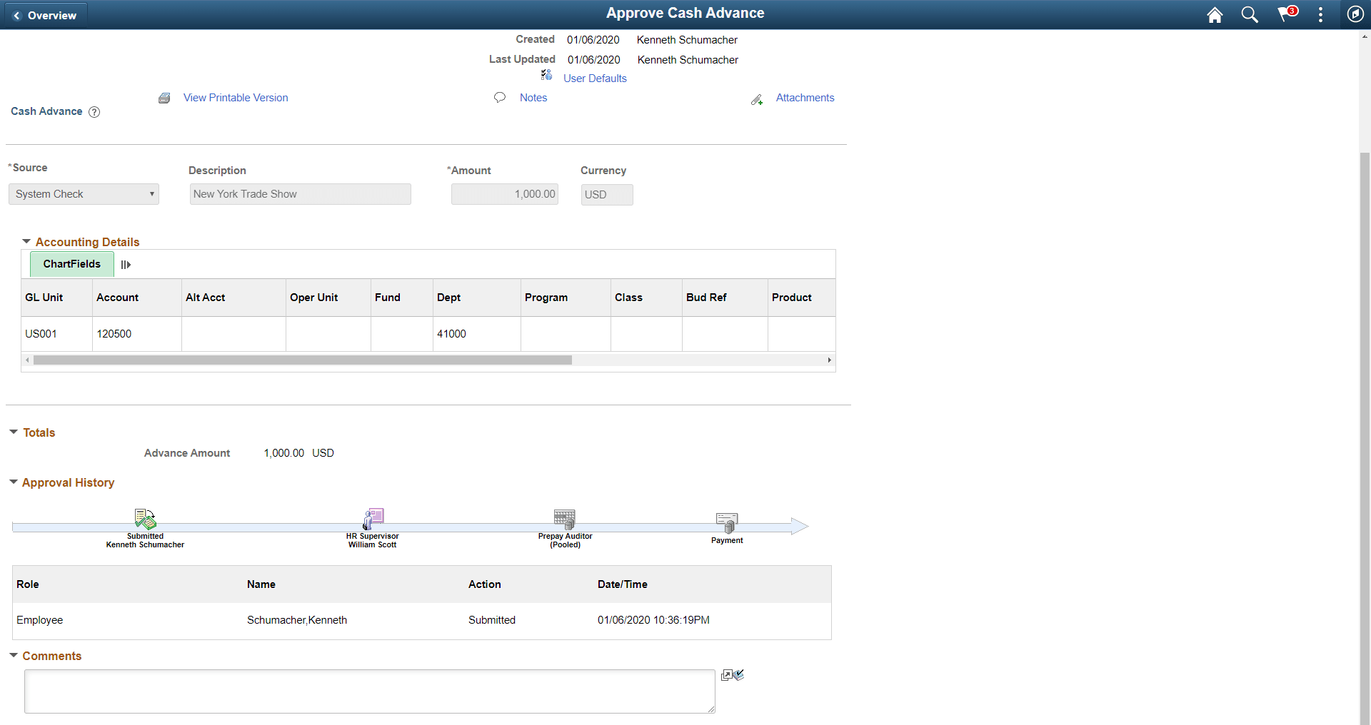

Travel & Expenses - Cash Advance Report - Approve Cash Advance Report Page
Use the Travel & Expenses - Cash Advance Report - Approve Cash Advance Report page (TE_ADVANCE) to approve cash advances.
Navigation:
  • Manager Self-Service, and then Travel And Expense Center, and then Approvals, and then Approve Transactions, and then Cash Advances. Click the Description or Transaction ID link
  • Travel and Expenses, and then Approve Transactions, and then Approve Transactions, and then Cash Advanced. Click the Description or Transaction ID link
This example illustrates the fields and controls on the Approve Cash Advance Report page.
The fields on this page are the same as the fields on the Create Cash Advance Page. Fields that are unique for the approval process are documented in this topic.
