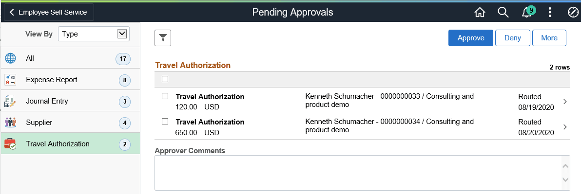

Pending Approvals - Travel Authorization Page (List)
Use the Pending Approvals - Travel Authorization page (EOAWMA_MAIN_FL) (list) to review and approve multiple travel authorizations.
Navigation:
Select the Approvals tile. On the Pending Approvals page, select Travel Authorization in the View By Type pane.
Smartphone: On the Pending Approvals - View By Type page, select Travel Authorization to open a new page that lists the travel authorizations.

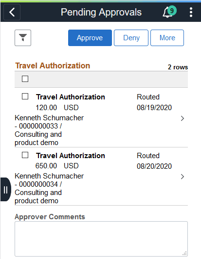

This example illustrates the fields and controls on the Pending Approvals - Travel Authorization page (list).
TA Pending Approvals List
This example illustrates the fields and controls on the Pending Approvals Page (list) for Travel Authorizations.
TA Pending Approvals List SFF
You can set up the system to display which approvals are more urgent than the others using the Application Fundamentals: Installation Options - Urgency (in Days) Page.
Use the filter button to narrow results on the page. For more information about using the filter, see the Application Fundamentals: Filters Page
You can access header details by selecting a row, or you can select one or several travel authorizations and perform a mass action on the selected reports.
Field or Control Description
Approve , Deny, More
Perform a mass action by selecting multiple transactions, and then selecting an approval action button.
Select the More button to display other action buttons such as Sendback (return to submitter) and Hold.
Note: If your organization allows approvers to run the Budget Checking process during Fluid Approvals, then the system displays the Budget Check Page (multi-transaction).
Show or Hide Filters tab
Select this button to expand or collapse the View By Type page.
Exception Comments and Risks icon
Indicates that the system has identified risks and alerts for the travel authorization. The Yellow icon indicates risks and the Red icon indicates alerts.

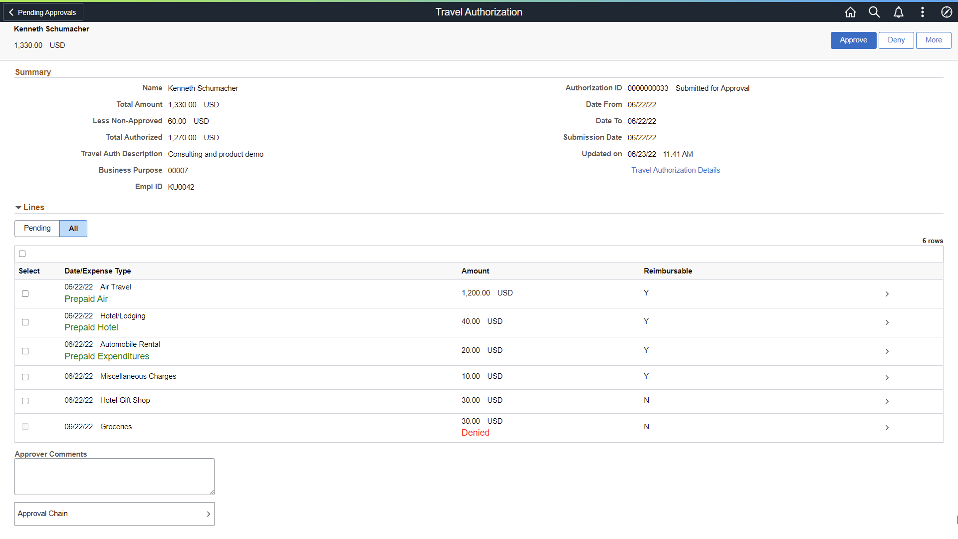

Travel Authorization Page (header approval)
Use the Travel Authorization header approval page (EOAWMA_TXNHDTL_FL) to review and approve a single travel authorization. Access line details for a specific travel authorization.
Navigation:
Select a travel authorization in the list on the Pending Approvals - Travel Authorization list page.
This example illustrates the fields and controls on the Travel Authorization Page (header approval).
Pending Approval - Travel Authorization (header approval)
When viewing a travel authorization on a smartphone, you must scroll down to view the line information, approver comments, and approval chain.
The approval chain reflects the approval status generated by the Application Workflow Engine (AWE). For more information about using AWE workflows, see Approval Framework: Approval Framework Overview.
View Attachments
Select to view attachments associated with the travel authorization. If there are no attachments associated to the report, this link is hidden.
View Notes
Select to view notes associated with the travel authorization. If there are no notes associated to the report, this link is hidden.
Lines
Select a line to review additional details about the travel authorization line. Select the check box for one or more lines to approve or deny a travel authorization line.
Pending/All
Select the Pending tab to view expense lines that have not been approved or denies.
Select the All tab to view all lines, which can include Denied, Sent back, or on Hold.
Date/Expense Type
Displays prepaid lines in green text. Prepaid lines cannot be denied individually. However, prepaid lines can be denied if you select all prepaid lines and deny all of them.
Approver Comments
Enter comments in the text entry field.
Approval Chain
Select to review approval chain information. You can expand or collapse approver information for each line by selecting the Expand/Collapse icon. You can also select the approver name to view approver details.
Select an action button.
When you select an action button, you have the option to select Submit to continue the action or Cancel to back out of the action. Upon submitting the action, the system generates a message that the action is successful.
Select the More button to display other action buttons Sendback (Return to Submitter) and Hold.
Note: If your organization allows approvers to run the Budget Checking process during Fluid Approvals, then the system displays the Budget Check Page (header level).

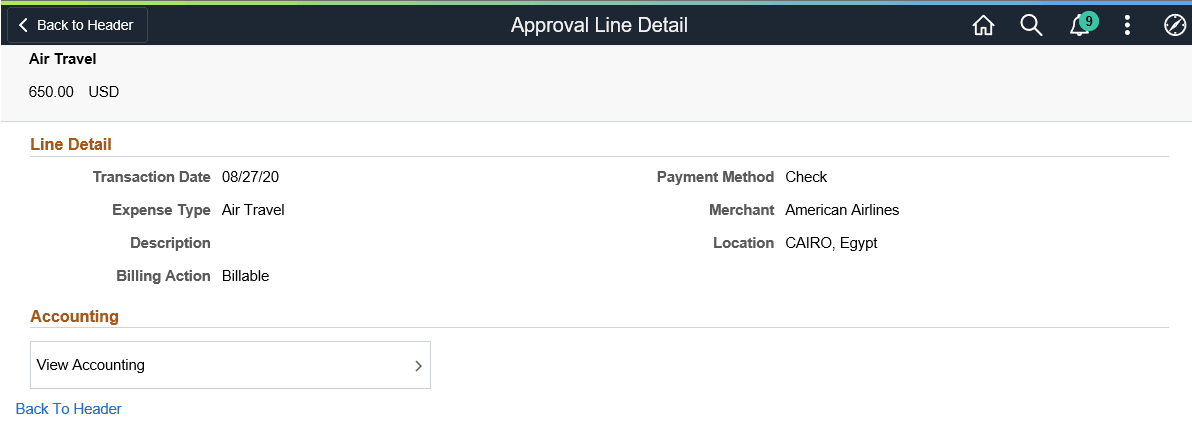

Approval Line Detail Page (travel authorization)
Use the Approval Line Detail page (EOAWMA_TXNLDTL_FL) for a travel authorization to review additional information about the travel authorization line.
Navigation:
Select a travel authorization line in the Lines section on the Travel Authorization header approval page.
This example illustrates the fields and controls on the Approval Line Detail Page (travel authorization).
TA Pending Approvals Line
View Attachments
Select to view attachments associated with the travel authorization. If there are no attachments associated to the report, this link will be hidden.
View Accounting
Select to access the Accounting page and view the Accounting details.
Exceptions and Risks
Select to view the Exception Comments and Risks page.
