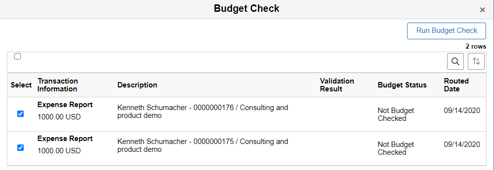

Budget Check Page (multi-transaction)
Use the Budget Check page (EX_BUDPNL_SEC_FL) (multi-transaction) to run the Budget Checking process from the Pending Approvals page.
Navigation:
From the Pending Approvals page, select one or more expense report or travel authorization transaction. Select the Approve button.
This example illustrates the fields and controls on the Budget Check page (multi-transaction).
Budget Check page (multi)
Field or Control Description
Select check box
Select one or more transactions for the budget check process. The system displays the Budget Status so the approver can determine if the Budget Checking process needs to be run on all transactions.
Run Budget Check
Select to run the Budget Checking process for the transaction(s) selected.
Note: The system holds your screen until the budget check process completes or until the maximum wait time is exceeded. If the maximum wait time is exceeded, the system sends the process to the Process Monitor and displays a message with the instance number. The maximum wait time is determined on the PeopleSoft Commitment Control: Installation Options - Commitment Control Page
When the Budget Checking process completes, the Budget Status changes to Valid, Error, or Warning.
X (close)
Select to close the window.
If you have not run the Budget Checking process, the system displays a message reminding you that the transactions must be budget checked prior to approval.
After you have run the Budget Checking process, you can close the modal window and return to the Mass Approve window, which allows you to enter comments and submit.

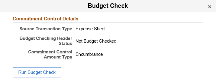

Budget Check Page (header level)
Use the Budget Check page (EX_BUD_HDR_SEC_FL) (header level) to run the Budget Checking process from the transaction header.
Navigation:
From the Pending Approvals page, select an expense report or travel authorization line. From the transaction approval page, select one or more lines and then select the Approve button.
This example illustrates the fields and controls on the Budget Check Page (header level).
Budget Check (header level)
Run Budget Check
Select to run the Budget Checking process for the transaction header.
