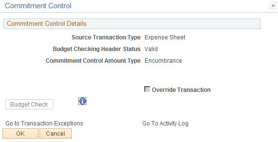

Commitment Control Page
Use the Commitment Control page (KK_EXCPTN_OVER_SEC) to budget check expense transactions online.
Navigation:
  • Click the Budget Options link on the Approve Travel Authorization - Travel Authorization Summary page using the Manager Self-Service navigation
  • Click the Budget Options link on the Approve Expense Report - Expense Report Summary page using the Manager Self-Service navigation.
  • Click the Budget Options link on the Approve Travel Authorization - Travel Authorization Summary page using the Travel and Expenses navigation.
  • Click the Budget Options link on the Approve Expense Report - Expense Report Summary page using the Travel and Expenses navigation.
This example illustrates the fields and controls on the Commitment Control page. You can find definitions for the fields and controls later on this page.
Use this page to check the travel authorization amount against commitment control budgets and record the amount as an encumbrance.
Commitment Control Details
Field or Control Description
Source Transaction Type
Displays the transaction as a travel authorization or an expense sheet.
Budget Checking Header
Indicates the current budget checking status.
Commitment Control Amount Type
Identifies this as an encumbrance transaction.
Commitment Control Tran ID (commitment control transaction identification)
Activity log transaction number for the commitment control transaction.
Override Transaction
Select to enable the entire transaction to update the control budget, even if error exceptions exist.
Budget Check
Click to run the Budget Processor for this transaction.
Go To Transaction Exceptions
Click to access the page where you can view budget checking errors or warning messages for travel authorization transactions. Users who have authority can override the budget exceptions on this page.
Go to Activity Log
Click to access the Commitment Control Activity Log page, where you can view activity for all lines in a transaction that updated the control budget.

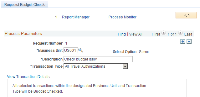

Request Budget Check Page
Use the Request Budget Check page (EX_BGTCHK_REQUEST1) to run the budget checking process for travel authorizations, expense reports, and journal expense reports. The Process Scheduler process runs the Commitment Control Budget Processor at user-defined intervals.
Navigation:
Travel and Expenses, and then Manage Accounting, and then Request Budget Checking
This example illustrates the fields and controls on the Request Budget Check page. You can find definitions for the fields and controls later on this page.
WARNING:
Use different run control IDs for the budget checking processes such as budget check request, cancel travel authorization, and rollover travel authorizations. You must use a unique run control ID for each of these processes.
Bus Unit (business unit)
Select a business unit.
Description
Enter a description about the run control.
Transaction Type
Select a Commitment Control transaction type. Options include:
  • All Expense Reports: Budget check all non-closed expense reports.
  • All Travel Authorizations: Budget check all travel authorizations.
  • Cancel Void Expense Reports: Budget check voided expense reports (the payment is voided and not reissued).
  • Encumbrance Relief Accruals: Budget check encumbrance relief entries. The encumbrance relief entry for accruals reduces the encumbrance budget if the document has been created from a predecessor document that has been encumbered.
  • Period End Accruals Expense: Budget check a liability that is booked in one period and reversed in the following period. This is also called a month-end accrual versus a perpetual accrual, in which the accrual and reversal are created in the same accounting period.
View Transaction List
Click to access the Transaction Details page to select parameters and transactions to budget check.

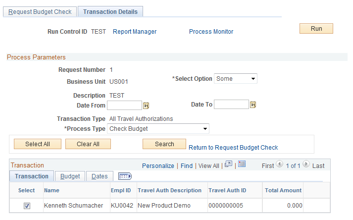

Transaction Details Page
Use the Transaction Details page (EX_BGTCHK_REQUEST2) to select a date range or specific expense transactions to be budget checked.
Navigation:
Click the View Transaction Details link on the Request Budget Check page.
This example illustrates the fields and controls on the Transaction Details page. You can find definitions for the fields and controls later on this page.
Use the Date From and Date To fields to search for transactions that are eligible for budget checking. To enter date criteria, select Some in the Select Option drop-down list box. If you do not enter date criteria, all eligible transactions of the selected transaction type appear in the grid. You can then select some or all of the transactions to budget check. The Transactions, Budget, and Dates tabs display different information related to the expense transactions listed in the grid.
WARNING:
Do not run the payment staging process concurrently with the budget checking process to ensure that the system does not select the same transaction for both processes.
