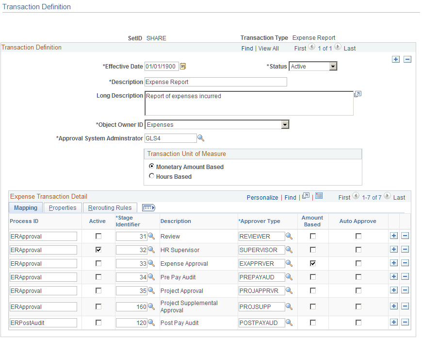

Transaction Definition Page
Use the Transaction Definition page (EX_TRANS_DEFN) to map approver types to the stage in approval framework for expense transaction approval routing and notifications.

This example illustrates the fields and controls on the Transaction Definition page.
Field or Control Description
Effective Date
Enter an effective date for the transaction type definition. The system compares the last submitted date of the transactions to the effective-dated transaction definitions to select the appropriate configuration for approval processing.
Status
Select Active or Inactive to turn approvals on or off for all approvers of this transaction type. When all effective dated rows for the transaction definition component for a specific transaction type is set to a status of Inactive, all transactions associated with that transaction type are automatically approved, and the approval routing for the transaction type is bypassed.
Object Owner ID
Select the product that is associated with this transaction.
Approval System Administrator
Select a person to receive notifications for transactions that fail the normal approval routing process.
Routing failure occurs if an approver is not properly defined and there is no other business defaulting rule in place. The Approval System Administrator can use the reassign functionality to route these transactions to the appropriate approvers.
Transaction Unit of Measure
Select whether the transaction type is a monetary amount based transaction, such as travel authorizations, cash advances, and expense reports or is a hours based transaction, such as time reports and time report adjustments.
Mapping Tab
Page elements on the Mapping tab enable you to map defined approver types to preconfigured approval stages and process definitions in approval framework.
Process ID
Indicates the approval engine stage that is mapped.
Active
Select to enable the transaction type for approval by the approver type. If not selected, the approver type is not authorized to review or approve that transaction type.
Stage Identifier
Indicates the approval framework approval engine stage key identifier.
Approver Type
Indicates the approver type, such as a reviewer, supervisor, and prepayment auditor.
Note: This field applies only to expense reports.
Amount Based
Select to enable the approval process to use amount-based routing rules. Amount-based routing rules does not apply for hours-based transactions such as time reports and time adjustments. It also does not apply to the Supervisor or Project Manager approver types, and PeopleSoft Expenses ignores the check boxes if you select them. If you select for other approver types, an approver list must exist that contains the amount rules by routing ChartField.
Auto Approve
Select to enable automatic approvals for travel authorizations, cash advances, and expense reports. To automatically approve transactions, you define a monetary amount threshold and a percent variance from travel authorizations in the Auto Approve Threshold group box on the Expenses Definition – Business Unit 2 page.
This check box cannot be changed when the approver category that is related to the approve type is Receipt Verifier
Note: If you use PeopleSoft Commitment Control and you enable the option to require budget checking of transactions prior to approval, PeopleSoft Expenses does not automatically approve expense transactions that do not have a valid budget checking status.
