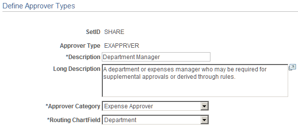

Use the Define Approver Types page (EX_APPRVR_TYPE) to define new and modify existing approver types.

This example illustrates the fields and controls on the Define Approver Types page. You can find definitions for the fields and controls later on this page.

Approver Type
An approver type represents an approval role. You can change the descriptions of the approver types to match titles or roles in your organization. PeopleSoft Expenses delivers these approver types:
  • EXAPPROVER: A department or expenses manager who may be required for supplemental approvals that you define through rules.
  • POSTPAYAUD: Post payment auditors can take action on expense transactions that have completed the processing cycle. Certain combinations of transactions and approval actions are not allowed for this role.
    Note: Email approvals is not supported for this approver type.
  • PREPAYAUD: This approver type supports an auditor process prior to payment processing for review and approval. You can configure this role to allow changes to approved transactions.
  • PROJAPPRVR: The person designated for project time and expense approvals can be the project manager as defined in PeopleSoft Project Costing, or the HR Supervisor as an option in PeopleSoft Expenses.
  • PROJSUPP: This approver type is a supplemental or conditional approver for expense transactions relating to projects. The system currently only routes by project ChartField.
  • RCPTVERIF: This approver type supports the person who verifies receipt details for expense report transactions that exceed the minimum amount designated on the Receipts Required Page. You should select Receipt Verifier in the Approver Category field.
  • REVIEWER: Department reviewer can screen expense transactions for policy compliance prior to the approval process. When you use this approver type, PeopleSoft Expenses does not process approvals until a reviewer has reviewed the transactions.
  • SUPERVISOR: This role is the supervisor to whom the employee, contractor, or consultant directly reports to, as defined in your HR system. It is the type associated with the HR Supervisor setting on the Installation Options – Expenses page.
