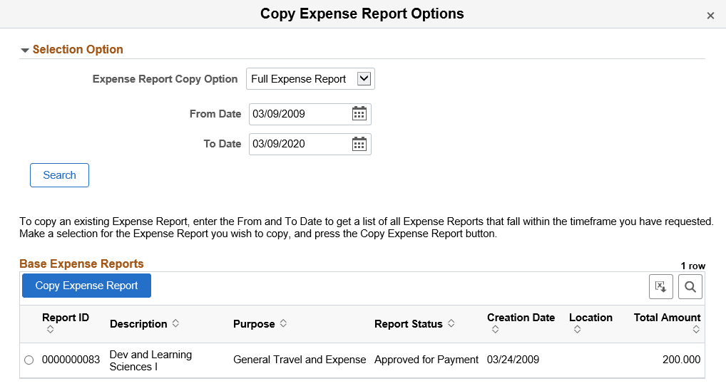

Use the Copy Expense Report Options page (EX_TE_COPY_SH_SCF) to copy an expense report using PeopleSoft Fluid.
Navigation:
Expenses tile, and then Create Expense Report tile. Select Copy Expense Report in the Expense Report Action field.
This example illustrates the fields and controls on the Copy Expense Report Options page.
Selection Option
This section expands and the Base Expense Reports section is not displayed when you initially access the page. After you select the Search button, this section collapses and the Base Expense Reports section appears.

Full Expense Report
When the Expense Report Copy Option is Full Expense Report:
  1. Enter a date range in the From and To Date fields.
  2. Select the Search button, which displays a section titled Base Expense Reports.
  3. Select an expense report in the grid.
    Only one expense report can be selected.
  4. Select the Copy Expense Report button.
    The system takes you to the Expense Report Page.
  5. Select the Update Details button to modify the copied expense report.
