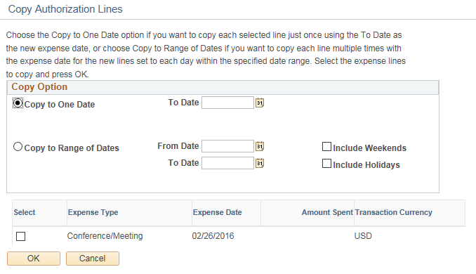

Create Travel Authorization - Copy Selected Expenses Page
Use the Create Travel Authorization - Copy Selected Expenses page (TE_COPY_TALN1_SEC) to copy selected expense lines on a travel authorization.

This example illustrates the fields and controls on the Create Travel Authorization - Copy Selected Expenses page. You can find definitions for the fields and controls later on this page.
Field or Control Description
Copy to One Date
Select to copy each selected line only once using the value in the To Date field as the new expense date.
Copy to Range of Dates
Select to copy each line multiple times with the expense date for the new lines set to each day within the specified date range.
From Date and To Date
Enter a date or a date range for PeopleSoft Expenses to calculate the number of rows to create.
Include Weekends and Include Holidays
Select to have PeopleSoft Expenses copy the expense type for the entire date range.
If you do not select to include weekends, PeopleSoft Expenses checks the day of the week and does not copy expense lines for Saturdays or Sundays.
If you do not select to include holidays, PeopleSoft Expenses checks the holiday calendar for the employee's business unit. PeopleSoft Expenses does not copy expense lines for days that the calendar designates as holidays.
