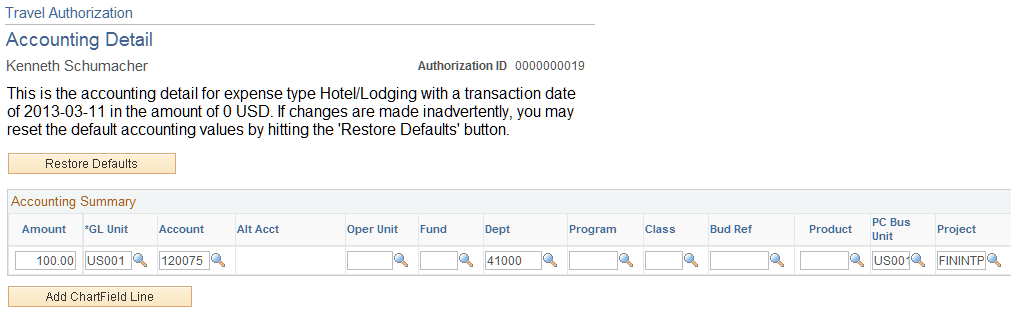

Create Travel Authorization - Accounting Detail Page
Use the Create Travel Authorization - Accounting Detail page (TE_TAUTH_DIST) to view or change accounting details or ChartField allocations for the expense type.
Navigation:
Travel and Expenses, and then Travel and Expense Center, and then Travel Authorization, and then [Create or Modify]. Click the Accounting Details link on the Travel Authorization - Add Expense - [expense type] page.
This example illustrates the fields and controls on the Create Travel Authorization - Accounting Detail page (partial page). You can find definitions for the fields and controls later on this page.
If you are using employee privilege templates, access to this page is dependant on the value in the Distributions field, and access to these fields is dependant on the value in the GL ChartFields and PC ChartFields fields for the travel authorization transaction.
For more information about employee privilege templates:
See Maintaining Employee Privilege Templates.
If you can modify this page, you can override the default accounting for an expense type in a travel authorization.
Field or Control Description
Restore Defaults
Click to reset default accounting values.
Add ChartField Line
Click to add new accounting detail lines.
