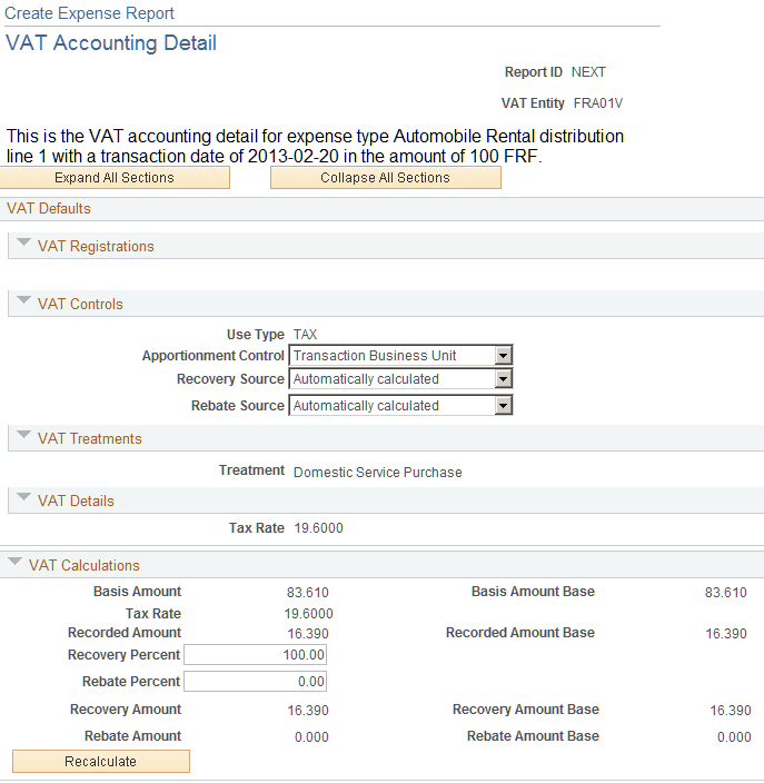

Create Expense Report - VAT Accounting Detail Page
Use the Create Expense Report - VAT Accounting Detail page (TE_SHEET_ACCTG_VAT) to view or change VAT accounting details.
Navigation:
From the Create (or Modify) Expense Report page, expand the Accounting Details section. Select the VAT Info tab, and then click the VAT Detail icon.
This example illustrates the fields and controls on the Create Expense Report - VAT Accounting Detail page.
VAT Defaults - VAT Controls
Field or Control Description
Use Type
Displays the value from the VAT Information for Expense [type] page. You cannot modify this field.
Apportionment Control
Displays the default value from the PeopleSoft Expenses business unit VAT driver within the VAT defaults table. Select the option to use when searching for VAT apportionment information. Values are:
  • Dist GL BU (distribution general ledger business unit): Select for the system to use the general ledger business unit on the distribution line to search for the taxable and exempt percentages.
  • Txn BU (transaction business unit): Select for the system to use the expenses business unit associated with the employee to search for the taxable and exempt percentages.
  • Txn GL BU (transaction general ledger business unit): Because PeopleSoft Expenses uses the general ledger business unit, this option has the same behavior as Txn BU.
Recovery Source
Select one of the following options:
  • Automatic: Select for the system to calculate what percentages to use. This is the initial default value.
  • Manual: Select if you want to override the percentage calculated by the system. You can enter the percentage of VAT entered that is recoverable.
Rebate Source
Select one of the following values:
  • Automatic: Select for the system to calculate what percentage to use. This is the initial default value.
  • Manual: Select if you want to override the percentage calculated by the system. When you do, you can enter the percentage that is used to calculate the rebate.
Note: The availability of the Recovery and Rebate Source fields is dependent on the Allow Override Recovery/Rebate check box that you set on the expenses business unit VAT driver in the VAT Defaults table. For Automatic, the system-calculated percentages are based on the VAT use type or VAT apportionment for the ChartFields on the distribution line.
Reclaim Percent
When the expense line has a foreign VAT treatment, you can specify a VAT reclaim percent. VAT recovery and VAT rebate are not available for foreign VAT treatments, and you cannot modify those fields.
VAT Treatments
This section displays the VAT treatment, which is provided by default from the VAT Information For Expense [type] page.
VAT Calculations
Basis Amount
Displays the amount on which the VAT is calculated in the employee business unit's base currency.
Basis Amount Base
Displays the amount on which the VAT is calculated in the base currency for the business unit entered in the distribution line.
Tax Rate
Displays the applicable VAT percentage.
Recorded Amount
Displays the amount of VAT that will be recorded for this transaction in the employee business unit's base currency. If the calculated VAT amount has been overridden, this will be the entered override; otherwise, this amount will be the calculated VAT amount.
Recorded Amount Base
Displays the amount of VAT that will be recorded for this transaction in the base currency for the business unit entered in the distribution line. If the calculated VAT amount has been overridden, this amount will be the entered override VAT amount; otherwise, it will be the calculated VAT amount.
Recovery Percent
Indicates the rate used to recover domestic VAT.
Rebate Percent
Indicates the rate used to calculate the rebate amount.
Recovery Amount
VAT recovery amount calculated by the system based on the VAT recovery percentage.
Recovery Amount Base
VAT recovery amount in the base currency for the business unit entered in the distribution line.
Rebate Amount
The calculated rebate amount expressed in the employee business unit's base currency.
Rebate Amount Base
The calculated rebate amount expressed in the base currency for the business unit entered in the distribution line.
Reclaim Amount
The calculated reclaim amount expressed in the employee business unit's base currency.
Reclaim Amount Base
The calculated reclaim amount expressed in the base currency for the business unit entered in the distribution line.
Recalculate
Click to recalculate the recovery, rebate, and reclaim amounts.
