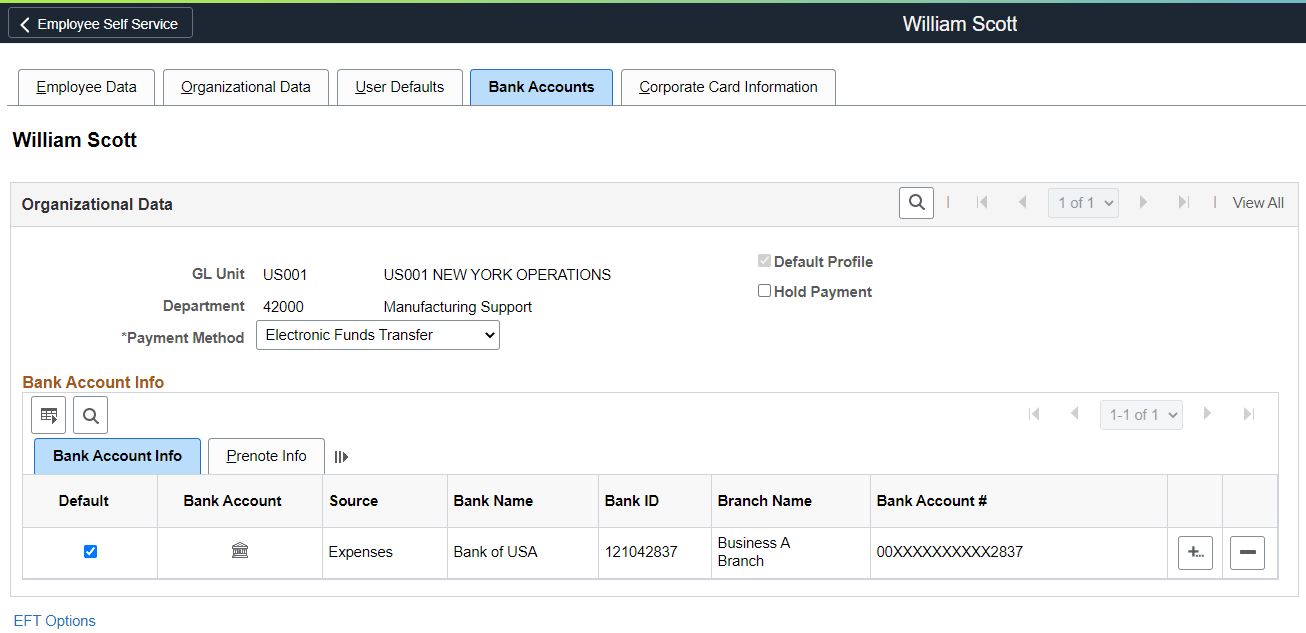

Employee Profile - Bank Accounts Page
Use the Employee Profile - Bank Accounts page (EX_EE_PYMNT_DTL) to view or modify employee bank account information.
If you use the Employee Self-Service navigation, you can only view information. If you use the Travel and PeopleSoft Expenses navigation, you can view or modify information.
Navigation:
  • Employee Self-Service, and then Travel and Expenses, and then Review/Edit Profile
  • Travel and Expenses, and then Manage Employee Information, and then Update Employee Detail
This example illustrates the fields and controls on the Employee Profile - Bank Accounts page.
Organizational Data
Field or Control Description
Default Profile
When selected, indicates if this profile is the employee's default profile.
See Maintaining Employee Organizational Data.
Payment Method
Select a payment method. Options are:
  • Automated Clearing House: Send all expense payments to a central location for distribution to individual employee bank accounts. If you select this payment method, select a default bank account for reimbursement deposits.
  • Default from Distribution Bank: Payment comes from the distribution bank that is defined for the employee's general ledger business unit.
  • Electronic Funds Transfer: Reimbursement is by direct deposit to the employee's bank account. If you select this payment method, select a default bank account for reimbursement deposits.
    If required by the employee's country, enter additional information on the EFT Payment Options page.
  • Giro - EFT: Reimbursement is by EFT. Only Singapore supports this form of EFT.
  • System Check: Reimbursement is in the form of a paper check. This is the default payment method.
Note: PeopleSoft Expenses enables the Payment Method field only when you use the Travel and Expenses navigation.
Hold Payment
If selected, reimbursement will not occur during a pay cycle until you remove the hold. For example, you can choose to withhold payment until an employee clears outstanding advances.
Note: PeopleSoft Expenses enables the Hold Payment field only when you use the Travel and Expenses navigation.
Bank Account Info (bank account information) Tab
Default
Select to indicate the default bank account for expense reimbursement if more than one bank appears in an employee profile and if the payment method is Automated Clearing House or Electronic Funds.
Bank Account
Click the Bank Account icon to access the Pay to Bank Accounts page, where you can identify a bank for the deposit of expense reimbursement funds.
Source
Indicates the source of the bank account information. Options are Expenses or Payroll.
Bank Name, Bank ID, IBAN, (international bank account number) Branch Name, and Branch ID
Displays information about the selected bank.
Bank Account # (bank account number)
Displays the bank account number.
If you are using the Bank Account Number Encryption feature, then this value is encrypted and masked. See Application Fundamentals: Understanding Bank Account Encryption.
See Pay to Bank Accounts Page.
Prenote Info (prenote information) Tab
Prenote is a test run performed by an organization to verify payment information, electronic funds transfer (EFT) or automated clearing house (ACH), before sending an actual payment or payment advice. If you select Electronic Funds Transfer as the payment method for an employee, use this tab to change the status of the bank account. ACH prenote is allowed for both expense and cash advance payments. When expenses and cash advance payments are sent to the pay cycle with prenote enabled in PeopleSoft Payables, pay cycle processes the prenote and updates the prenote status in PeopleSoft Expenses.
Prenote Status
Indicates the status of the test:
  • Confirmed: Prenote was sent, and the bank verified the EFT or ACH information.
  • New: Bank account is created, but prenotification has not occurred.
  • Pending: Awaiting confirmation on a prenote that was sent.
  • Rejected: Prenote was sent, but bank rejected it.
  • Submitted: Prenote was sent, and bank acknowledged it.
Required
Select to indicate if a prenote is required.
Prenotification Date
Indicates the date that the prenote was sent to the bank.
Wait Days
Enter the number of days from the prenotification date to wait before marking the prenote status Confirmed.
EFT Options
Click to open the Employee EFT Options page and specify information for employees who live in certain countries. Use only if the payment method for expense reimbursement is Electronic Funds Transfer.

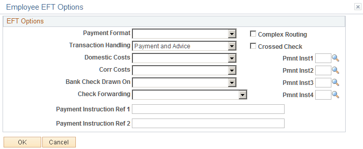

Employee EFT Options Page
Use the Employee EFT Options page (EX_EFT_OPT_SEC) to if the selected payment method for expense reimbursement is EFT, use the Employee EFT Options page to enter additional information for employees who live in certain countries.
Navigation:
  • Employee Self-Service, and then Travel and Expenses, and then Review/Edit Profile. Click the EFT Options link on the Employee Profile - Bank Accounts page.
  • Travel and Expenses, and then Manage Employee Information, and then Update Employee Detail. Click the EFT Options link on the Employee Profile - Bank Accounts page.
This example illustrates the fields and controls on the Employee EFT Options page. You can find definitions for the fields and controls later on this page.
Payment Format
Select a format for the employee's EFT option.
PeopleSoft Payables is preloaded with payment formats, such as Check Std, Pay & Dep, or Wire. Create your own payment formats, or modify existing ones with EFT Payment Format Codes.
See PeopleSoft Banks Setup and Processing: Defining EFT Payment Format Codes.
Transaction Handling
Determines which parts of the payment to include in the EFT file that is sent to the employee's bank. Select one:
  • Pay+Advice (payment plus advice): Transmit both the actual payment and the advice.
  • Prenote: Transmit a test run to verify all EFT before sending out an actual payment and advice.
  • Pymnt Only(payment only): Transmit only the payment with the EFT file.
Domestic Costs and Corr Costs (correspondent costs)
Depending on the country in which an EFT occurs, costs may be involved in executing such transactions, especially with a transfer between two countries.
Domestic Costs indicates who pays for the bank costs of the EFT. Banks assess correspondent costs if third parties are involved. When there are domestic costs or correspondent costs with an EFT transaction, select a source of payment. Options are:
  • Payee Acct (payee account): Charge the employee's account.
  • Payr/Payee (payer and payee): Charge the employee and the employer equally. This choice applies only to Domestic Costs.
  • Pyr D Acct (payer domestic account): Assess the costs to the employer's domestic account.
  • Pyr F Acct (payer foreign account): Charge the employer's foreign account.
Bank Check Drawn On
Specify that a check comes from (none), Payee Bank, or Payer Bank to generate a check for an employee's EFT transactions.
Check Forwarding
Indicate that the check goes to (none), Payee, Payee Bank, Payer, or Pyr Bank (payer bank) to forward a check.
Payment Instruction Ref 1-2
Provide any other comments regarding EFT transactions.
Complex Routing
Select to indicate that the EFT is routed to the employee's bank through an intermediate party, whose routing information you provide when you define the account.
Crossed Check
Select to indicate that the EFT involves a check that cannot be signed over to a third party.
Pmnt Inst 1-4 (payment instruction 1-4)
Add further payment instructions for this employee's funds transfers. These fields contain standard EFT instruction codes that come delivered with your system.
