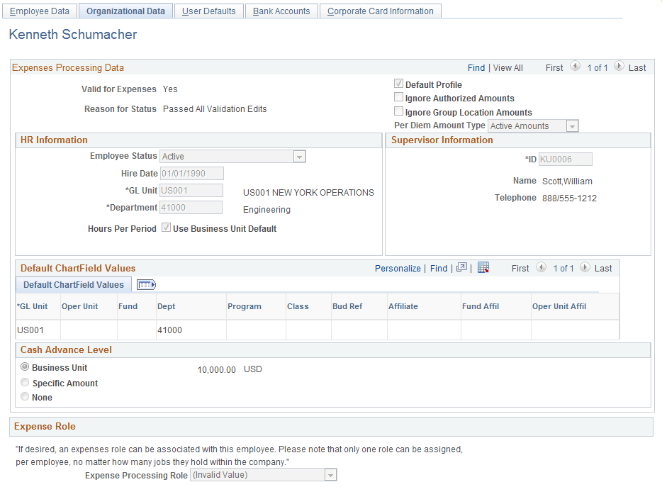

This example illustrates the fields and controls on the Update Profile – Organizational Data page. .
Update Profile - Organizational Data page
Use this page to assign a business unit to an employee, which determines the accounts to charge, allowable mileage rates, and cash advance limits.
You can add or edit an employee's organizational data information on this page; however, updates from human resources may overwrite the changes.
Expenses Processing Data

The ChartFields defined in the employee's profile are used to populate the expense accounting distribution. For example, you can define defaults for the employee's business unit and other ChartFields that make up the employee's cost center in the employee profile, but define the Account ChartField default in the Expense Type or Expense Group. The combination of these ChartFields becomes the accounting distribution used to identify the appropriate cost center(s) for the employee's expenses. Project ChartField defaults can be used if an employee routinely works on one or more projects and allows you to define specific activity codes for each project. You can set up Project ChartField defaults separately between expense reports and time reports. This enables you to track time and expenses at different levels of the project if you use PeopleSoft Project Costing.
Billing type and payment type may default from the employee's profile but if you define defaults for these fields in the expense type they will supersede the defaults from the employee profile.
