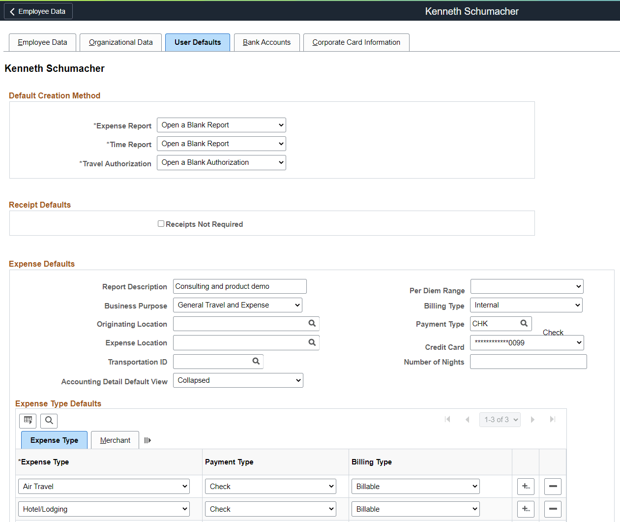

This example illustrates the fields and controls on the Employee Profile - User Defaults page (1 of 2).
User Defaults (1 of 2)

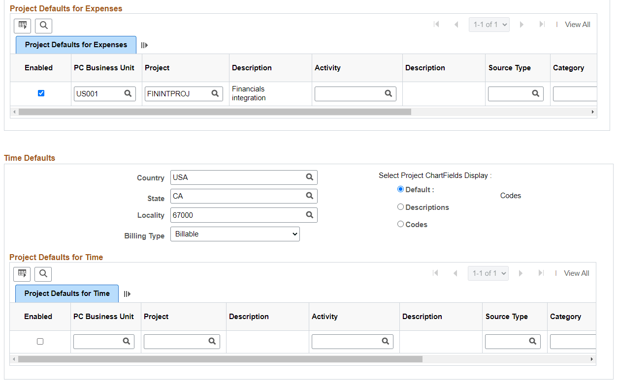

This example illustrates the fields and controls on the Employee Profile - User Defaults page (2 of 2).
User Defaults (2 of 2)
Default Creation Method: Online
Field or Control Description
Expense Report
Set up a default method to create an expense report. You can override the default on the expense report page.
Note: The Default Creation Method setting applies only for Classic User Interface, and not for Fluid User Interface. On a Fluid User Interface, a blank report opens directly when you create a new expense report.
Select one of the following methods to use as a default to create new expense reports:
  • Copy From a Template: PeopleSoft Expenses will display the Create Expense Report - Select a Template page where you can select a template to use or select the expense types and date to include in the expense report.
  • Copy From a Travel Auth.: PeopleSoft Expenses will display the Create Expense Report - Populate From a Travel Authorization page where you can select a travel authorization to copy from.
  • Copy an Existing Report: PeopleSoft Expenses will display the Create Expense Report - Copy From an Existing Expense Report page where you can select an expense report to copy.
  • Open a Blank Report: PeopleSoft Expenses will display the Create Expense Report page.

Default Creation Method: Mobile - Laptop
Expense Report
Open a blank Report is the only default option available for Mobile expense report.

Receipt Defaults
Receipts Not Required
Select to indicate that this user is not required to attach receipts to expense reports. This value overrides the Enforce Receipt option entered on the Receipts Required Page for the General Ledger business unit.
Note: Only system administrators have access to this field. Individual employees cannot access this field.
Expense Defaults
Report Description
Enter a description that you want to appear by default onto the header level of your travel authorizations, cash advances, and expense reports.
Per Diem Range
Select a per diem range ID that is associated with a range type of Daily. A per diem that is associated with a range type of Daily, on a project or at a site, requires the number of days to appear by default into the expense report for the employee.
This field only has values if the user is associated with a SetID that uses a daily range type. Ranges are defined on the Per Diem Range page and the amount for the per diem is defined on the Per Diem Amount page.
Business Purpose
Select from a predefined list (created when your organization implemented the PeopleSoft Expenses system). The business purpose that you select appear by default onto the header level of your travel authorizations, cash advances, and expense reports.
Billing Type
Select the billing action that you want to appear by default onto your travel authorizations, expense reports, and time reports.
If you use PeopleSoft Project Costing, billing codes are required to identify project costs that are both billable and charged to project costing ChartFields. PeopleSoft Expenses passes these items to PeopleSoft Billing for processing.
Originating Location
Select a city, country, or geographical area (established by your organization during system setup) that you want to appear by default onto your travel authorizations and expense reports.
Expense Location
Select a city, country, or geographical area where you will incur expenses that you want to appear by default onto your travel authorizations and expense reports.
Payment Type
Select how you pay for expenses and enable the payment type to appear by default onto your travel authorizations and expense reports.
Note: A payment type must be selected if you are creating a Travel Authorization using PeopleSoft Fluid. For more information, see Creating Travel Authorizations Using PeopleSoft Fluid
Credit Card
Select a credit card number that you want PeopleSoft Expenses to use as a default for expense transactions with a method that may directly reimburse the vendor. For security reasons, all but the last four numbers for each credit card will be masked. The credit card information for the employee is maintained on the Employee Profile - Corporate Card Information page.
Transportation ID and Transportation Type
The system displays the employee's active transportation IDs from which to choose. Select a transportation ID that you want to appear by default onto your travel authorizations and expense reports.
Number of Nights
Enter the number of nights that you want to appear by default onto your travel authorizations and expense reports for the expense type Hotel/Lodging.
Accounting Detail Default View
Select Collapsed or Expanded to indicate how the Accounting Detail section should appear on the expense report when the expense type is selected.
Expense Type Defaults - Expense Type Tab
Expense Type
Select an expense type. When you select the expense type on your travel authorizations and expense reports, PeopleSoft Expenses will populate the payment type, billing action, and merchant information.
Payment Type
Select how you pay for the expense type. When you select the expense type on your travel authorizations and expense reports, PeopleSoft Expenses will populate the Payment Type field with this information.
Billing Type
Select the billing action that you want to appear by default onto your travel authorizations and expense reports for the expense type.

Project Defaults for Expenses
Enabled
Select to indicate to the system to include the project as a default on travel authorizations and expense reports.
PC Business Unit
Select a business unit for a project that you want to appear by default onto your travel authorizations and expense reports.
Project and Description
Select a project that you want to appear by default onto your travel authorizations and expense reports.
Activity and Description
Select a project activity that you want to appear by default onto your travel authorizations and expense reports. You create activities in PeopleSoft Project Costing.
Percentage
If the project is enabled, enter a positive, non-zero amount less than or equal to 100. The sum total of all enabled projects must equal 100 percent.
Note: PeopleSoft Expenses does not display this field if PeopleSoft Project Costing is not installed.
Source Type, Category, and Subcategory
If applicable, select for which you want to record time. If you enabled the project default line, PeopleSoft Expenses uses these entries to create the default accounting distribution for travel authorizations and expense reports.
Access to these fields is determined by the value in the PC ChartFields field on the Employee Privilege Template Page for the expense report transaction.
Time Defaults
Country, State, and Locality
Select a country, state, and locality (established by your organization during system setup) that you want to default onto the header of your time reports.
Billing Type
Select the billing action that you want to default onto your time reports.
Select Project ChartFields Display:
Select how you want PeopleSoft Expenses to display PeopleSoft Project Costing ChartFields displayed on your time reports. Options are:
  • Default: Select for PeopleSoft Expenses to use the Project Time Options selection on the Expenses Definition – Business Unit 2 page.
  • Descriptions: Select for PeopleSoft Expenses to display PeopleSoft Project Costing ChartField descriptions on time reports. Selecting this option overrides the Project Time Options selection on the Expenses Definition – Business Unit 2 page.
  • Codes: Select for PeopleSoft Expenses to display PeopleSoft Project Costing codes on time reports. Selecting this option overrides the Project Time Options selection on the Expenses Definition – Business Unit 2 page.
Project Defaults for Time
Enabled
Select to indicate to the system to include the project as a default for time reports.
PC Business Unit
Select a business unit for a project that you want to appear by default onto your time reports.
Select a project that you want to appear by default onto your time reports for which you want to record time.
Select a project activity that you want to appear by default onto your time reports for which you want to record time. You create activities in PeopleSoft Project Costing.
Time Quantity
If the project is enabled, enter the number of hours per day, per project to appear by default onto the time report. You cannot exceed 24 hours on a single enabled row and you cannot exceed 24 hours for an accumulated total of all enabled rows.
If applicable, select for which you want to record time. If you enabled the project default line, PeopleSoft Expenses uses these entries to create the default accounting distribution for time reports.
Access to these fields is determined by the value in the PC ChartFields field on the Employee Privilege Template Page for the time report transaction.
