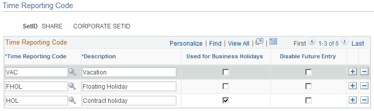

Time Reporting Codes Page
Use the Time Reporting Code page (EX_TRC_MAP_TBL) to enable and disable future entry time reporting.
Navigation:
  • Set Up Financials/Supply Chain, and then Product Related, and then Expenses, and then Mapping, and then Time Reporting Code
  • Travel and Expenses, and then Travel and Exp Admin Center, and then Define Expense System, and then Additional Required Data, and then Maintain Time Reporting Codes
This example illustrates the fields and controls on the Time Reporting Code (EX_TRC_MAP_TBL) page. You can find definitions for the fields and controls later on this page.
The Time Reporting Code (EX_TRC_EX and EX_TRC_MAP_TBL) pages enable you to prohibit reporting future personal time on time reports. Select the Disable Future Entry check box for a time reporting code to prohibit employees from entering personal hours on a time report if the date entered on the report is after the current date.
