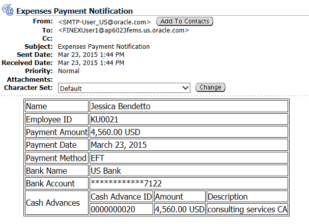

This example illustrates the fields and controls on the Expense Payment Notification. You can find definitions for the fields and controls later on this page.
Expense payment notification
After the Process Scheduler has run successfully, an e-mail notification is sent to the employee. The e-mail notification contains the following information:

Displays the method used to make the payment. PeopleSoft Expenses supports the following payment methods:
  • ACH (Automated Clearing House)
  • EFT (Electronic Funds Transfer)
  • CHK (System check)
Note: When the payment is done using CHK (System check), the fields Bank Name and Bank Account are not displayed in the e-mail notification.
Bank Name
Display the name of the Bank (when the payment is done using ACH (Automated Clearing House) or EFT (Electronic Funds Transfer)).
Bank Account
Display the Bank Account ID (when the payment is done using ACH (Automated Clearing House) or EFT (Electronic Funds Transfer)).
PeopleSoft Expenses masks the account ID so that only the last 4 digits of the bank account ID are displayed.

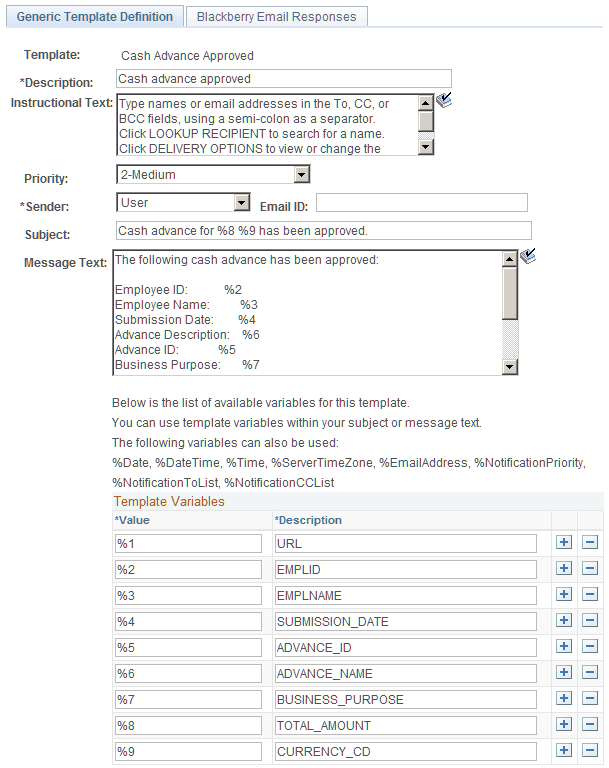

Generic Template Definition Page
Use the Generic Template Definition page (WL_TEMPLATE_GEN) to set up or modify notifications for the approval process under the Approval Framework.
Navigation:
PeopleTools, and then Workflow, and then Notifications, and then Generic Templates
This example illustrates the fields and controls on the Generic Template Definition page (1 of 2). You can find definitions for the fields and controls later on this page.
Use generic templates to establish common formats for ad hoc notifications.
