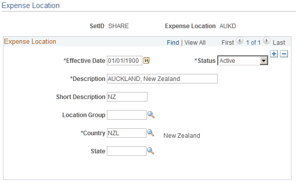

Use the Expense Location page (EX_LOCATION) to create an expense location that is to be used on an expense report.
Navigation:
  • Set Up Financials/Supply Chain, and then Product Related, and then Expenses, and then Location, and then Define Expense Location Codes
  • Travel and Expenses, and then Travel and Exp Admin Center, and then Define Expense System, and then Locations and Rates, and then Expense Location
This example illustrates the fields and controls on the Expense Location page. You can find definitions for the fields and controls later on this page.
Field or Control Description
Location Group
Link the expense location to a predefined expense location group.
Although you are not required to set up State, PeopleSoft Expenses looks at the field to auto-populate the state for VAT processing during expense report entry.

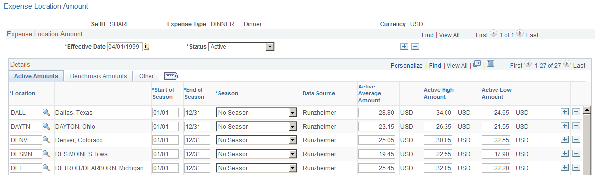

Use the Expense Location Amount page (EX_LOC_AMOUNT) to establish spending limits for business travel in a particular location.
Navigation:
  • Set Up Financials/Supply Chain, and then Product Related, and then Expenses, and then Location, and then Expense Location Amount
  • Travel and Expenses, and then Travel and Exp Admin Center, and then Define Expense System, and then Locations and Rates, and then Expense Location Amount
This example illustrates the fields and controls on the Expense Location Amount page.
Multiple views of this page are available by clicking the tabs that are in the scroll area. Fields that are common to all views are documented first.
All tabs display the following information:
Location
Geographical site (such as a city, state, or office).
Start of Season
Beginning date that is used for locations where rates vary (perhaps due to tourism).
End of Season
Ending date that is used for locations where rates vary (perhaps due to tourism).
Season
Select whether this location amount is In season, Out of season, MidSeas (mid-season), or None.
Data Source
Origin of expense location amounts. This value can be entered manually or loaded from an external source such as Runzheimer or CONUS.
Active Amounts Tab
Active Average Amount
Displays the current mean value for the location amount that is used for online comparison to the amount that is on an expense line.
Active High Amount and Active Low Amount
Displays the current maximum and minimum for the location amount.
Benchmark Amounts Tab
If you loaded benchmark data into your expense tables, the following appears:
Benchmark Average Amount
Displays the mean value of the location amount benchmark. The grid on the right displays the amount's currency.
Benchmark High Amount
Displays the maximum value of the location amount benchmark.
Benchmark Low Amount
Displays the minimum value of the location amount benchmark.
Other Tab
This tab tracks the following update information for audit purposes:
Last Update User ID
Displays the user ID that is used to make the most recent modification to this row.
Last Update Date/Time
Displays the date and time of the most recent modification to this row.
Add rows to designate more expense location amounts.

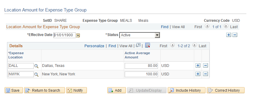

Location Amount for Expense Type Group Page
Use the Location Amount for Expense Type Group page (EX_LOC_AMT_GROUP) to establish authorized spending limits for a particular expense type group in various currencies.
Navigation:
Set Up Financials/Supply Chain, and then Product Related, and then Expenses, and then Location, and then Location Amount for Type Group
This example illustrates the fields and controls on the Location Amount for Expense Type Group page.
The Location Amount for Expense Type Group page enables you configure a location amount to limit spending for a particular expense type group. You can enter an amount limit for a particular location based on the transaction currency.
If you create an expense report and exceed the limit beyond what is specified in the location amount limit for an expense type group, the system requires that you enter exception comments on the expense report
Location
Active Amount Limit
Displays the value entered for the location amount based on the transaction currency.
