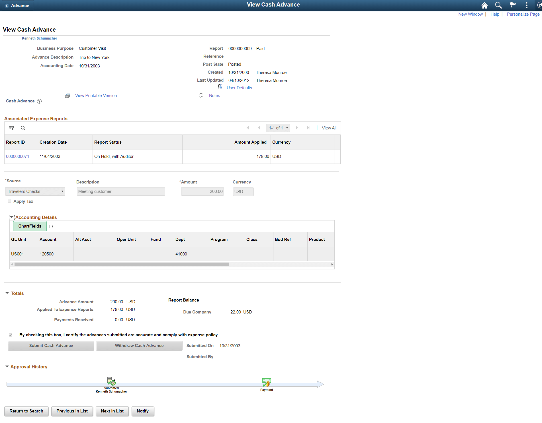

This example illustrates the fields and controls on the View Cash Advance Page. You can find definitions for the fields and controls later on this page.
Fields on this page are the same as the fields on the Create Cash Advance Page. Fields and functionality that are unique to the View Cash Advance Report page are discussed in this topic.

Accounting Date
Displays the accounting date for PeopleSoft Expenses to use to generate new accounting entries in the Post Liabilities Application Engine process for cash advances reconciled through an employee reimbursement.
Post State
Displays whether accounting entries for the cash advance have been posted to the general ledger.

Associated Expense Reports
The Associated Expense Report section helps you identify which Expense Report you can process for Cash Advance reconciliation. The Report ID link redirects you to the View Expense Report page so that you can view the Associated Expense Report.
Accounting Details
Use this section to view accounting details or ChartField allocations for the cash advance.
Totals
Additional fields appear in this section after you save a cash advance.
Field or Control Description
Advance Amount
Displays the total amount of the cash advance request.
Applied to Expense Reports
Displays the total amount of the cash advance that the employee has applied to expense reports.
Payments Received
Displays the total amount of checks the employee has written to offset a balance due the organization.
Withdraw Cash Advance
Click to withdraw the cash advance from the approval process. This option is only available when the report is in a Submitted for Approval status.
