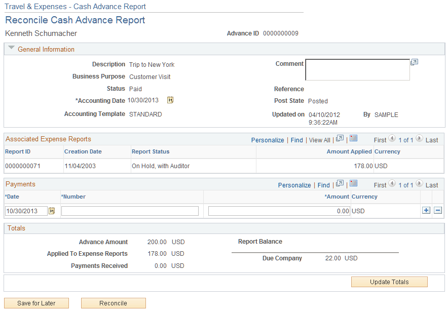

Reconcile Cash Advance Report Page
Use the Reconcile Cash Advance Report page (EX_ADV_RECON) to reconcile a cash advance and compare the cash advance against a submitted expense report to correctly reimburse the employee.

This example illustrates the fields and controls on the Reconcile Cast Advance Report page. You can find definitions for the fields and controls later on this page.

Accounting Date
Select the accounting date for PeopleSoft Expenses to use to generate new accounting entries in the Post Liabilities Application Engine (EX_POST_LIAB) process for cash advances reconciled through an employee reimbursement.
Associated Expense Reports
If the cash advance is associated with an expense report, PeopleSoft Expenses displays the expense report ID, creation date, report status, and amounts. If there is no report ID, you can still reconcile the cash advance. For example, if an employee received a cash advance but did not take the planned business trip or did not use all of the cash advance, the cash advance can be reconciled by the employee writing a check to your organization for the total displayed in the Due Company field.
Payments
Enter check numbers and check amounts when the employee submit checks for unused cash advance funds. PeopleSoft Expenses enables you to enter more than one check payment.
Field or Control Description
Reconcile
Click for PeopleSoft Expenses to validate that the amount applied to expense reports and the total payments received from the employee equals the amount of the cash advance request. If the amount applied to expense reports and total payments received does not equal the cash advance request amount, PeopleSoft Expenses displays an error message. If the amount applied to expense reports and total payments received equals the cash advance request amount, PeopleSoft Expenses sets the cash advance status to Reconciled.
