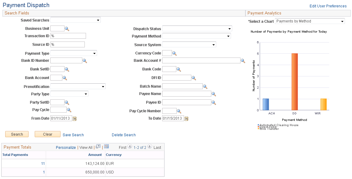

Payment Dispatch Page
Use the Payment Dispatch page (PMT_INQUIRY) to manually send selected payments to a bank from Financial Gateway.
Navigation:
Financial Gateway, and then Process Payments, and then Payment Dispatch
This example illustrates the fields and controls on the Payment Dispatch page (1 of 2). You can find definitions for the fields and controls later on this page.

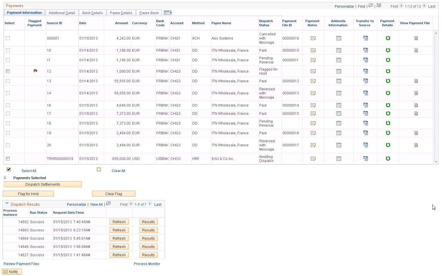

This example illustrates the fields and controls on the Payment Dispatch page (2 of 2). You can find definitions for the fields and controls later on this page.

Search Fields
Use these fields to query the tables in Financial Gateway for specific payment transactions.
Payment Totals
Displays the number of payments and the monetary total for each currency type.
Payments
Field or Control Description
Select
Select the payments to be dispatched or flagged for hold. This field is unavailable for entry for payments that have already been dispatched
Dispatch
Click to send selected payments to the banks.
Flagged for Hold
Click to hold selected payments for further review and approval.
Payments Selected
Displays the number of payment rows that have been selected for dispatching or placing on hold.
Flagged for Clear
Click to remove the hold on selected payments.
Payment Notes icon
Click the Payment Notes icon to access the Payment Notes page, which you use to add and view comments about the specified transaction. Comments added here appear only online within the Financial Gateway system— including the event log—for the particular payment.
Addenda Information icon
Click the Addenda Information icon to access the Addenda page, which you use to add additional instructions for the specified payment. Instructions here will appear within the actual payment file.
Transfer to Source icon
Click the Transfer to Source icon to access the source application to view detailed information about the specified transaction.
Review Payment Details icon
Click the Review Payment Details icon to access the Review Payment Details page to view the payment progress, events, and detailed information on the transaction.
See Review Payment Details Page.
Review Payment File
Click to access the Review Payment Files page to review payment file transmittal information.
See Payment Files Page.
Bank Details Tab
Cutoff Time and Cutoff Date
Payments arriving by this time and date are processed by the bank that day. Payments arriving afterwards are processed on the next business day.
Manually Dispatching a Payment
To manually dispatch a payment:
  1. Select a payment.
  2. Click the Dispatch button.
  3. If prompted, confirm that you are an authorized user by typing your system sign-in password on the Verify Identity page.
The system displays a message stating that the Payment Dispatch Application Engine is scheduled to process the payment. If the process is successful, a payment file is created.
Dispatch Results
This grid provides a view of payment dispatch processes.
Refresh
Click to update the grid and view the results of more recent dispatch processes.
Results
Click to access the Payment Dispatch Results page and view details of a particular payment dispatch.
