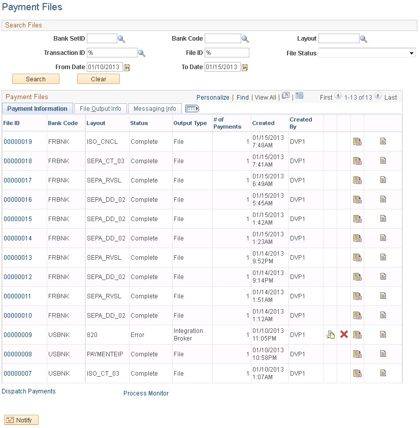

Payment Files Page
Use the Payment Files page (PMT_FILE_DEFN) to review payment file transmittal information.
Navigation:
  • Click the Review Payment Files link on the Payment Dispatch page.
  • Financial Gateway, and then Review Payments, and then Payment Files
This example illustrates the fields and controls on the Payment Files page. You can find definitions for the fields and controls later on this page.
Payment Files page
Enter the search parameters and click Search.
Field or Control Description
File Status
Options are:
  • (None)
  • Complete: Indicates that the payment process is complete.
  • Canceled: Indicates that the settlement is canceled (or voided) by a user. You generally see this status displayed for files with a clerical error, such as an incorrectly entered amount. When you cancel files, the system resets the file's payments back to their original Loaded state on the Dispatch Payments page, where they can again be selected and dispatched.
  • Error: Indicates that the payment dispatch process failed. A red square also appears next to the file name. You can either cancel the payment file or recreate it.
  • In Process: Indicates that the system is still transforming the file.
  • Received: Indicates that the payment file was received by bank.
  • Sent: Indicates that the payment file was sent to bank.
File ID
Click the payment file ID link to access the Payment File Details page, and review all payments that are included in this payment file.
Recreate File icon
Appears only if the payment has an error status. After making the corrections, click the Recreate File icon to recreate the selected payment file.
See Understanding Electronic Banking.
Cancel File icon
Click the Cancel File icon to cancel a selected payment file and reset its payments. This conditional field appears only if the payment has an error status.
View Event Log icon
Click the View Event Log icon to access the Payment File Events page (PMT_FILE_EVENT) and view summary event log information.
Colored icons indicate the transmittal status of the file. A green circle indicates that the file was successfully transmitted; a red square indicates that the file was not successfully transmitted.
View File icon
Click the View File icon to access the Payment File Data page (PMT_FILEDATA_SP), and view payment file data that are transmitted to the bank. The system encrypts stored payment file data. This page cannot be edited.

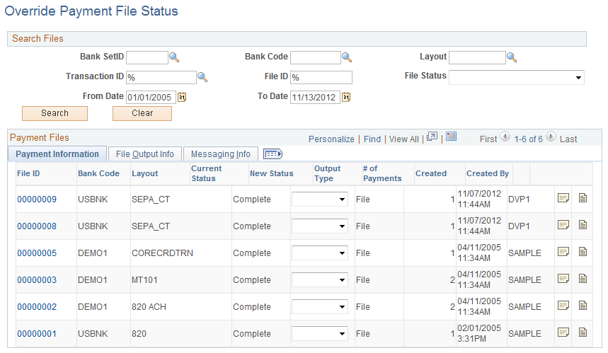

Override Payment File Status Page
Use the Override Payment File Status page (PMT_FILE_DEFN) to change the status of a payment file.
Navigation:
Financial Gateway, and then Administration, and then Override Payment File Status
This example illustrates the fields and controls on the Override Payment File Status page. You can find definitions for the fields and controls later on this page.
Access to this page and the ability to change the payment file status is limited to users who are assigned to the administrator role.
The options for changing the status of a payment file are limited and depend on the current status of the payment file. This table lists the options that are available for each payment file status.
Current Status Available Status
Canceled
No change allowed.
Complete
Error
Complete with Errors
Complete
Error
Error
Complete
Canceled
In Process
No change allowed.
Received by Bank
Complete
Error
Sent to Bank
Complete
Error
