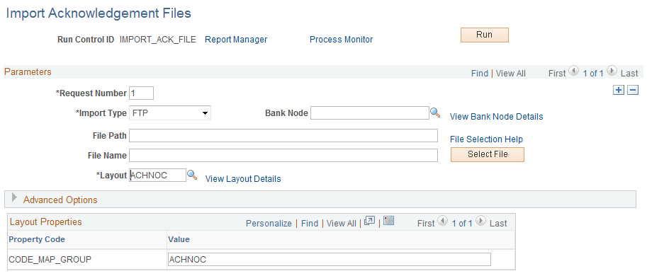

Import Acknowledgement Files Page
Use the Import Acknowledgment Files page (BSP_IMPORT) to import bank payment acknowledgments (or payment error messages) into the application tables.
Navigation:
Financial Gateway, and then Process Payments, and then Import Acknowledgment Files
This example illustrates the fields and controls on the Import Acknowledgement Files page. You can find definitions for the fields and controls later on this page.
Parameters
Field or Control Description
Import Type
Select a method for importing the acknowledgment files. The options are:
  • File: Select if you are importing a file, and complete the File Path and File Name fields.
  • FTP: Select if you are importing the file by using file transfer protocol, and enter a bank node through which to transfer the data.
  • HTTP: Select if you are importing an XML file using a URL that is included as part of the node configuration. No file path or file name is required.
Bank Node
Enter the node that will be used to relay the payment acknowledgment files from the bank to your system. This field appears only if FTP or HTTP is selected as the import type.
View Bank Node Details
Click to access the Bank Node Details page and review property details of the selected node. This field appears only if FTP or HTTP is selected as the import type.
File Location
Appears when using the File import type only. Displays the file location entered on the configuration page by a bank integration administrator. Users have access only to the folders below the base path displayed in the File Location field.
For more information, see PeopleSoft Banks Setup and Processing: Managing Import File Locations.
File Path
Enter a file path according to the import type selected:
  • File Import Type: Leave this field blank to select a file in the base path shown in the File Location field, or enter a folder name with trailing backslash below the base path, for example, /Bank02/.
    Wildcard characters are not supported when using the File import type.
  • FTP Import Type: Enter the complete file path location. To select files by using the Select File button, you must include a trailing backslash (\) in the file path.
    You can you can also load all files in a given directory by using the *.* notation or search for files of a specific type by entering an asterisk and the extension suffix. For example, to search all files with an .xxx suffix, enter \*.xxx.
  • HTTP Import Type: Does not require a file path and the field is unavailable.
Note:Be sure that the application server and the Process Scheduler have access to the directory, FTP node, or HTTP node where the files are staged for import.
File Selection Help
Click to view help information about specifying file paths and file names.
File Name
Select the specific file to import. If you want to import multiple files based on extension for the FTP import type, leave this field blank.
Layout ID
Select an acknowledgment file layout.
View Layout Details
Click to access the Layout Catalog page to view details of the acknowledgment file layout.
Advanced Options
Encryption Profile
Select an encryption profile to decrypt payment acknowledgments. Encryption profiles contain both encryption and decryption information.
Use Integration Broker
Select to format the files and publish the formatted document to PeopleSoft Integration Broker. Integration Broker then processes the formatted file accordingly.
You select this option if you want to use the payment acknowledgment information to trigger Integration Broker to perform other processes or integrate with other systems.
Post Process File Action
Select what action, if any, is to be performed on the payment acknowledgment files after the data has been processed. The options are:
  • Copy: Copy the file to the directory that is entered in the Post Precess File Directory field.
  • Delete: Delete the file after the data in it is processed.
  • Move: Move the file to the directory that is entered in the Post Precess File Directory field.
  • None: Take no action.
Post Process File Directory
Enter a file path to the directory to which the file will be moved or copied if either option is selected as the post process file action.
Layout Properties
Value
Property codes and values appear by default from values that are defined on the selected layout ID.
If you configure unique code mappings for a layout (on the Code Mappings page) you need to modify the displayed CODE_MAP_GROUP value with the appropriate unique map value.
See Code Mappings Page.
If you are importing multiple files for a single run control ID, you must add requests (by using the Add button) for each file that is being requested. Do not enter a file name; run the import process, and then edit the file name and run the import process again. Doing this can result in duplicate acknowledgment loading errors.

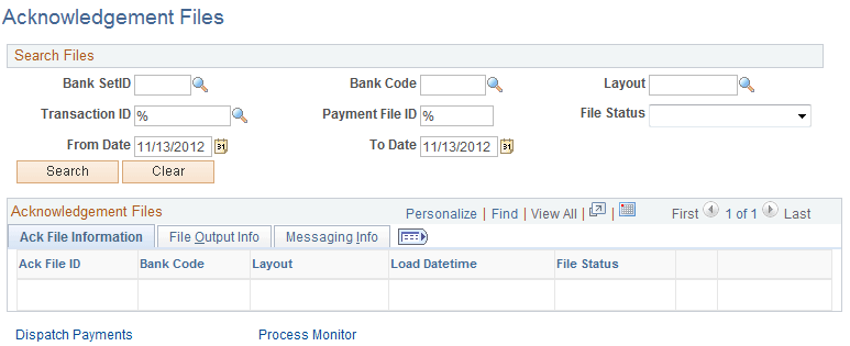

Review Payments - Acknowledgement Files Page
Use the Review Payments - Acknowledgment Files page (PMT_FILE_ACK_DEFN) to view a listing of imported payment acknowledgement files.
Navigation:
Financial Gateway, and then Review Payments, and then Acknowledgment Files
This example illustrates the fields and controls on the Review Payments - Acknowledgement Files page. You can find definitions for the fields and controls later on this page.
Enter the search parameters and click the Search button.
Ack File ID
Click the acknowledgment file ID link to view the contents of the payment acknowledgement file.
File Status
Options are:
  • Complete: Indicates that the Bank Acknowledgment Import process is complete.
  • Error: Indicates that the Bank Acknowledgment Import process failed. A red square also appears next to the file name. You can either cancel the payment file or recreate it.
View Event Log icon
Click the View Event Log icon to access the Payment File Events page, and view summary event log information.
View File icon
Click the View File icon to access the Payment File Data page, and view payment file data that are transmitted from the bank. The system encrypts stored payment acknowledgment files.
Dispatch Payments
Click to access the Payment Dispatch page to search for, and dispatch, payments.
