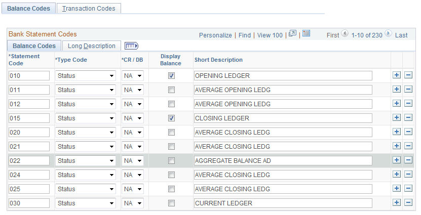

Defining Bank Statement Balance Codes
Use the Balance Codes page (BSP_BAL_CODES) to define bank statement code information.
Also select three favorite statement codes for display in online inquiry pages.
Navigation:
Banking, and then Administer Bank Statements, and then Bank Statement Codes
This example illustrates the fields and controls on the Bank Statement Codes - Balance Codes page. You can find definitions for the fields and controls later on this page.
Assign balance codes to each balance line and determine how the reconciliation process manages them. Assign a balance code to each balance entry that is received electronically or entered manually.
Field or Control Description
Statement Code
Enter a three-digit statement code that is to be defined.
Type Code
Indicate whether the code is a Status or Summary code.
CR/DB (credit/debit)
Indicate whether the code is a CR (credit) or DB (debit), or select NA (not applicable) if this categorization does not apply.
Display Balance
Select to indicate that the balance is a favorite balance. The system automatically displays the favorite balances on certain pages, such as the Bank Balance Inquiry page. You can select no more than three bank balances, however, you can change these selections at any time.

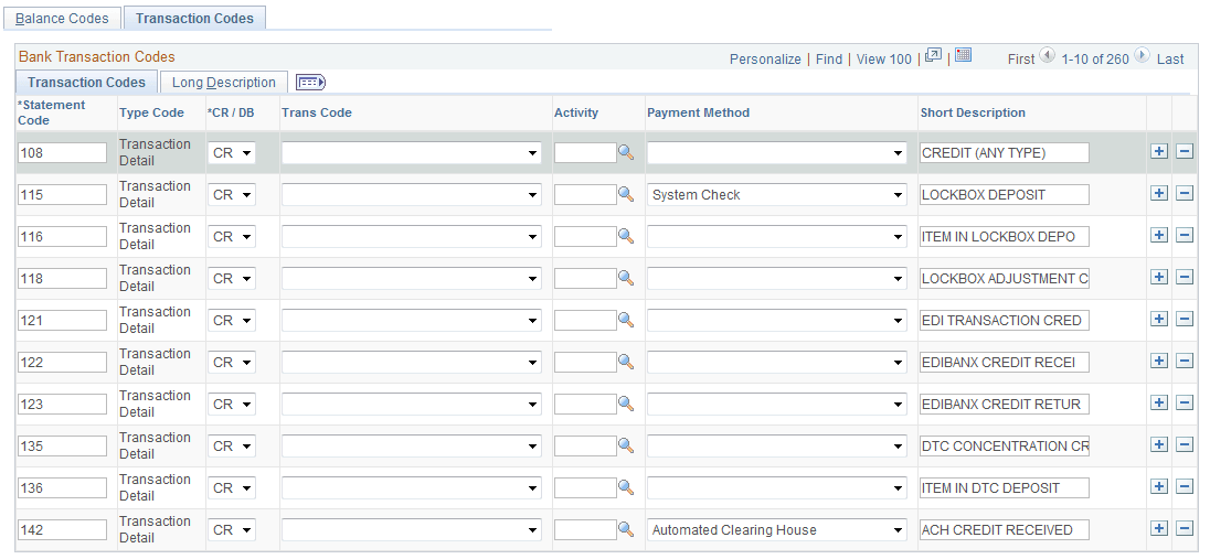

Defining Transaction Codes
Use the Bank Statement Codes - Transaction Codes page (BSP_TXN_CODES) to define bank-statement, transaction-code information, such as activity type and payment method.
Navigation:
Banking, and then Administer Bank Statements, and then Bank Statement Codes, and then Transaction Codes
This example illustrates the fields and controls on the Bank Statement Codes - Transaction Codes page. You can find definitions for the fields and controls later on this page.
The system assigns transaction codes to each bank-statement-transaction line during electronic load or manual entry. The transaction code determines how reconciliation processes the specific line item.

Trans Code (transaction code)
Identifies the type of transaction in a bank statement. Select from:
  • Automated Clearing House
  • Bank Adjustments
  • Bill of Exchange - Disburse
  • Bill of Order - Disburse
  • Check
  • Deposits
  • Direct Debit
  • Direct Debit - Disburse
  • Drafts
  • Electronic Funds Transfer
  • Fee Expense
  • Funding Receipt
  • General Transaction
  • Interest Expense
  • Manual Check
  • Miscellaneous Transaction
  • Payment
  • Stop Pay (stop payment)
  • Trade Receipt
  • Voided Payment
  • Wire - Disbursement
  • Wire - Incoming
Activity
Select a bank-statement activity type.
Payment Method
Identifies the payment method that is specified for a transaction code. Select from:
  • ACH: Automatic clearing house.
  • Check
  • Cust Draft: Customer draft.
  • Direct Debit
  • EFT: Electronic funds transfer.
  • EFT Drafts: Electronic funds transfer drafts.
  • Giro-EFT: Giro-electronic funds transfer.
  • Giro-Manual Giro-manual.
  • LC: Letter of credit.
  • Manual: Manual check.
  • Wire: Wire transfer.
  • Vndr Draft: Vendor draft.
  • Wire: Wire disbursement.
