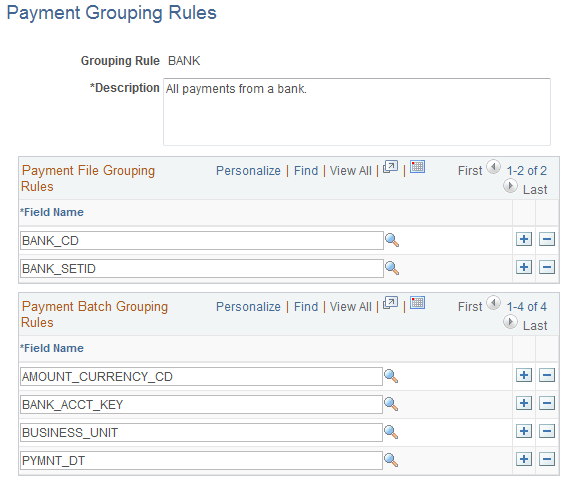

Payment Grouping Rules Page
Use the Payment Grouping Rules page (PMT_CHUNK_DEFN) to define fields to include for a specified payment grouping rule.
Navigation:
Banking, and then Administer Bank Integration, and then Payment Grouping Rules
This example illustrates the fields and controls on the Payment Grouping Rules page.
Each payment layout specification defines rules for grouping payments into the file. Grouping rules determine how payments are grouped together into payment files. Certain layouts require a different file for every payment, and other layouts require a separate file for each different business date in a file. For example, the SWIFT MT103 payment layout requires that only one payment exist in a file; therefore, the associated grouping rule is SINGLEPAYMENT.
Other layouts have different rules. For example, CCD+ files can contain payments from multiple accounts and multiple processing dates, so the grouping rule is BANK, and payments for this bank can be included in the same file. For layouts requiring payments to be processed on the same day, you can use the BANKDATE file grouping rule. You can change file grouping rules to accommodate a layout with a specific bank's requirement. To define a file grouping rule, enter the fields to group for a payment type.
There are essentially three layers of filtering that determines how payments are grouped together:
  1. Initially the system groups all payments by bank code, SetID, payment layout, and payment method.
    This level of filtering is hard coded in the system and cannot be changed or overwritten.
  2. Next, the payment file grouping rules, entered in the top grid, further define how the payments are grouped together, thus determining how many payment files are ultimately created during the payment load process.
  3. Finally, the payment batch grouping rules define how payments within a file are grouped together.
PeopleSoft delivers the following grouping rules:
Payment File Grouping Rule Description
BANK
All payments from a bank.
BANKACCOUNT
All payments from a specified bank account.
BANKACCOUNTDATE
All payments from a bank account and on a payment date.
BANKDATE
All payments from a bank and on a payment date.
SINGLEPAYMENT
One payment per file.
Payment Batch Grouping Rules
This set of fields adds an additional level of filtering that further defines how payment lines and payments are grouped together in a file. Because some payment layouts have additional requirements, this feature allows users to further define the logic for grouping payments. An example is the payment layout using ISO 20022 XML messages (credit transfer initiation and STP credit transfer). After the payments have been grouped together in a file based on the file grouping rules, they can be further grouped by fields such as business unit, source system, currency code, payment date, and payment ID. The maximum number of additional grouping fields is ten.

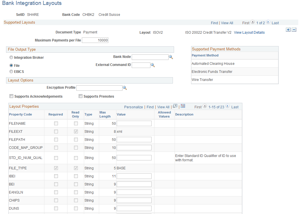

Bank Integration Layouts Page
Use the Bank Integration Layouts page (BANK_INTEGRATION) to define layouts and transformation programs for a specific bank.
Navigation:
Banking, and then Administer Bank Integration, and then Bank Integration Layout
This example illustrates the fields and controls on the Bank Integration Layouts page. You can find definitions for the fields and controls later on this page.
Field or Control Description
Layout
Select a layout from the Layout Catalog to enable for this bank. Values that are defined for the layout automatically populate the Layout Properties region.
View Layout Details
Click to access the Layout Catalog page and view details of the payment layout.
File Output Type
Integration Broker
Select to publish the layout as an IP message to the Integration Broker.
File
Select to send the layout to a file. Requires that the FILENAME, FILEEXT, and FILEPATH layout properties be defined.
EBICS
Select to indicate this layout follows EBICS protocol requirements.
For more information about using the EBICS protocol for SEPA payments, see Understanding SEPA.
Bank Node
The node to which the Integration Broker Node message will be published. Required if Message output type is selected.
External Command ID (optional)
An option that is active only if the output layout type is File. This is the external command to carry out after the file is sent. External commands are a way to carry out a third-party communication or security toolkit. They enable the output FILEPATH and FILENAME to be passed to a third-party application to initiate additional processing.
Layout Options
Encryption Profile (optional)
Select an encryption profile to apply to this payment layout's data before sending to a message or file. The profile must be one that was designed to encrypt or digitally sign files.
Use the Encryption Profile page (ENCRYPTION_PRFL) (PeopleTools, and then Security, and then Encryption, and then Encryption Profile) to define encryption standards to be used to protect data when communicating with banks and determine algorithms and store public and private keys that are used in encryption.
See the product documentation for PeopleTools: Security Administration.
Supports Acknowledgments
Select to enable functionality for receiving files containing payment acknowledgment messages from the specified bank. When payments are dispatched for this bank and layout, they will be set to a status of "Dispatched to Bank." Once a payment acknowledgement is received from the bank, the status to set to "Paid."
Note: Because no successful payment acknowledgments are sent for ACH payments, the Supports Acknowledgments functionality is never enabled for them. Therefore, when ACH payments are dispatched, the status of the payment changes to Paid, not to Dispatched to Bank. The only types of acknowledgments for ACH payments are ACH Returns and ACH Notifications of Change (NOC), which are the results of payment errors. In the case of ACH Returns, once they are imported into Financial Gateway, the payment status is reset from Paid to Error. ACH NOCs are statements of payment errors that are minor in nature and did not prevent the payment from being processed. Hence, the payment status does not change in Financial Gateway for and ACH NOC. The details of the error for ACH Returns and NOCs can be viewed from the Acknowledgment Files page.
Supports Prenotes
Select to enable the functionality for creating and processing zero-dollar, prenotification payment files using this layout.
See Understanding the Payment Process in Financial Gateway.
Supported Payment Methods
This group box displays payment methods that are supported by this layout.
Layout Properties
A payment layout can have a number of layout properties. Three layout properties are available, however, that all payment layouts contain. This table provides examples of how to set up each of them.
Field Description
FILENAME
Determines the filename when data are sent to a file or published into the Integration Broker. You can leave this property blank and the default will be BANKNAME + FILEID, or you can override and create your own naming convention.
For example:
BANKNAME_%FILEID%_ %yyyyMMdd_HHmmss%
At runtime the FILEID (%FILEID%) and Date bind variables will be bound to create a filename of:
BANKNAME_00000017_ 20031118_104316
The date bind value is flexible and can be altered to change the date format. Refer to the PeopleTools PeopleCode documentation on the DateTimeToLocalizedString function, specifically the pattern formats available.
For another example:
BANKNAME_%FILEID%_ %ddMMyyyy_HHmmss%
At runtime equals:
BANKNAME _00000018_18112003_105448
FILEEXT
File extension to add to the filename. Do not include a dot (.) in this field; the system will automatically add one between FILENAME and FILEEXT.
FILEPATH
The output directory to which the files are written. If this field is left blank, the system will send it to the default Process Scheduler file output location. Use this option only when layouts have an output type of File. The value must end in a back slash or forward slash (\ or /), depending on your operating system. For example, using Windows, "c:\temp" is invalid; it must be "c:\temp\".

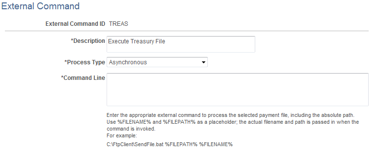

External Command Page
Use the External Command page (PMT_EXT_COMM_PG) to define command line information to carry out an external toolkit.
Optional if output type is File. This is the external command to carry out after the file is output. This enables you to integrate with third-party toolkits (such as security and communications toolkits) and define command parameters that call executable files, batch files, and command-line functions.
Navigation:
Banking, and then Administer Bank Integration, and then External Command
This example illustrates the fields and controls on the External Command page. You can find definitions for the fields and controls later on this page.
Optional if output type is file. This is the external command to execute after the file is created. External commands are a way to execute a third-party communication or security toolkit. They allow the output Filepath and Filename to be passed to a third party to initiate additional processing.
Process Type
Select a value:
  • Asynchronous: If selected, the calling process runs the external command, then immediately continues to the next step, without waiting for the external command to complete processing.
    The benefit of this method is faster processing speed. The disadvantage is that status or error messages generally cannot be relayed to the calling program; however, many external processing programs do not have the functionality to relay error messages to a calling program.
  • Synchronous: If selected, the calling program waits for each step of the called (external) process to finish before beginning the next step.
    The benefit of this method is comprehensive processing. Status or error messages can be sent to the calling program. The disadvantage is the slower processing time.
Command Line
Enter the actual command line code for the system to perform at runtime.
External commands can contain two bind variables, %FILENAME% and %FILEPATH%. At system runtime, these bind variables are bonded with the location of the output file for the external command to process.
