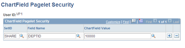

ChartField Pagelet Security Page
Use the ChartField Pagelet Security page (GL_PE_CF_SEC_PAGE) to enable additional security for the Actual vs Budgeted pagelet by restricting data access to specified department IDs and operating units.
Navigation:
Set Up Financials/Supply Chain, and then Security, and then Setup CF Pagelet Security
This example illustrates the fields and controls on the ChartField Pagelet Security page. You can find definitions for the fields and controls later on this page.
Field or Control Description
Field Name
Associates a user ID with selected department IDs and operating unit ChartField values. Your role determines how many department IDs or operating units are accessible to your user ID. For each user ID, and for every department ID and operating unit associated with a particular user ID, you must register the ChartField value information on this page to enable desired pagelet access for the user, including blank values. When users sign in to the portal, information that appears on the pagelets is limited to the specified values.
For example, the following table contains ChartField values for department IDs and operating units that are associated with a specific user ID. Prior to applying ChartField pagelet security, you may want to create a similar table as an implementation guide, noting all user IDs in your organization that require pagelet access and their associated department IDs and operating units.
User ID Department ID Operating Unit
VP1
100
200
300
400
CALIFORNIA
NEW YORK
LONDON
TOKYO
VP2
200
400
NEW YORK
CALIFORNIA
VP3
300
400
LONDON
CALIFORNIA
VP4
400
CALIFORNIA
When you set up security for pagelet data, users can use only the specified department IDs and operating units ChartField values. This limitation enables you to exercise specific controls over the data that a user sees on the pagelet. However, the security that you set up on the ChartField Pagelet Security page applies only to the Actual vs Budgeted pagelet data and not to the General Ledger that provides data to the pagelet.
Pagelet security is separate from application security. Once a user accesses an application page, that user uses the security that is set up for the application and associated ChartField Security.
See Using Roles and Permission Lists for the PeopleSoft Financials Portal Pack.
See Application Fundamentals: Understanding ChartField Security.

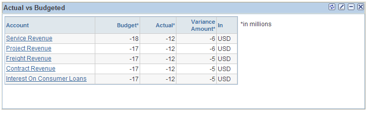

Actual vs Budgeted Pagelet
Use the Actual vs Budgeted pagelet (GL_PE_ACTVBUD) to view actual amount compared to budgeted amount for a specified time period, and view the positive or negative variance.
Navigation:
Click the Personalize Content link on the PeopleSoft Home page.
Select Actual vs Budgeted.
This pagelet displays the actual amount versus the budgeted amount (in standard budget, not commitment control budget). It is advantageous to use the Expense Variance pagelet in place of this pagelet, as the Expense Variance pagelet allows you to define a more precise scope for comparison purposes.
This example illustrates the fields and controls on the Actual vs Budgeted pagelet. You can find definitions for the fields and controls later on this page.
Account
Displays the top five accounts based on selections from the personalization page.

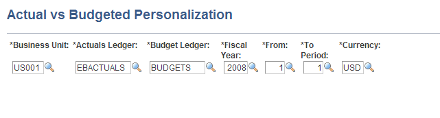

Actual Versus Budgeted Personalization Page
Use the Actual vs Budgeted Personalization page (GL_PE_ACTVBUD_PRS) to define default display information for the Actual vs Budgeted pagelet.
Navigation:
Click the Pagelet Settings icon on the Actual vs Budgeted pagelet and select Personalize.
This example illustrates the fields and controls on the Actual vs Budgeted Personalization page. You can find definitions for the fields and controls later on this page.
Actuals Ledger and Budget Ledger
Specify the actual and budgeted (standard budget) ledgers of the business unit that you want to compare. Unlike other pagelets, which qualify budget ledger by the ledger group type, this pagelet qualifies the budget ledger by ledger template. The ledger template associated with the budget ledger must be BUDGET.
From and To Period
Select a range of ledger accounting periods for the specified year.
