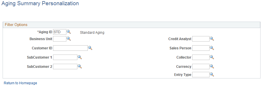

Aging Summary Personalization Page
Use the Aging Summary Personalization page (AR_PE_AGSUM_PRS) to define default display information for the Aging Summary pagelet.
Navigation:
Click the Customize Aging Summary icon on the Aging Summary pagelet.
This example illustrates the fields and controls on the Aging Summary Personalization page. You can find definitions for the fields and controls later on this page.
Field or Control Description
Aging ID
Select an aging category to display items that are part of the age range specified by the aging ID.
Entry Type
Select an entry type to display the items for an entry type in a category.
When you change any personalization options, you must run the Update Pagelet Statistics process for the pagelet to display the correct data.
