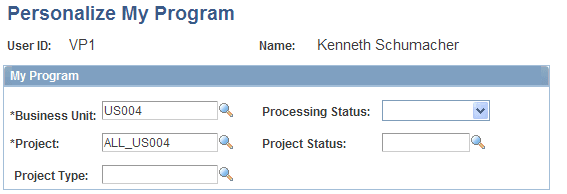

Personalize My Program Page
Use the Personalize My Program page (PGM_PE_MYPGM_PRS) to define default display information for the My Program pagelet.
Navigation:
Click the Customize My Program icon on the My Program pagelet.
This example illustrates the fields and controls on the Personalize My Program page.
Use the fields to filter the program and projects that you want to appear on the My Program pagelet.
