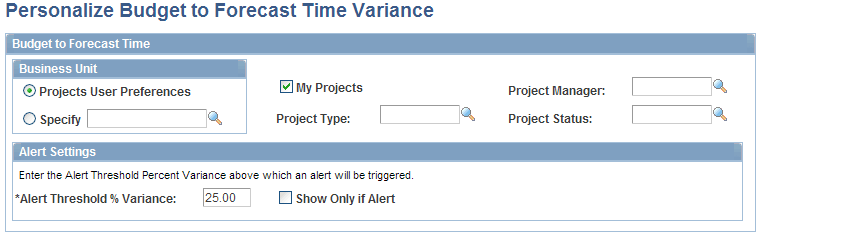

Personalize Budget to Forecast Time Variance Page
Use the Personalize Budget to Forecast Time Variance page (PC_PE_BETV_PRS) to define default data for calculating and displaying the Budget to Forecast Time Variance OTA.
Navigation:
  • Click the Budget to Forecast Time Variance link on the ESA Portal Pack Pagelet Default Administration page.
  • Click the Personalize icon for this OTA on the Personalize Operational Threshold Alerts page.
This example illustrates the fields and controls on the Personalize Budget to Forecast Time Variance page.
Define the parameters for calculating and displaying the variance between budgets and forecasted time.

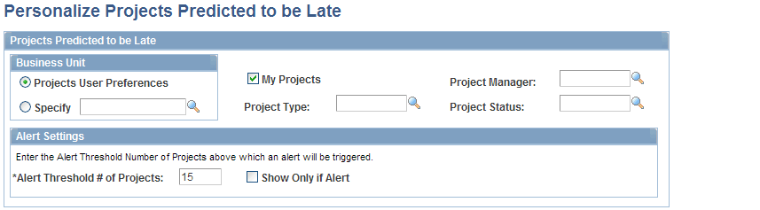

Personalize Projects Predicted to be Late Page
Use the Personalize Projects Predicted to be Late page (PC_PE_PJLT_PRS) to define default data for calculating and displaying the Projects Predicted to be Late OTA.
Navigation:
  • Click the Projects Predicted to be Late link on the ESA Portal Pack Pagelet Default Administration page.
This example illustrates the fields and controls on the Personalize Projects Predicted to be Late page.
Define the parameters for calculating and displaying the projects that are predicted to be late.

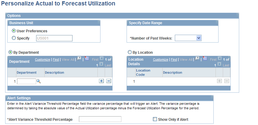

Personalize Actual to Forecast Utilization Page
Use the Personalize Actual to Forecast Utilization page (RS_PE_RSAU_PRS) to specify the business unit, date range, filter, and alert variance threshold percentage for the Actual to Forecast Utilization analysis.
Navigation:
  • Click Actual to Forecast Utilization on the ESA Portal Pack Pagelet Default Administration page.
  • Click the Customize icon on the Operational Threshold Alert pagelet or Operational Threshold Chart pagelet.
    Click the Personalize icon on the Actual to Forecast Utilization line on the Personalize Operational Threshold Alerts page.
This example illustrates the fields and controls on the Personalize Actual to Forecast Utilization page. You can find definitions for the fields and controls later on this page.
You specify business unit, department, and location information in this page in the same way as the Personalize Forecast Utilization page.
Field or Control Description
Number of Past Weeks
Specify the number of past weeks to analyze. The system starts from the previous week and counts back for the specified number of weeks. Utilization is calculated for the entire number of weeks as if it were one rolling period.
Note: The Actual to Forecast Utilization OTA pagelet and chart does not include the current calendar week in the analysis. The most recent calendar week (prior to the current week) counts as 01. The maximum number of weeks that can appear on the OTA chart is five weeks.
Alert Variance Threshold Percentage
Enter the actual to forecast utilization variance percentage that triggers an alert on the OTA pagelet. The variance is the absolute value of the actual utilization percentage minus the forecast utilization percentage. If the variance is less than or equal to the value that you enter, a green visual indicator appears on the OTA pagelet. If the variance exceeds the value that you enter, a red alert visual indicator appears on the OTA pagelet.
Enter the percentage as a whole or mixed number, such as 10 for 10 percent, or 15.5 for 15.5 percent. Enter a positive number.

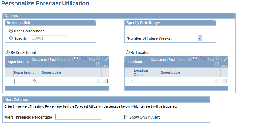

Personalize Forecast Utilization Page
Use the Personalize Forecast Utilization page (RS_PE_RSFU_PRS) to specify the business unit, date range, filter, and alert threshold percentage for the Forecast Utilization OTA.
Navigation:
  • Set Up Financials/Supply Chain, and then Pagelets, and then Enterprise Service Automation, and then Portal Pack Defaults, and then ESA Portal Pack Pagelet Default Administration
    Click Forecast Utilization on the ESA Portal Pack Pagelet Default Administration page.
    Click the Personalize icon on the Forecast Utilization row on the Personalize Operational Threshold Alerts page.
This example illustrates the fields and controls on the Personalize Forecast Utilization page. You can find definitions for the fields and controls later on this page.
Administrators establish default values for the Forecast Utilization OTA pagelet and chart for each business unit. Users can overwrite the business unit default values when they personalize the Forecast Utilization OTA.
You must select an HR business unit to identify the resources to evaluate in the OTA pagelet or chart. You can view resources from your HR business unit, or select a different business unit. You can also narrow the list of resources to evaluate based on department or location. If you do not specify a department or location, the system evaluates all resources based on the utilization definition of the business unit that you select.
User Preferences
Select to analyze resources from your HR business unit based on the utilization definition.
Note: You define the billing actions, time reporting codes, and job codes that constitute utilized time for each HR business unit in the Utilization Definition component in PeopleSoft Program Management.
Specify
Select Specify and enter an HR business unit to analyze resources from a business unit other than the HR business unit that is defined in the utilization definition.
Number of Future Weeks
Select the period over which utilization is analyzed. The system starts with the current week and counts forward for the specified number of weeks. Utilization is calculated for the entire number of weeks as if it were one rolling period.
Note: For the Forecast Utilization OTA, the current calendar week counts as week 01. The maximum number of weeks that can appear on the OTA chart is five weeks.
By Department
Select By Department to analyze utilization for one department or multiple departments in aggregate. Click Look up Department to choose from a list of departments. Add as many departments as required.
The default value for administrators is the administrator's department and business unit from the Job record (JOB). The default value for individual users is specified by the administrator.
By Location
Select By Location to analyze utilization for one location or multiple locations in aggregate. Click Look up Location Code to choose from a list of locations. Add as many locations as required.
The default value for administrators is the administrator's location and business unit from the Job record. The default value for individual users is specified by the administrator.
Alert Threshold Percentage
Enter the minimum acceptable forecast utilization percentage. If forecast utilization falls below the alert threshold percentage, a red alert visual indicator appears in the OTA pagelet. If forecast utilization equals or exceeds the alert threshold percentage, a green visual indicator appears in the OTA pagelet indicating that the forecast utilization is acceptable.
Enter the percentage as a whole or mixed number, such as 85 for 85 percent, or 75.5 for 75.5 percent. Enter a positive number.
Show Only if Alert
Select for the OTA to appear on the pagelet or chart only if forecast utilization falls below the alert threshold percentage. Deselect this option for the OTA to appear on the pagelet or chart if forecast utilization falls above, equals, or falls below the alert threshold percentage.
Restore Defaults
Select to restore the values on this page to the global default values that are established by the administrator.
This button does not appear for administrators who access the page through the Set Up Financials/Supply Chain folder in the menu navigation.
