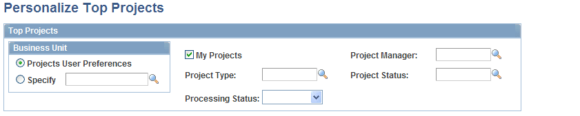

This example illustrates the fields and controls on the Personalize Top Projects page. You can find definitions for the fields and controls later on this page.
You access this page in one of two ways based on your role:
  • Administrators access the Personalize Top Projects page by clicking the Top Projects link on the ESA Portal Pack Pagelet Default Administration page. The administrator uses the ESA Portal Pack Pagelet Default Administration page to set up default filter criteria for all Enterprise Service Automation pagelets.
  • Other users access this page by clicking the Customize Top Projects icon on the Top Projects pagelet.
Field or Control Description
User Preferences
Select to view only those projects with the project business unit that is specified in your user preferences.
Specify
Select to view projects from a business unit other than the project business unit that is specified in your user preferences. If you select Specify, you must enter a business unit value.
My Projects
Select to indicate that only those projects that you designate as part of your My Projects list appear on the Top Projects pagelet. If you do not have any projects in your My Projects list, no data appears on the Top Projects pagelet.
You can optionally filter the projects that appear on the Top Projects pagelet by specifying values for these fields:
  • Project Manager
  • Project Type
  • Project Status
  • Processing Status
Restore Defaults
Click to restore the default selection criteria that the pagelet administrator establishes on the ESA Portal Pack Pagelet Default Administration page. The Restore Defaults button appears if you access this page by clicking the Customize Top Projects link on the Top Projects pagelet.
