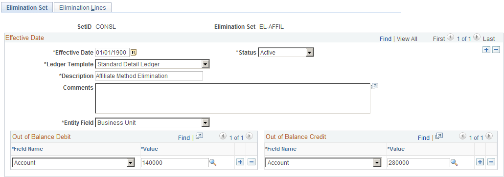

Elimination Set Page
Use the Elimination Set page (ELIMINATION_SET1) to define parameters for the elimination.
Navigation:
General Ledger, and then Consolidate Financial Data, and then Consolidation, and then Define Elimination Set
This example illustrates the fields and controls on the Elimination Set page. You can find definitions for the fields and controls later on this page.
Field or Control Description
Ledger Template
Select the ledger template that is used by the ledgers in your consolidation. If you specify a Summary Ledger template as the ledger template, the system displays the Ledger field, where you enter the summary ledger name. The system also displays a detail link; click it to access the Summary Ledger Definition page.
Description
Identifies the elimination for prompt lists.
Comments
Describe what the elimination set does. This field is particularly useful for documenting each set in a complex consolidation.
Entity Field
Select the field on which you are consolidating.
This is the field on which you have previously structured your consolidation and on which you have built your consolidation tree.
It is usually the business unit. However, if you have setup your system to use other fields, such as Operating Unit or Department for the business entity and are tracking interunit transactions among these entities, you use Operating Unit or Department as the Entity Field.
Out of Balance Debit and Out of Balance Credit
If the activity within a given elimination set does not net to zero, PeopleSoft General Ledger directs the out-of-balance amount to the Out of Balance field values that you specify on this page.
Field Name
Specify special ChartFields for the out-of-balance amounts. For example, you can enter a department for both the debit and credit field name in addition to an account Value.
For summary ledger templates, the Field Name prompt lists all the ChartFields for the summary ledger template, and the Value prompt is based on how the summary ledger is defined.

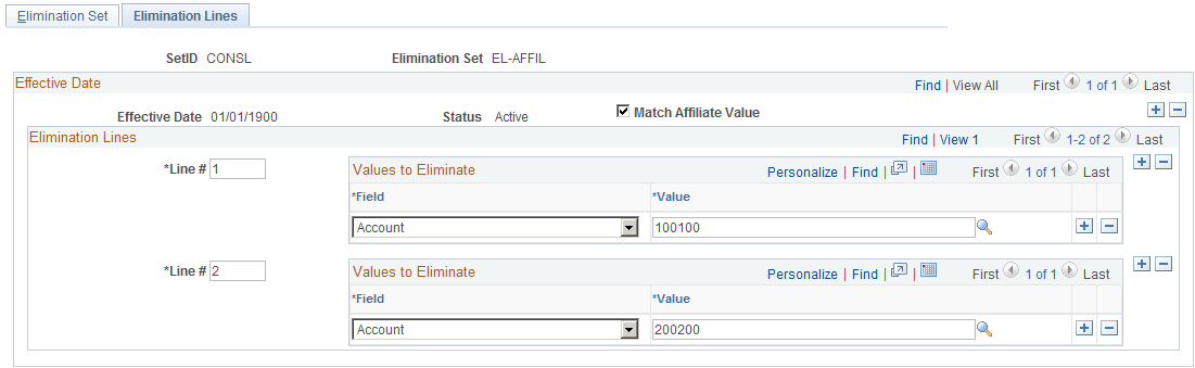

Elimination Lines Page
Use the Elimination Lines page (ELIMINATION_SET2) to define which accounts you want to eliminate.
When you define these accounts, the level of detail required depends on whether you are using the Affiliate ChartField.
Navigation:
General Ledger, and then Consolidate Financial Data, and then Consolidation, and then Elimination Sets, and then Elimination Lines
This example illustrates the fields and controls on the Elimination Lines page. You can find definitions for the fields and controls later on this page.
Match Affiliate Value
Select the check box if you use the Affiliate approach for elimination. For a summary ledger that does not have an Affiliate ChartField, the Match Affiliate Value check box is deselected and display-only.
Values to Eliminate
Field and Value
When each intercompany transaction is recorded in a unique account, the Business Unit and the Account or ALTACCT ChartField and their respective values are required. If you use the Affiliate ChartField, and its respective value is already a business unit, do not enter the Business Unit ChartField. The system evaluates business unit and affiliate relationships when you perform the consolidation based on data in the ledger.
In addition to the Account or ALTACCT ChartField, you can specify other ChartFields to further narrow the scope of the transaction being eliminated. This applies regardless of which method you use for tracking intercompany activity. To prevent duplication, the system does not allow you to enter the same ChartFields and ChartField values within the same elimination line.

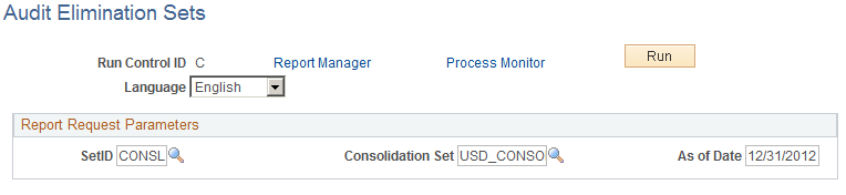

Audit Elimination Sets Page
Use the Audit Elimination Sets page (RUN_GLS2005) to set up criteria to run the GLS2005 SQR for auditing elimination sets.
Determines if any duplicate lines exist in consolidation definitions. The system uses the criteria that you enter to generate the Audit Elimination Sets report.
Navigation:
General Ledger, and then Consolidate Financial Data, and then Reports, and then Elimination Sets Audit, and then Audit Elimination Sets
This example illustrates the fields and controls on the Audit Elimination Sets page. You can find definitions for the fields and controls later on this page.
Report Request Parameters
SetID
SetID for the consolidation set.
Consolidation Set
Select the Consolidation Set for which you want to run the elimination set audit.
As of Date
Enter the point of reference date for the effective-dated setup information.
