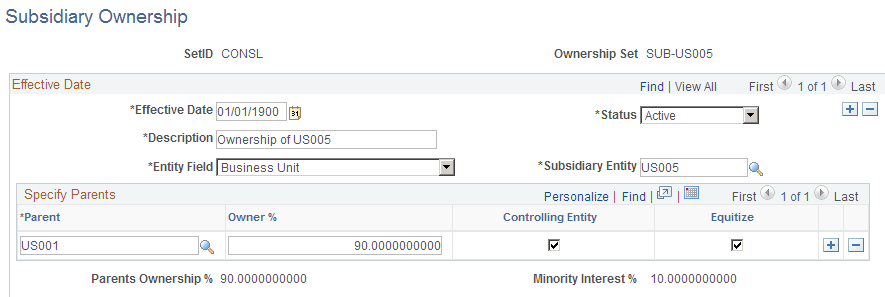

Subsidiary Ownership Page
Use the Subsidiary Ownership page (CONSOL_OWNERSHIP) to define the relationships for the parent company, subsidiary, and any other minority owners.
Navigation:
General Ledger, and then Consolidate Financial Data, and then Consolidation, and then Define Subsidiary Ownership
This example illustrates the fields and controls on the Subsidiary Ownership page. You can find definitions for the fields and controls later on this page.
Field or Control Description
Entity Field
Select the consolidating entity field. This is usually the business unit, but you can consolidate based upon other fields, like Operating Unit. This field should be the same field upon which your consolidation tree is based.
Subsidiary Entity
Organizational unit owned by the parent.
Add a new effective-dated row to reflect valid changes in subsidiary ownership. When adding new effective-dated rows, make changes only to the Specify Parents group box. The Subsidiary Entity field must stay constant, as that is the subsidiary for which you are defining ownership.
Specify Parents
Parent
Owner of the subsidiary.
Owner %
Amount of the subsidiary owned by the parent. List any minority owners that exist within your system by adding rows.
Controlling Entity
Indicates which parent is the subsidiary's majority owner. Use this option to indicate a particular parent business unit for which elimination entries will be created. The parent company selected as the controlling entity holds the minority interest liability. Only one parent entity can be the controlling entity.
To prevent duplication, the system does not allow you to enter the same parent entity value twice.
Equitize
Indicates whether equitization should be run for specified parent entities. The system processes this ownership set only when the subsidiary entity and all the parent entities marked for equitization are included in the consolidation tree.
Parents Ownership %
Total should be less than or equal to 100%.
Minority Interest %
Percentage of minority shareholder ownership.

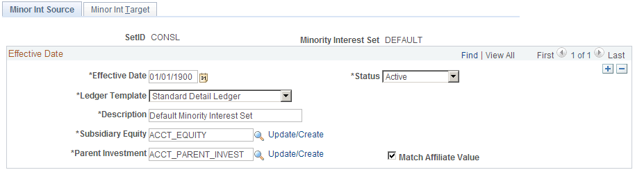

Minor Int Source Page
Use the Minor Int Source (minority interest source) page (MINOR_INT_SOURCE) to identify the subsidiary equity and parent investment accounts.
Navigation:
General Ledger, and then Consolidate Financial Data, and then Consolidation, and then Define Minority Interest Sets, and then Minor Int Source
This example illustrates the fields and controls on the Minor Int Source (minority interest source) page. You can find definitions for the fields and controls later on this page.
Minority Interest Source page
Subsidiary Equity
Specifies the ChartField value set that identifies the subsidiary's equity accounts.
Parent Investment
Specifies the ChartField value set that identifies the asset account where the subsidiary is carried on the parent company's books.
Match Affiliate Value
Select the check box if you are using a single investment account and have populated the Affiliate ChartField with the subsidiary.

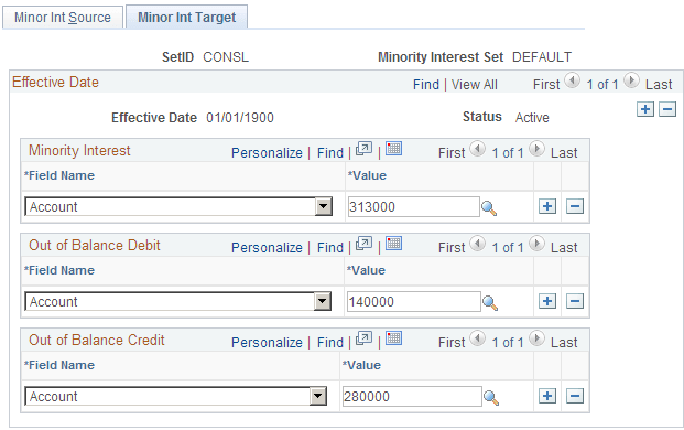

Minor Int Target Page
Use the Minority Int Target (minority interest target) page (MINOR_INT_TARGET) to specify the minority accounts of the majority parent company.
Navigation:
General Ledger, and then Consolidate Financial Data, and then Consolidation, and then Define Minority Interest Sets, and then Minority Int Target
This example illustrates the fields and controls on the Minor Int Target (minority interest target) page. You can find definitions for the fields and controls later on this page.
Minority Interest Target page
Minority Interest
Field Name and Value
Identifies the parent's equity or liability account for minority ownership in the subsidiary. After General Ledger generates the minority interest adjustment, it eliminates the majority parent's investment account against the subsidiary's equity accounts.
Out of Balance Debit and Out of Balance Credit
If the elimination does not balance, the system directs the remaining amount to the appropriate out-of-balance account or ChartFields.
You can specify special ChartFields for the out-of-balance amounts. For example, you can enter a department for both the Debit and Credit ChartFields in addition to an account.
