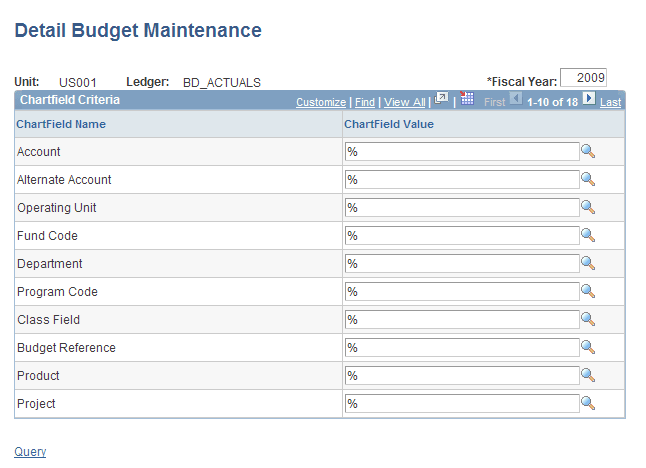

Detail Budget Maintenance Page
Use the Detail Budget Maintenance page (BE_ENTRY2) to identify the fiscal year and the ChartFields or specific ChartField values that appear on the Data by Year page and the Data by Period page for the selected business unit and budget ledger.
Navigation:
General Ledger, and then Maintain Standard Budgets, and then Detail Budget Maintenance, and then Detail Budget Maintenance
This example illustrates the fields and controls on the Detail Budget Maintenance page. You can find definitions for the fields and controls later on this page.
To use the Detail Budget Maintenance page:
  1. Enter the fiscal year that you want to review or modify for the business unit and budget ledger.
  2. Enter or select ChartField values.
    You can use wildcard characters to narrow your search of ChartFields.
  3. Click the Query link at the bottom of the page.
    The Data by Year page displays the data for each selected ChartField for the specified year.

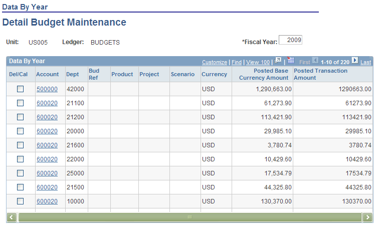

Data by Year Page
Use the Data by Year page (BE_ENTRY3A) to delete rows for the selected budget data and entered fiscal year and drill down to the Data by Period page for this specific account.
Navigation:
Click the Query link on the Detail Budget Maintenance page.
This example illustrates the fields and controls on the Data By Year page. You can find definitions for the fields and controls later on this page.
Data By Year page
To use the Data by Year page:
  1. Select the Del/Cal (delete/calculate) check box next to the ChartField rows that you want to either recalculate (by clicking the Calculate link) or delete (by clicking the Delete Selected link).
  2. To view the Data by Period page and adjust information for an account on a period-by-period basis, click the account value link in the Account field for a specific row.
  3. To return to the Detail Budget Maintenance page, click the ChartFields link.
You can enter data for ledgers only if the Ledgers For A Unit - Definition page specifies direct budget ledger updates.
See Using the Budget Calculator Feature.

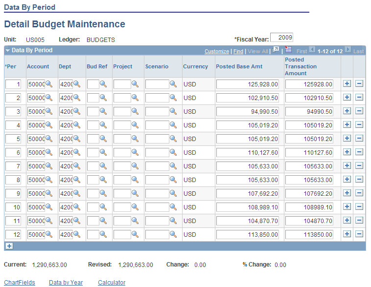

Data by Period Page
Use the Data by Period page (BE_ENTRY4) to delete or add rows and maintain budget detail information by period.
Navigation:
Click the Account link on the Data by Year page.
This example illustrates the fields and controls on the Data By Period page. You can find definitions for the fields and controls later on this page.
Data By Period page
To use the Data by Period page:
  1. Modify values, add or delete selected rows of data, or perform calculations on specified periods.
  2. Click the Calculator link to access the Budget Calculation page, where you can modify budget calculations for accounts by period.
