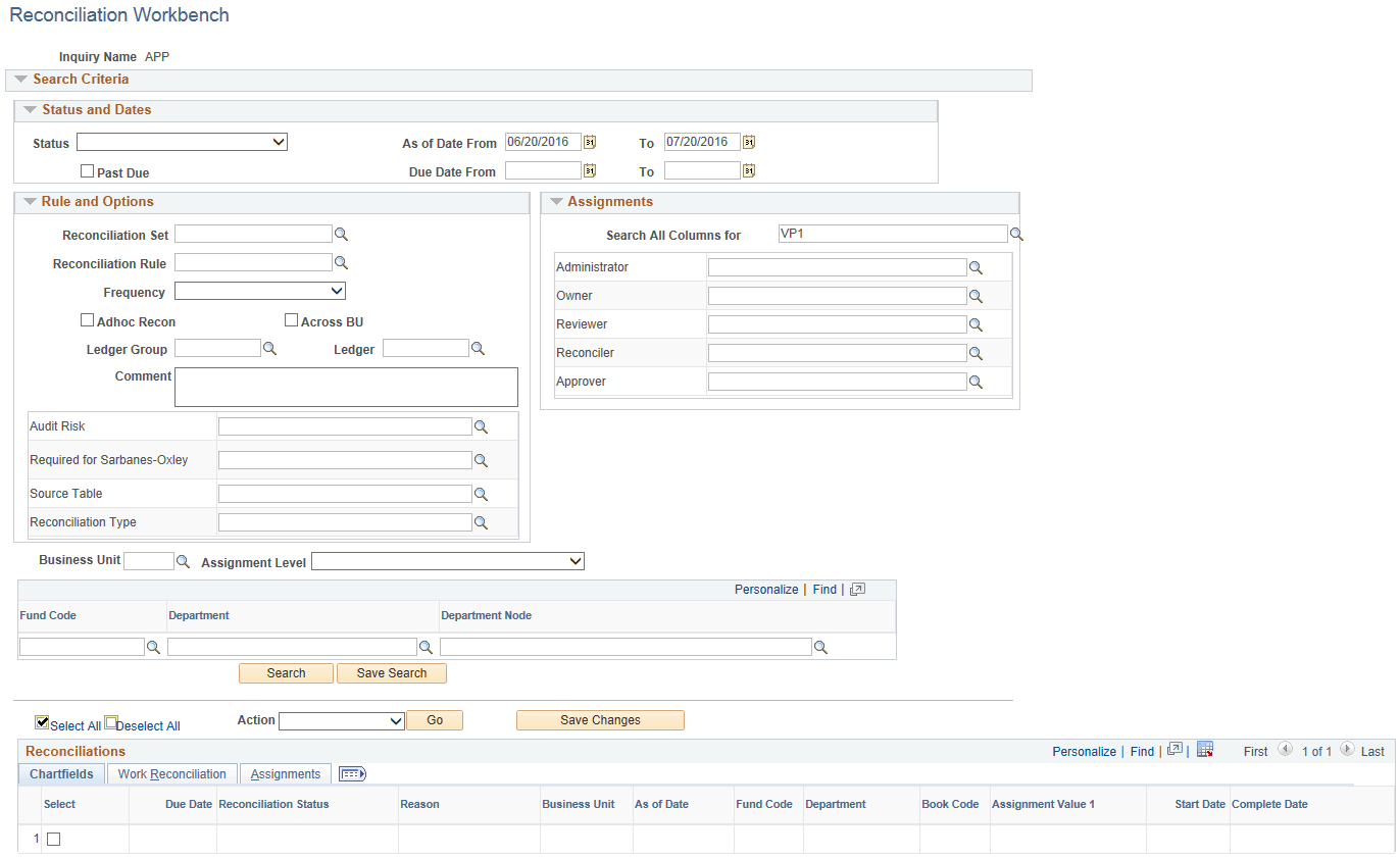

Reconciliation Workbench Page (Search Criteria)
Use the Reconciliation Workbench page (GLRN_WB) (Search Criteria) to search for reconciliation transactions.
Navigation:
General Ledger, and then Perform Reconciliation, and then Acct Reconciliation Workbench
This example illustrates the fields and controls on the Reconciliation Workbench page (Search Criteria).
Search Criteria - Status and Dates
Field or Control Description
Status
Select the system-maintained status of the reconciliation that you want to manage. Status values are:
  • Approved - Reconciliation is complete. The reconciler has completed their work and no additional approvals are required.
  • Cancelled – Reconciliation no longer needs to be completed for this period; however, it is retained for audit purposes. To prevent deletion, no additional actions are allowed.
  • Deleted - Reconciliation is physically removed. These are usually reconciliations created by mistake and no audit trail is needed.
  • Denied: - Approver has denied approval. Reconciler must make changes and resubmit.
  • Hold - Reconciliation cannot proceed for some reason and has been temporarily suspended.
  • New/Assigned: - No action has been taken as yet.
  • Not Assigned - No assignments have been made.
  • Pushed Back - Reconciliation cannot proceed until an issue is addressed. The Reason field or Comments link may be used to provide more information. Reviewer could be used to indicate whose attention is required.
  • Reconciliation In Progress - Reconciler has selected this status to indicate that reconciliation work has begun.
  • Waiting for Approval - Reconciler or approver has completed their work and submitted the reconciliation for further approval.
As of Date From/To
Enter a date range to retrieve reconciliations with As Of dates within the specified range.
Due Date From/To
Enter a date range to retrieve reconciliations that have due dates within the specified range. The Due Date of a reconciliation is calculated by the Create Reconciliations process based on the Due Date Option on the Reconciliation Rule or entered by the user.
Past Due
Select to retrieve only those reconciliations that are past their due dates.
Search Criteria - Rule and Options
Enter criteria to further limit your search for the reconciliations that you want to retrieve. You can select to limit your search by reconciliation set, reconciliation rule, adhoc reconciliation, ledger group, ledger, frequency, business unit, assignment level, and so on. The attributes that appear in the workbench for filtering values are those that were enabled on the Account Reconciliation Rule Attributes Page.
Comment
Enter text that can be used when performing searches.
ChartField Search Criteria
The ChartField Search Criteria box contains a search field for each ChartField that is included in the enabled Assignment Level. If a ChartField is summarized in one Assignment Level as detail values and in another as tree nodes, a separate search field for each is displayed.
Personalize
Click this link to personalize which ChartFields appear, or which ChartFields to hide in this section.
Department
Search for a specific Department detail value.
Department Node
Search for a specific Department tree node.

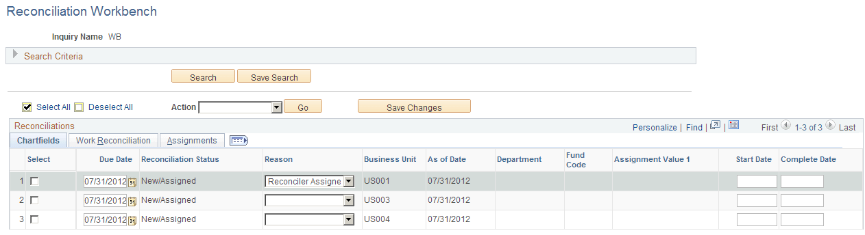

Reconciliation Workbench - ChartFields Tab
Use the Reconciliation Workbench – ChartFields tab (GLRN_WB) to perform actions and provide reasons on reconciled transactions.
Navigation:
Select the Search button.
This example illustrates the fields and controls on the Reconciliation Workbench - ChartFields tab.
Once you enter your criteria and click the Search button, the reconciliations that match your criteria display in the Reconciliations section.
If a reconciliation is created with an incorrect value in one of the display-only fields (for example, ledger, ChartFields, and so on), the reconciliation must be canceled or deleted and recreated.

Select
Select the reconciliation row(s) for which to perform an action, select the action to perform from the drop-down list and click the Go button. This field is common to all tabs in the Workbench.
Action
Once you have reviewed the information and completed the intended reconciliation work for your role, select the check box(es) in the Select column, and select the appropriate Action option. Possible values are: Approve, Cancel, Deny, Mark as Deleted, Mark as Hold, Mark as In Progress, Mark as Newly Assigned, Mark as Not Assigned, Push Back, or Submit for Approval. The actions that appear for selection depend on the user’s role as well as the current reconciliation status. See Status field on the Reconciliation Workbench Page (Search Criteria).
Note: To physically delete reconciliations that have been marked as Deleted, you must use the archive manager in PeopleTools.
Go
Click this button to apply the selected action to the selected reconciliation(s). The selected reconciliation(s) are edited to ensure the requested action is valid. Any reconciliation with a status that is not valid for the requested action is identified in an error message. To correct the issue, either deselect the invalid reconciliation(s) or change the requested action.
Due Date
This date is calculated based on the As Of Date provided when running the Create Reconciliation process and the Due ___ Days Relative to As Of Date field from the Reconciliation Rule. You can change the due date if your role has the proper security. See Configuring Security (Workbench Access).
Reason
If your user ID is assigned a role with proper security access, you can provide a reason for the selected action. Available reasons are defined on the Reconciliation Statuses and Reasons Page.
Save Changes
Click this button to save any changes that you have made to the reconciliation fields.

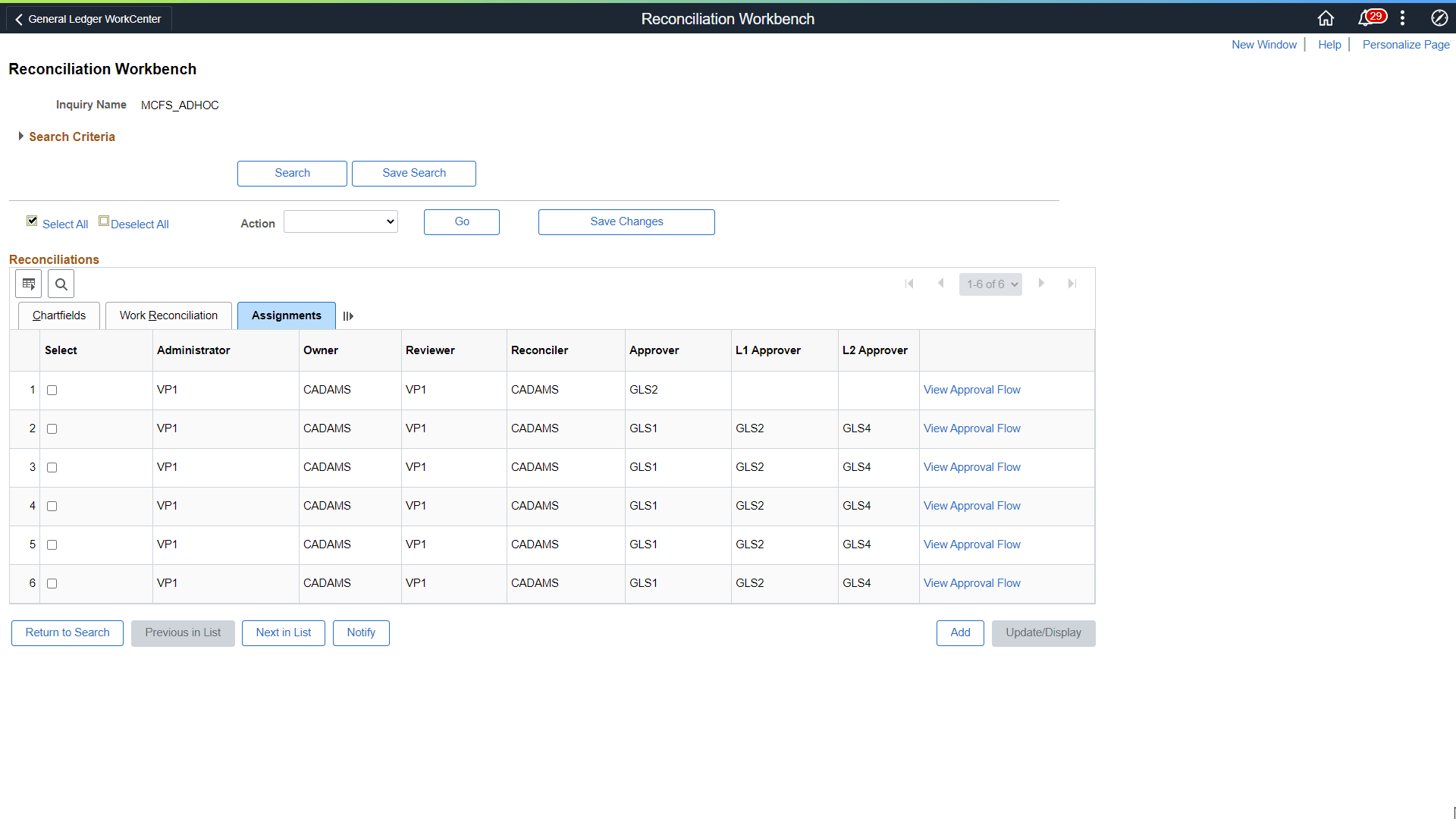

Reconciliation Workbench – Assignments Tab
Use the Reconciliation Workbench – Assignments tab (GLRN_WB) to review and update the current assignments and view the approval flow as security allows.
Navigation:
Select the Assignments tab.
This example illustrates the fields and controls on the Reconciliation Workbench – Assignments tab.
Reconciliation Workbench - Assignments tab
The user ID assignments that appear for each role are derived initially from the default values on the Reconciliation Rule, or as updated on the Reconciliation Assignment page:

Select
Select this check box for those rows that you want to update.
<Role>
Displays user IDs that are currently assigned to each role that is enabled for reconciliation. If a role is not enabled, it does not display on the Reconciliation Workbench.

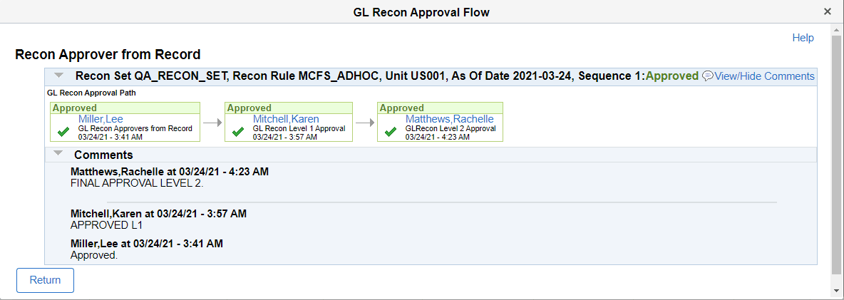

View Approval Flow
Select to access the GL Recon Approval Flow page, which displays the approvers and their comments.
Viewing Approvers and Comments
Use the GL Recon Approval Flow page (GLRN_APPR_MONITOR) to view the approval chain and approver comments for a reconciliation transaction.
The approval and comments are displayed only for reconciliations that are approved using the Fluid Approval component.

Select the Assignments tab and then select the View Approval Flow link.
This example illustrates the fields and controls on the GL Recon Approval Flow page.
Recon Approver from Record

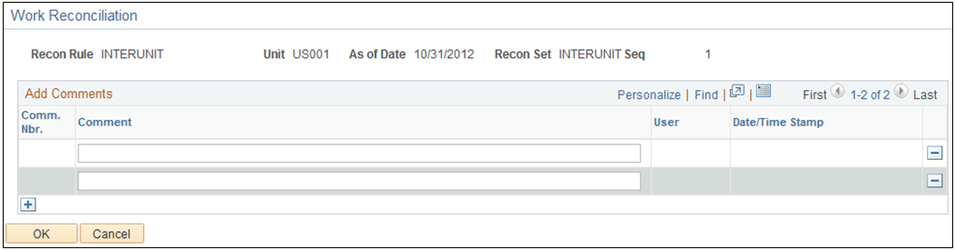

Workbench Reconciliation - Add Comments Page
Use the Workbench Reconciliation – Add Comments page (GLRN_WB_CMMT_SEC) to add or review comments about the reconciliation.
Navigation:
Select the Work Reconciliation tab and then select the Comments link.
This example illustrates the fields and controls on the Workbench Reconciliation - Add Comments Page. You can find definitions for the fields and controls later on this page.
Work Reconciliation - Add Comments page
Reconcilers, reviewers, or approvers can add comments on this page that relate to the reconciliation depending on their assigned security. When they click the OK button, a comment number is assigned and their User ID and Date/Time Stamp are recorded next to their comment.
