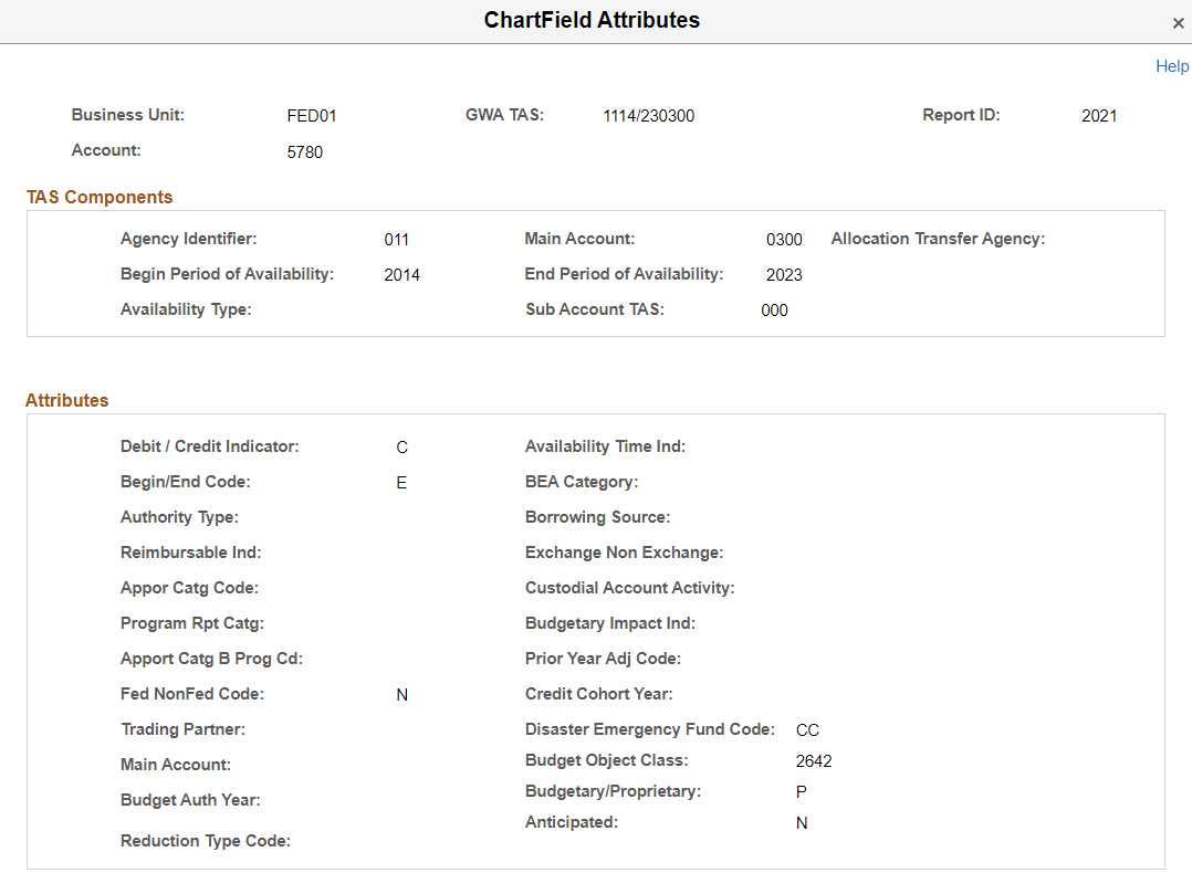

GTAS Workbench – ChartField Attributes Page
GTAS_STG_DTL_ATTR
Review the assigned attributes and attribute values associated with specific ChartFields based on the criteria entered on the GTAS Workbench Header page.

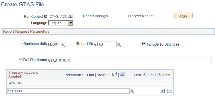

Create GTAS File Page
GTAS_CREATE_FILE
Select the criteria necessary for PeopleSoft to generate the GTAS bulk file to upload to the U.S. Treasury.

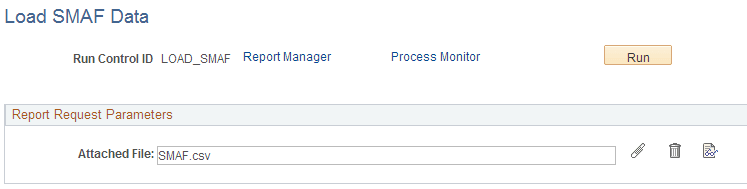

Load SMAF Data Page
Use the Load SMAF Data page (GTAS_RUN_SMAF) to run the process that loads SMAF data from U.S. Treasury to PeopleSoft GL. Data contains the valid Treasury Account Symbol balances and attributes for each TAS used for budgetary and proprietary adjusted trial balance submissions.
Navigation:
General Ledger, and then Federal Reports, and then GTAS Processes, and then Load SMAF Data, and then Load SMAF Data
This example illustrates the fields and controls on the Load SMAF Data page. You can find definitions for the fields and controls later on this page.
Load SMAF Data
Field or Control Description
Displays the location and file name of the SMAF file after you click the Add Attachment button; or enter the location of the selected file, for example: C:\temp\<filename>. This file is sent by the U.S. Treasury to PeopleSoft General Ledger. This data is loaded into database tables for later use when you run the validation. These files are available for download from the U.S. Treasury.
Attach
Click the Add Attachment button to attach the SMAF file that you want to load.
Delete Attached File
Click to delete the attached file in the Attached File field. This action deletes only the file attachment. If you have already clicked this button to upload the file, clicking this button does not delete the data from the database table.
View Attachment icon
Click to open and review the contents of an attached SMAF file.
Run
Select to access the Process Scheduler Request page and run the GTAS_SMAF Application Engine load process.

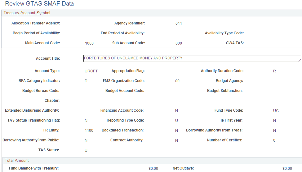

Review GTAS SMAF Data Page
Use the Review GTAS SMAF Data page (GTAS_SMAF_ REVIEW) to review the resulting SMAF data from Treasury that was loaded using the Load SMAF Data process. This page provides read-only access to the SMAF data by TAS.
Search for and view resulting data by GWA TAS before running the Accumulate GTAS Data process.
Navigation:
General Ledger, and then Federal Reports, and then GTAS Review, and then Review SMAF Data, and then Review GTAS SMAF Data
This example illustrates the fields and controls on the Review GTAS SMAF Data page. You can find definitions for the fields and controls later on this page.
Review SMAF Data
The SMAF Load process writes the Treasury data to the SMAF record. Use this page to review the data that is stored in the SMAF record. The PeopleSoft SMAF table holds one row for each TAS. Search by GWA TAS to view the details of each row. Each time you run the SMAF Load process, the data is replaced for each TAS that is contained in the file. To update the GWA TAS field, the TAS must be set up in the Treasury Account Symbol Definition page. If the GWA TAS is missing, you must first set up the TAS and then rerun the SMAF Load process.
The SMAF record includes the GWA TAS field so that when you create validation and edit queries against it, there is only one field to join to the TAS_FUND_CD_TBL to retrieve the Fund.

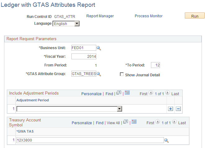

Ledger with GTAS Attributes Report
Use the Ledger with GTAS Attributes report (GTAS_RUN_LEDRPT) to run the report for GTAS data that will be selected for processing along with associated attributes prior to running the Accumulate GTAS data process.
Navigation:
  • General Ledger, and then Federal Reports, and then GTAS Review, and then Ledger w/GTAS Attributes Rpt
  • Click the Ledger With Attributes Report link from the GTAS Workbench - Header page.
This example illustrates the fields and controls on the Ledger with GTAS Attributes Report run control page. You can find definitions for the fields and controls later on this page.
The purpose of the Ledger with GTAS Attributes Report is to show GTAS data that will be selected for processing, along with associated attributes, prior to running the Accumulate GTAS data process. You can run this report throughout the month to correct errors.
Supply the Report Request Parameters and run the report. Like GTAS, this report reflects the data from the primary ledger of the ledger group that is associated with the selected business unit. Click the Process Monitor link to view the process status. Click the Report Manager link to view the completed report. Supply only one GWA TAS in the Treasury Account Symbol section to improve report performance.
Show Journal Detail
Select this check box to create the General Ledger Activity with Attributes report with Journal Details. If this check box is deselected, the process generates the summary version of the report.
Run
Click to generate the Ledger Activity report (GLX7017) containing the specified business unit ledger's fund and account attributes for the specified fiscal year and period range. This report can include journal detail and follows the same logic for deriving attributes as the Accumulation process.

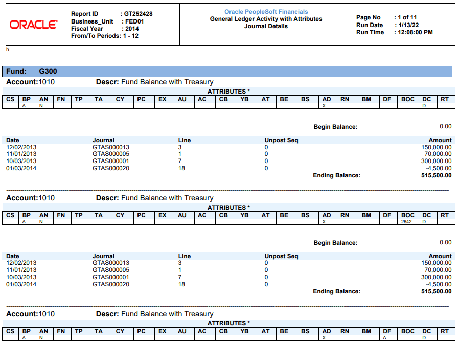

The fields on the resulting report reflect the fields as they are in the GTAS Workbench record.
This example illustrates the fields and controls on the General Ledger Activity with Attributes - Journal Details.
Ledger with GTAS Attributes Report Results

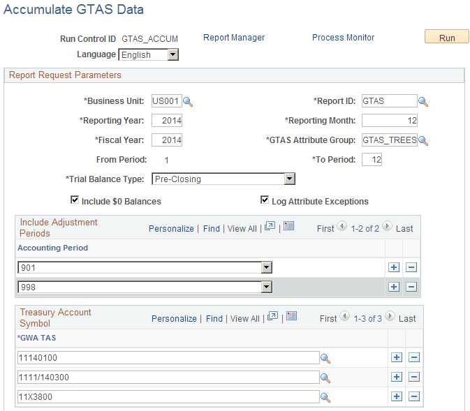

Accumulating GTAS Data
The Accumulate GTAS Data program combines data from the ledger with associated attributes and populates this data to a workbench table where you can review before creating the GTAS bulk file.
Accumulate GTAS Data Page
Use the Accumulate GTAS Data page (GTAS_RUN_EXTRACT) to run the process that combines data from the Ledger with Attributes and populates this data to a workbench (staging) table for review before creating the GTAS bulk file.
Navigation:
General Ledger, and then Federal Reports, and then GTAS Processes, and then Accumulate GTAS Data
This example illustrates the fields and controls on the Accumulate GTAS Data Page. You can find definitions for the fields and controls later on this page.
Language
Select the language for this GTAS report (only if the language is other than English).
Business Unit
Select the business unit for which to run the Accumulate GTAS Data process.
Report ID
Select a free form Report ID to identify the dataset for the program run.
Note: The Report ID is a unique identifier and as such, when the Accumulate process is run with the same Report ID, any prior data with a previously used Report ID is overwritten.
Reporting Year and Reporting Month
Enter the reporting year and reporting month of this report which will be reported on the bulk file.
Fiscal Year
Enter the fiscal year that applies to this report for selecting data from the Ledger.
GTAS Attribute Group
Select the GTAS Attribute Group for GTAS attributes and tree derivation.
From Period and To Period
Enter the begin and end accounting period range that applies to this report for selecting data from the Ledger. These fields are required.
Trial Balance
Select whether to include closing adjustments and balances in the GTAS data:
  • Closing - reflects balances after the close of the fiscal year. Includes adjustment period 999.
  • Pre-Closing - reflects remaining appropriation balances prior to the close of the fiscal year.
  • Pre-Closing, Adjustments Only - reflects remaining appropriation balances that are recorded in the selected adjustment periods only. These are the balances prior to the close of the fiscal year.
Includes $0 Balances
Select to include accounts with zero balances in the GTAS Workbench (staging table).
Log Attribute Exceptions
Select to create a log that details the attributes that were assigned by exception rules
Note: The ChartField Exception report does not dynamically address affects of the ChartField Configuration process. The report template and definition may be impacted if you have configured ChartFields. Make changes accordingly.
Include Adjustment Periods - Accounting Period
Select the adjustment periods to include in the output file. You can add more than one row. In order for the correct adjustment periods to be available for selection, you must set up your Application Fundamentals: User Preferences - Overall Preferences Page with the corresponding General Ledger business unit and SetID as that of the Open Period Update page where the adjustment periods are defined for a ledger and business unit).
Treasury Account Symbol - GWA TAS
Select the GWA String TAS(s) that are associated with the funds that you want to report for GTAS.
See Defining Component TAS and BETC Elements in Compliance with Federal Reporting Requirements.

Attributes
Click to access the ChartField Attributes modal page to view the attributes associated with each line balance.
Use the GTAS Workbench - ChartField Attributes page to review the assigned attributes and attribute values associated with specific ChartFields based on the criteria entered on the GTAS Staging Header page. All fields on this modal page are display only.
Navigation:
General Ledger, and then Federal Reports, and then GTAS Review, and then Review GTAS Workbench, and then Detail. Perform a search. From the GTAS Workbench - Detail search results page, Balances grid, scroll to the right and select the Attributes button.
This example illustrates the fields and controls on the GTAS Staging Detail – ChartField Attributes page.

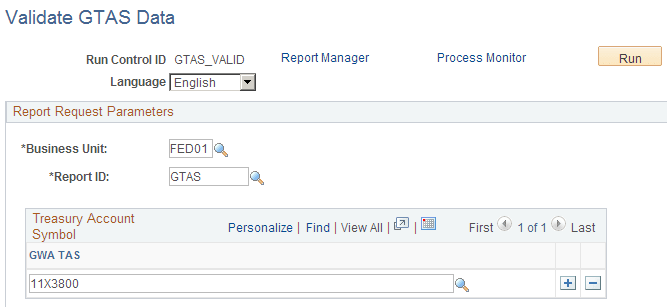

The Validate GTAS Data program runs edits against the accumulated data. The program calls each query that is identified on the GTAS Edits and Validations page in the order specified and runs once for each TAS. If any query returns results (results are considered errors), an Excel file is created for each query along with the resulting output report Access the Process Monitor for the Excel file. Access the Report Manager for the error output report.
Validate GTAS Data Page
Use the Validate GTAS Data page to runs edits against the accumulated data. The program calls each query that is identified on the GTAS Edits and Validations page in the order specified and runs once for each TAS.
Navigation:
General Ledger, and then Federal Reports, and then GTAS Processes, and then Validate GTAS Data, and then Validate GTAS Data
This example illustrates the fields and controls on the Validate GTAS Data page. You can find definitions for the fields and controls later on this page.
Validate GTAS Data run control page
Business Unit
Select the GL business unit for which to run the Validate GTAS Data process. This GL business unit is used to run each query.
Report ID
Enter the Report ID that you created when accumulating the GTAS data.
GWA TAS
Select the GWA String TAS that is associated with the funds that are being reported for GTAS. The combination must be valid on the TAS/BETC table and the corresponding funds are retrieved and passed as a parameter to each query. Each query runs separately for each combination of Agency Identifier and Main Account TAS for each GWA TAS. The validation process performs edits against the account balances that are generated by the accumulation process and generates a report that indicates a pass or fail for each edit. If this field is blank, the process runs for all TAS.
Report Manager
Click to check status of process and to retrieve the generated Edit and Validations error report.
Process Monitor
Click to retrieve generated .csv error reports from each query in error.

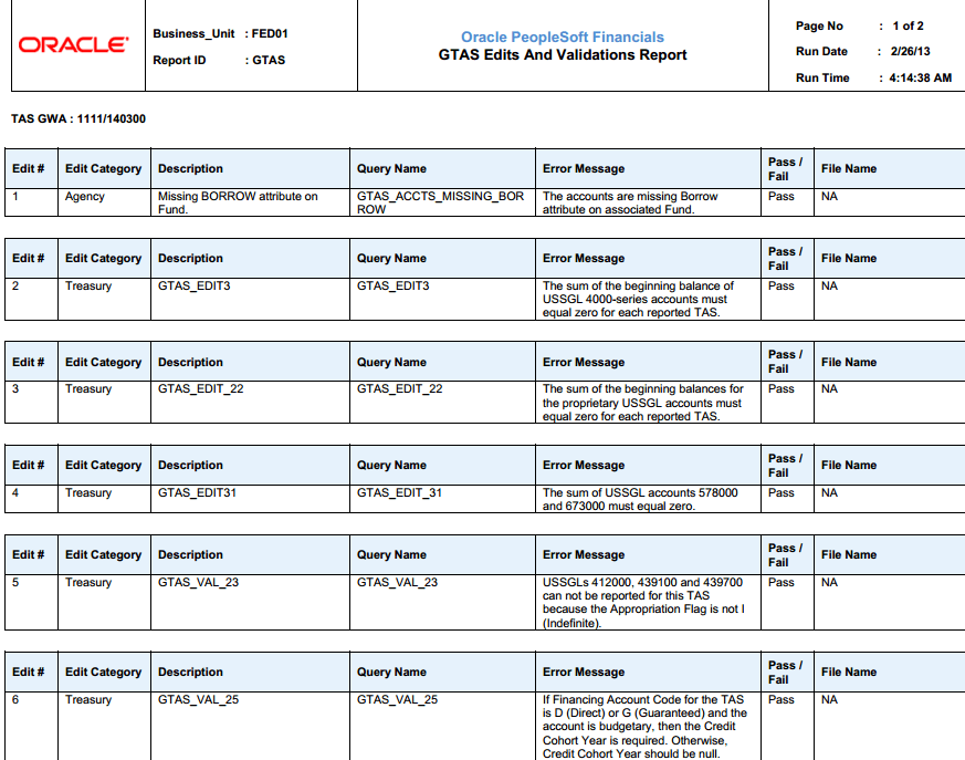

The following is a sample of the resulting report:
This example illustrates the fields and controls on the Sample of the GTAS Edits and Validations Report. You can find definitions for the fields and controls later on this page.
GTAS Edits and Validations report
Use the Create GTAS File page to select the criteria necessary for PeopleSoft to generate the GTAS bulk file to upload to the U.S. Treasury.
Navigation:
General Ledger, and then Federal Reports, and then GTAS Processes, and then Create GTAS Bulk FIle, and then Create GTAS File
This example illustrates the fields and controls on the Create GTAS File page. You can find definitions for the fields and controls later on this page.
Create GTAS File
Business Unit
Select the GL Business Unit for which to run the Create GTAS File process.
Report ID
Select the Report ID created during the Accumulate GTAS Data process.
Include $0 Balances
Select to include $0 balances in the GTAS file. Treasury does not require $0 balances to be reported; however, if they are reported, the attributes must be included and correct.
GTAS File Name
Enter the name for the GTAS flat file. You must use a .TXT file extension. Do not enter a path.
GWA TAS (Government-wide Accounting Treasury Account Symbol)
Select the GWA String TAS that is associated with the funds being reported for GTAS. If GWA TAS is not specified, this process runs for all TAS within the specified Business Unit/Report ID.
Process Monitor
Click to check the status of a process.
Report Manager
Click to retrieve generated GTAS bulk file to be used for submission to the Treasury.
