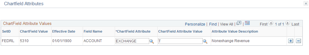

Example 1 Acct 5310 Attribute T
Notice that T is the default value for the Exchange attribute for account 5310 on the corresponding Chartfield Attributes page.

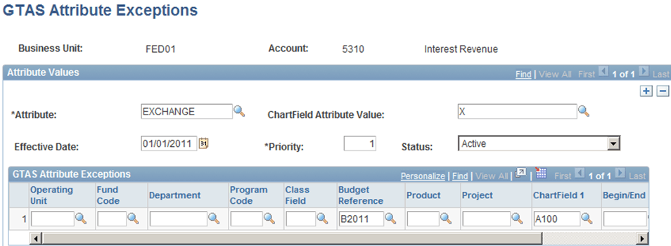

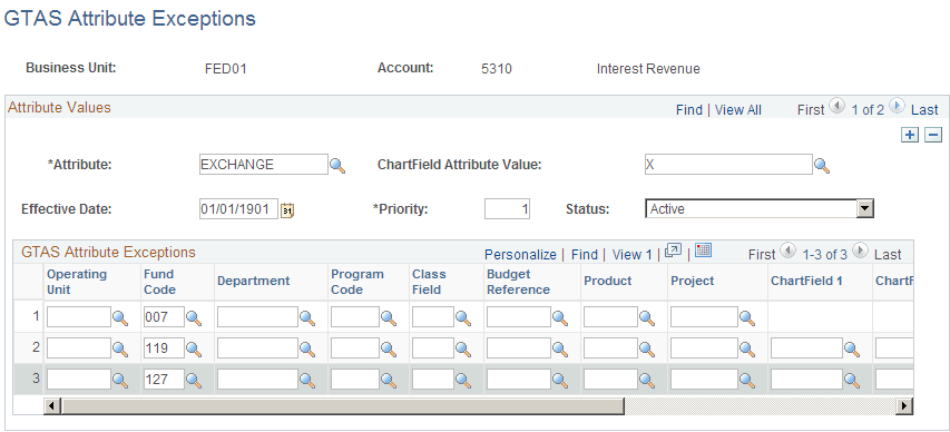

Use the GTAS Attributes Exceptions page to set up the following exceptions:
This example illustrates the fields and controls on the GTAS Attributes Exceptions page - Account 5310 - Exchange Attribute.
Example 1 Attribute Exceptions page
The GTAS Attribute Exceptions page for Account 5310 (above) is set up for the following exception: For all transactions with a transaction date of 1/1/2011 and beyond and an account of 5310, Budget Reference of B2011, and ChartField1 of A100, the default Exchange attribute of T will be overridden with an X value.

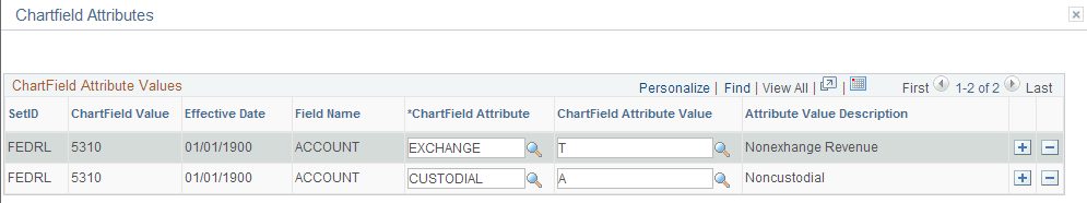

This example shows an exception with multiple ChartField combinations in the Exceptions grid for account 5310 and the attribute, EXCHANGE. Access the Account page for account 5310 and click the Attributes link:
This example illustrates the fields and controls on the Chartfield Attributes page - Account 5310.
Example 2 CF Attribute
Similar to Example 1, T is the default value for the EXCHANGE attribute for account 5310. The default value of T is overridden for transactions that meet the criteria below:

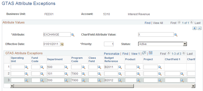

This example illustrates the fields and controls on the GTAS Attribute Exceptions page - Account 5310 - Exchange Attribute - Priority 1.
Example 2 Attribute Exceptions Priority 1
When processing these exceptions, the program first processes rows 1 and 2 since they have the least number of ChartFields. Then the program processes row 3. This exception is given priority over the other exceptions for the Account 5310 and the EXCHANGE attribute since the Priority = 1.

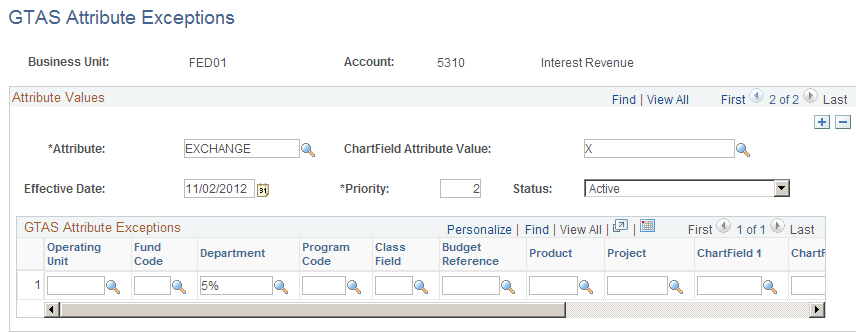

The following exceptions for Account 5310 and the EXCHANGE attribute are given a priority of 2. Transactions that meet the criteria for this attribute value (E) AND the attribute value (X) shown above will be assigned the attribute value of X due to the Priority Order.
This example illustrates the fields and controls on the GTAS Attribute Exceptions page - Account 5310 - Exchange Attribute - Priority 2.
Example 2 Attribute Exceptions priority 2

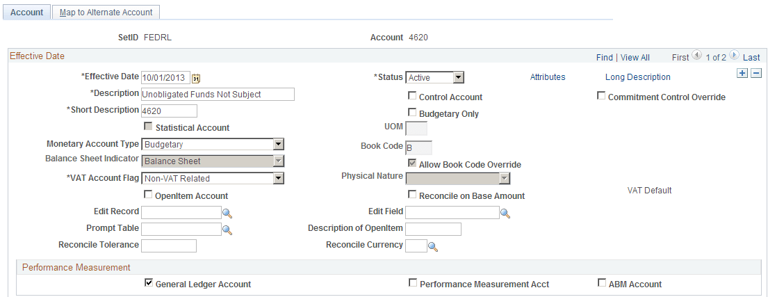

The default for Availability Time Indicator for account 46200 is ‘A.’ The Treasury Validation 13 Exception states “If Begin End Indicator is B (beginning) for USSGL 462000, then the Availability Time Indicator must be null. If the Begin End Indicator is E (ending) for USSGL 462000, then Availability Time Indicator is ‘A.
Access the Account page for account 4620 (since Account 4620 rolls up to USSGL 462000):
This example illustrates the fields and controls on the Account 4620.
Example 3 Account 4620

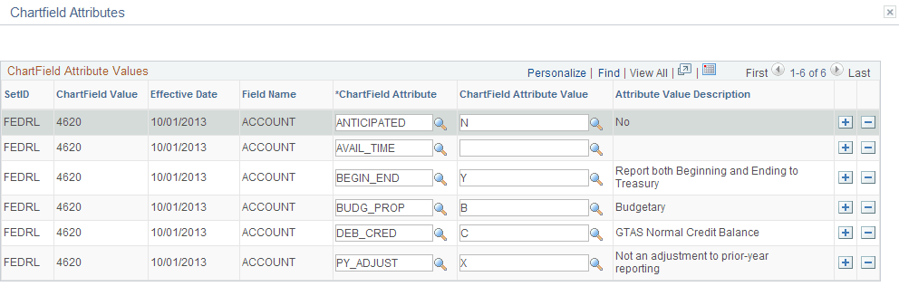

Click the Attributes link . The following are the attribute values for account 4620:
This example illustrates the fields and controls on the ChartField Attribute Values page - Account 4620.
Example 3 CF Attribute page

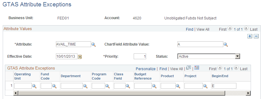

The default for the Availability Time Indicator is set to null for Account 4620 on the Account Attributes page. This covers the statement that all transactions with account 4620 and Begin End Indicator of ‘B’ have AVAIL_TIME equal to null.
Also, for all transactions with account of 4620 and a Begin End Indicator of ‘E,’ the default AVAIL_TIME attribute is A. For this, set up the GTAS Attribute Exceptions page for Account 4620, Attribute AVAIL_TIME as follows:
This example illustrates the fields and controls on the GTAS Attribute Exceptions page - Account 4620- AVAIL_TIME Attribute.
Example 3 Attribute Exceptions page
When a value is entered in the Begin End exception field, the Accumulation process creates two rows on the Staging Table if both beginning and ending balances must be reported to accommodate the differing attributes. Additionally, only 1 row with a value in the Begin End exception field should be entered for each Attribute/Attribute Value combination.

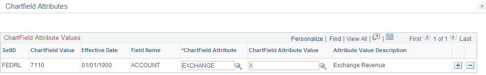

Then accounts 7110 and 7210 are given the ‘X’ exchange default: (only the Account 7110 Attribute value shown below):
This example illustrates the fields and controls on the ChartField Attribute Values page - Account 7110.
Example 4 Acct 7110
