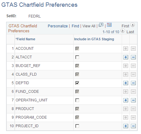

GTAS ChartField Preferences Page
GTAS_STG_DTL_CF
Select the ChartFields to be included in the GTAS staging table (Workbench).

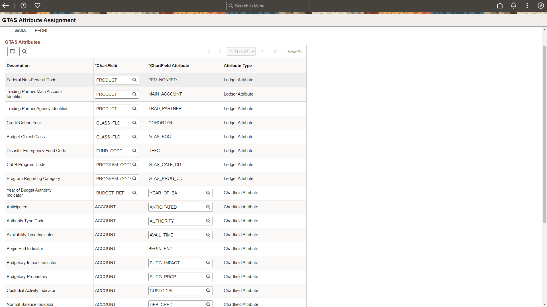

GTAS Attribute Assignment Page
Use the GTAS Attribute Assignment page (GTAS_ATTR_XREF) to map a GTAS attributes that can be associated with multiple ChartFields such as Year of Budget Authority Indicator.
Navigation:
General Ledger, and then Federal Reports, and then GTAS Definition, and then Attribute Assignment
This example illustrates the fields and controls on the GTAS Attribute Assignment page.
This page is also used to associate an attribute name with a PeopleSoft attribute. It contains all attributes even if the assigned ChartField is not editable. Specify the ChartField name for all editable attribute rows.
Field or Control Description
Description
Description of the GTAS attribute (data element).
ChartField
Select a configurable ChartField to associate with each Ledger Attribute Type (only available for select ChartFields). See ChartField Attributes Table.
Predefined attributes that GTAS collects as requirements of the U.S. Treasury. You may change the editable ChartField Attributes, if needed
Attribute Type
Denotes whether the attribute is assigned via a ChartField or Ledger.

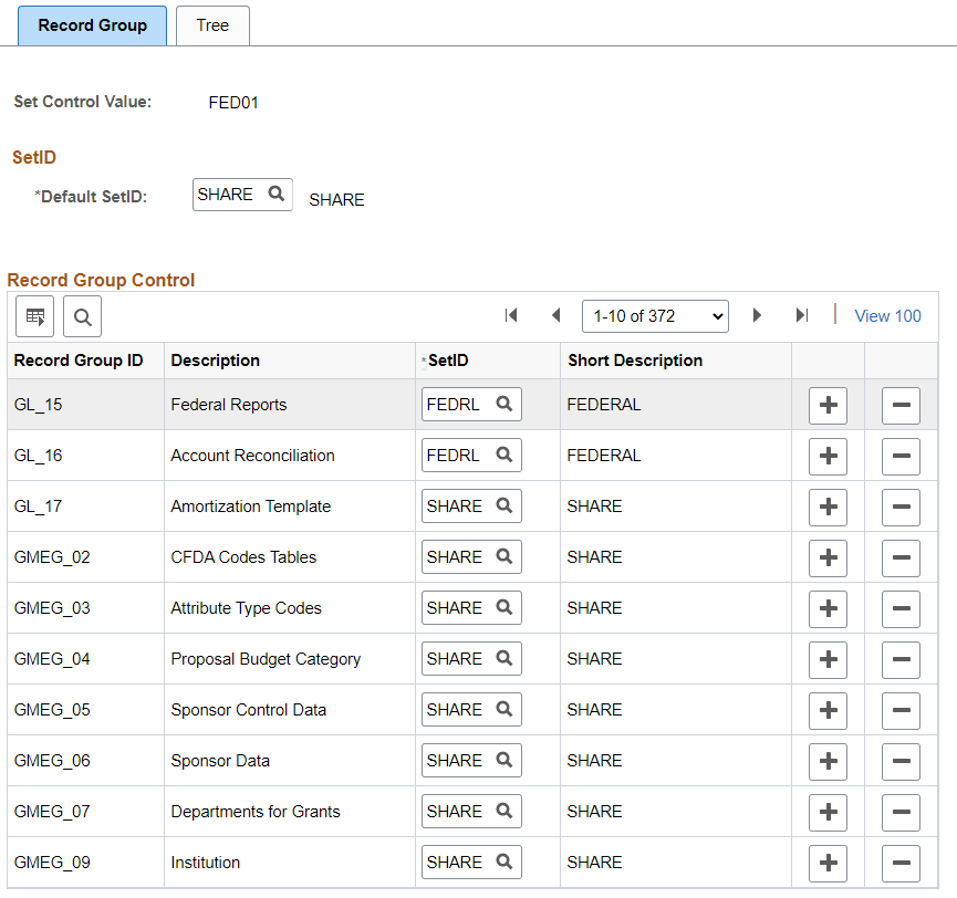

TableSet Control - Record Group Page
Use the Record Group page (SET_CNTRL_TABLE1) to properly configure the TableSet Controls for GTAS processing.(PeopleTools, Utilities, Administration, TableSet Control, Record Group). Identify the general ledger business unit (for example, FED01) that you want to use for GTAS processing. For this example, enter FED01 for the Set Control Value:
Navigation:
PeopleTools, and then Utilities, and then Administration, and then Maintain TableSet Control, and then Record Group
This example illustrates the fields and controls on the TableSet Control - Record Group page.
Table Set Control - Record Group
Set Control Value
To run the GTAS processes, you must enter a business unit. Select the Set Control Value that is the same as the business unit that you intend to use for processing.
Default SetID
This is the default SetID for the general ledger business unit that you intend to use for processing GTAS.
Record Group ID and Description
Find the GL_15 Federal Reports record group ID. This record group contains the GTAS related tables.
SetID
Select a SetID for this record group that matches the SetID that you use to configure your GTAS data. In this example, the value should be FEDRL.
You do not need to change anything on either of the TableSet Control pages if you use only one SetID as the default for the business unit that you intend to use for GTAS processing and for setting up your GTAS ChartFields and trees.

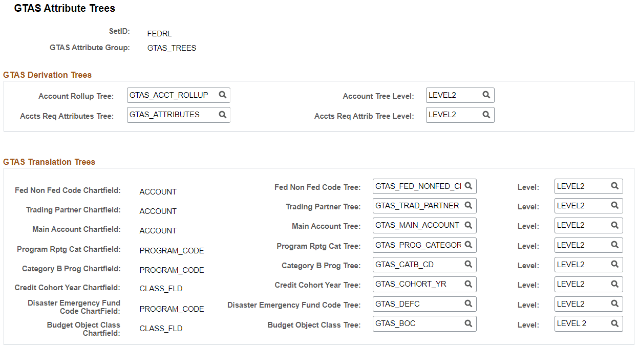

GTAS Attribute Trees Page
Use GTAS Attribute Trees page (GTAS_ATTR_ASSIGN) to define translation trees for ledger attributes as well as derivation trees for USSGL accounts. The tree level that you select should be the level of the values to be reported to the U.S. Treasury.
Navigation:
General Ledger, and then Federal Reports, and then GTAS Definition, and then Attribute Trees, and then GTAS Attribute Trees
This example illustrates the fields and controls on the GTAS Attribute Trees page.
GTAS Derivation Trees
The GTAS derivation trees are used to derive the required USSGL accounts for reporting and identify which USSGL accounts require attributes not assigned as PeopleSoft Account attributes (for example, Fund Attributes).
Account Rollup Tree and Account Tree Level
Select the GTAS Account Rollup Tree and Account Tree Level of the rollup nodes that you created for your organization. This enables agencies to continue to use 4-digit (or other length) accounts while translating them into the 6-digit USSGL accounts.
Accts Req Attributes Tree and Accts Req Attrib Tree Level
Select the GTAS Accounts Required for Attributes tree and associated Tree Level of the rollup nodes that you created for your organization.
If you have not performed the Tree TableSet Control steps, you may not be able to see your trees in the prompt list. See Configuring TableSet Controls for GTAS Processing.
GTAS Translation Trees
Use this section to specify the trees to derive the GTAS attribute value using the ChartField value obtained from the ledger.
(GTAS translation trees and associated tree levels)
Associate the appropriate tree names and the tree levels that you created for your organization with each of the GTAS attribute tree names. Note that the associated ChartField is derived from the GTAS Attribute Assignment Page.
If you will not report one of the attributes listed on this page, leave the tree name and level blank.

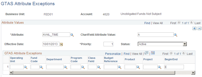

GTAS Attribute Exceptions Page
Use the GTAS Attribute Exceptions page (GTAS_CF_EXCEP) to derive attribute values by ChartField combination for the specified Account and Attribute. Define exceptions to the default values that you established on the GTAS ChartField Attribute page for Account, Fund, and Budget Reference. The values specified here override the defaults during processing as of the effective date. You can also use this page to override Ledger-assigned attributes.
Navigation:
General Ledger, and then Federal Reports, and then GTAS Definition, and then Define Attribute Exception
This example illustrates the fields and controls on the GTAS Attribute Exceptions page. You can find definitions for the fields and controls later on this page.
Business Unit
From the Add/Search page, select the GL business unit for which GTAS is run within the ledger. This value determines the available prompt values from the corresponding TableSet Controls that are defined for the business unit (Set Control Value) for the ChartFields in the grid.
Account
From the Add/Search page, select the agency account for which to associate the attributes and mapping.
Attribute
Select the Attribute for which to define the exceptions. All attributes that are defined on the Attribute Assignment page appear in this list.
ChartField Attribute Value
Select the attribute value for which the mapping in the grid applies. For ChartField attributes, only attribute values set up in ChartField attribute configuration appear in the list. However, you may manually enter other attribute values in the field and save, even if they are not in the prompt list for selection.
Effective Date
Select a date for which the exception is effective for processing. The GTAS Accumulation process compares this date to the last day of the From Period on the GTAS Accumulation run control to see if the exception applies.
Priority
List the priority order in which the program should assign attributes. This ordering applies to all ChartField combinations in the grid as well as to all values for the attribute.
Status
Indicates whether the effective dated row is Active or Inactive
Select the ChartField values that define the exception for this attribute value. You can enter a partial value using a wildcard (F1%, for Fund Code example) or leave the field blank to denote all values are selected.
The rows with the least amount of ChartFields are processed first, progressing to the most number of ChartFields (general to specific). The more specific rows override the more general rows. All attributes are available in the Attribute drop down list.
GTAS runs for one GL Business Unit at a time (specified on the run control) and as such will be used as part of the search key along with the Account for this page. The reason that GL Business Unit must be part of the key to this page is that each GL Business Unit could have different SetIDs for each of the ChartFields in the grid. The SetIDs defined in TableSet Control for the GL Business Unit are used to drive the prompts for all fields, including Account, on this page (see Configuring TableSet Controls for GTAS Processing.
The key fields are GL Business Unit, Account, Attribute, Effective Date, Status, and Attribute Value. When adding a new account on this page, you are prompted first for GL business unit, the selection of which will determine the SetID for Account as well as the other ChartFields in the grid based on TableSet Control.

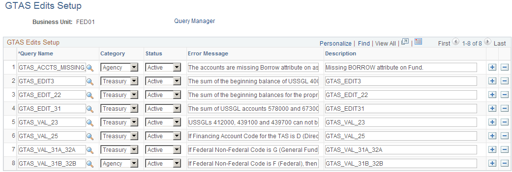

Use the GTAS Edits Setup page to include agency-defined queries in support of GTAS validations and edits. PeopleSoft delivers sample queries for this purpose but each agency is responsible for developing their own queries to support the desired GTAS edits and validations. The queries should be based on the GTAS Staging table and each TAS is run separately for each query by the GTAS validation process.
For more information regarding creating PeopleSoft queries, see PeopleTools: PeopleSoft Query.
Each edit or validation should be developed as a separate query with the results displaying staging table rows that are in error of the edit and validation that is being tested. You can create queries as desired for these edits and validations, configuring the PeopleSoft GTAS Edits Setup page to run them accordingly.
The list of required validations and edits can be found on Treasury’s website at Financial Management Service: GTAS Edits and Validations.
Each query must have prompts for Business Unit, Report ID, and TAS.
GTAS Edits Setup Page
Use the GTAS Edits Setup page (GTAS_EDITS) to configure the GTAS Edits for running queries in support of the GTAS edits. PeopleSoft delivers eight sample queries.
Navigation:
General Ledger, and then Federal Reports, and then GTAS Definition, and then Validation Edits, and then GTAS Edits Setup
This example illustrates the fields and controls on the GTAS Edits Setup page. You can find definitions for the fields and controls later on this page.
Business Unit (GL)
From the Add/Search page, select the General Ledger business unit for which to associate the entered edits and validations.
Edit #
Automatically assigned sequential number.
Query Name
Select the name of the query that is associated with the edit or validation.
Category
Select whether the edit is required by Treasury or by Agency (translate values).
Status
Indicates whether the edit is Active or Inactive.
If the edit is inactive, the GTAS Validate Data process does not run the edit.
Error Message
Enter a free form text error message to display on the error report.
Description
Enter a description of the edit or validation.
Insert Row or Delete Selected Row
Click to add a new row or delete the existing row.
Query Manager
Click this link to edit the query in Query Manager.

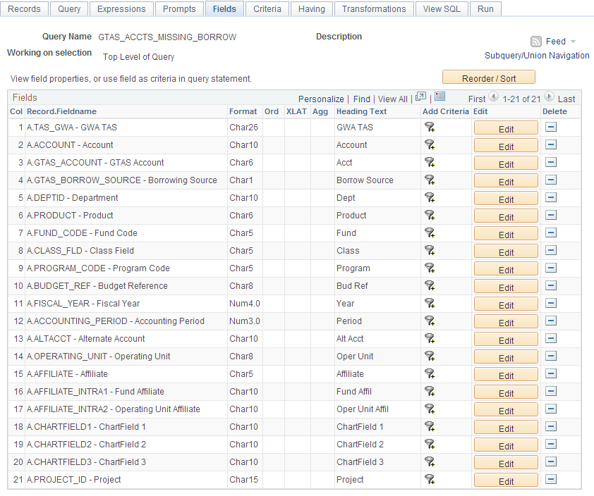

Example 35-6 Sample Query GTAS_ACCTS_MISSING_BORROW
The following presents a sample query, GTAS_ACCTS_MISSING_BORROW. The A record is GTAS_STG_DTL:
Navigation:
Reporting Tools, and then Query, and then Query Manager
Search for the GTAS_ACCTS_MISSING_BORROW query and select the Fields tab.
This example illustrates the fields and controls on the Sample Query GTAS_ACCTS_MISSING_BORROW.
The sample query uses the GTAS_STG_DETAIL record, which contains the fields as pictured. Select the Criteria tab to view the selection criteria for the query:

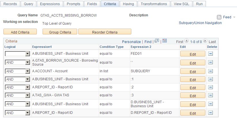

This example illustrates the fields and controls on the Sample GTAS_ACCTS_MISSING_BORROW Query - Criteria.
GTAS_ACCTS_MISSING_BORROW criteria
Subquery/Union Navigation
Click this link to access the delivered subquery (or create one) to join additional records for field selection. Select Subquery for Account.

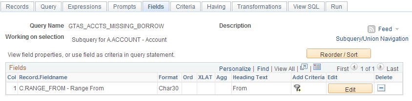

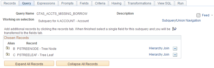

The following presents the Subquery for Account for the GTAS_ACCTS_MISSING_BORROW query. The subquery includes additional records (B and C) that are joined to the main record for the query for additional field selection.
Navigation:
Click the Subquery/Union Navigation link from the Query and select Subquery for Account.
This example illustrates the fields and controls on the Sample GTAS_ACCTS_MISSING_BORROW - Subquery for the Account field.
GTAS_ACCTS_MISSING_BORROW_subq
Click the Fields tab to view the field that was added from the joined record(s) for the subquery:
This example illustrates the additional record (record C) and fieldname (RANGE_FROM) and controls on the Sample GTAS_ACCTS_MISSING_BORROW - Subquery for the Account field - Fields page.
GTAS Sample Subquery for Accounts - Fields page
This example illustrates the joined fields and controls on the Sample GTAS_ACCTS_MISSING_BORROW - Subquery for the Account - Criteria page. View or edit the subquery criteria as needed:

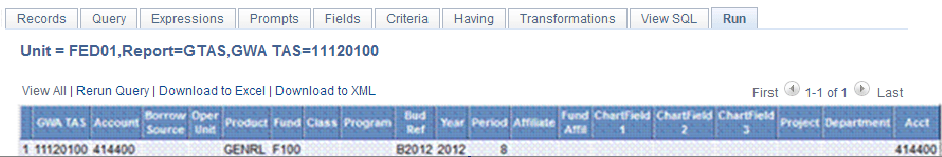

Click the Run tab to run the query and supply the required parameters for the prompts:
This example illustrates the fields and controls on the Sample Query - prompt upon clicking the Run tab.
GTAS Sample Query Run
Supply the prompt values and click OK for the query results:
This example illustrates the fields and controls on the GTAS Sample Query Result.
GTAS Sample Query Results
The GTAS ChartField Preferences page stores an agency’s preferences that determine which ChartFields are populated on the GTAS Staging Detail Table when the GTAS Accumulation process is run.
Use the GTAS ChartField Preferences page (GTAS_STG_DTL_CF) select the ChartFields to be included in the GTAS staging table (Workbench).
Navigation:
General Ledger, and then Federal Reports, and then GTAS Definition, and then Define GTAS CF Preferences
The ChartField Configuration processes (Standard and Advanced) affect the ChartFields that appear on this page.
This example illustrates the fields and controls on the GTAS ChartField Preferences page. You can find definitions for the fields and controls later on this page.
The ChartFields that you have defined within the GTAS Attribute Assignment Page are automatically selected and inactivated (required) on the GTAS ChartField Preferences page. Use this page to select any additional ChartFields to be populated in the GTAS staging detail table during the GTAS Accumulation process.
SetID
This is the SetID that is associated with the GTAS ChartField Configuration preferences. This field appears on the search pages with a magnifying glass to facilitate searching.
Field Name
ChartFields that can optionally be populated on the GTAS staging detail table during the GTAS Accumulation process.
Include in GTAS Staging
Select this check box to indicate that the ChartField should be populated on the GTAS Staging Detail table.
Add and Delete
Use to add and remove ChartFields for this page. This feature is useful after running ChartField Configuration since this page is not updated based on that process.
