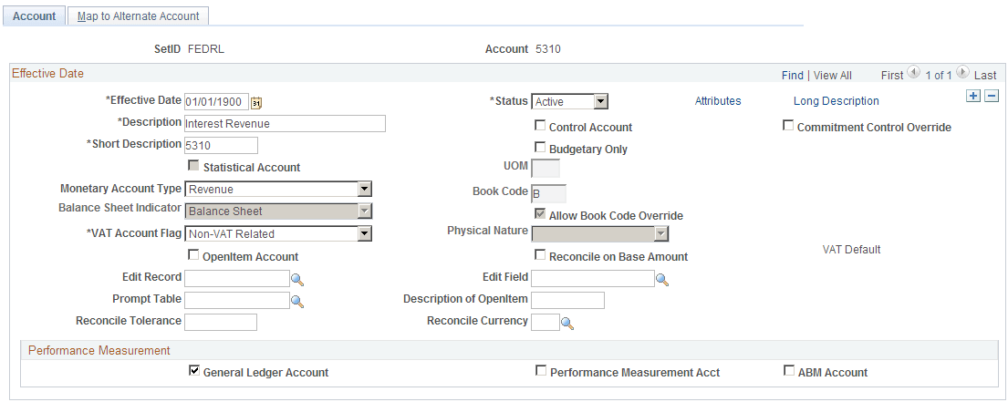

Application Fundamentals: Account Page
GL_ACCOUNT
Add the required accounts (or use the ACCOUNT_CF component interface to load all accounts at once.)

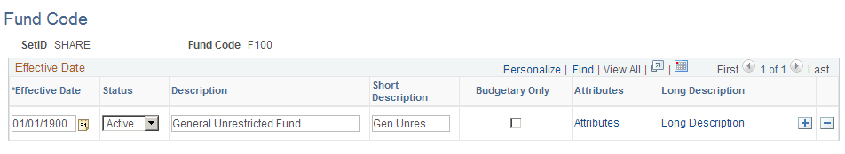

Application Fundamentals: Fund Code Page
FUND_DEFINITION
Access the Fund Code ChartField that you want to associate with selected FUND_CODE ChartField attributes.

Set Up Financials/Supply Chain, and then Common Definitions, and then Design ChartFields, and then Define Values, and then ChartField Values, and then Budget Reference

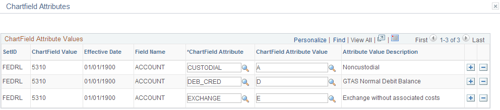

Application Fundamentals: ChartField Attributes Page
CF_ATTRIB_VALUES
Select ChartField attributes and attribute values to associate with the selected Fund Code, Account value, Budget Reference, or other ChartField value.

Verifying the GTAS ChartField Attributes
Each required USSGL account must be associated with the attributes as defined by the U.S. Treasury. PeopleSoft delivers GTAS attributes in a sample data script.
: PeopleSoft does not support any changes made to the required GTAS attributes. The delivered sample data script contains the Treasury attributes as of the time of this publication. Treasury attributes can change over time and each agency is responsible for keeping up with those changes.

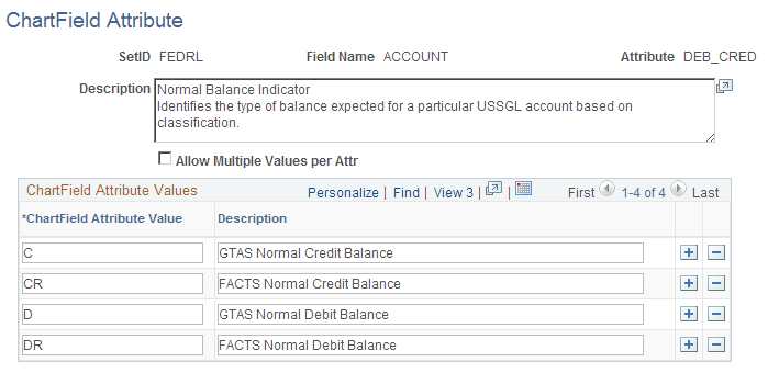

ChartField Attribute Page
Use the ChartField Attribute page (CF_ATTRIBUTES) to add or modify the ChartField attributes and attribute values as required by the U.S. Treasury.
Navigation:
Set Up Financials/Supply Chain, and then Common Definitions, and then Design ChartFields, and then Configure, and then Attributes, and then ChartField Attribute
This example illustrates the fields and controls on the ChartField Attribute page.
Field or Control Description
Field Name
Select the ChartField to which the attribute should be assigned.
Attribute
Enter a meaningful name for the attribute.
Description
Enter a description of the attribute. You can also add a detailed description of the purpose of this attribute.
Allow Multiple Values per Attr (allow multiple values per attribute)
Select if multiple values for the attribute are allowed for a unique ChartField value. (This is deselected for most of the attributes).
ChartField Attribute Value
Enter the domain values for the attribute as defined by Treasury.
Description
Enter a description of the domain values.

Setting Up or Modifying Accounts for USSGL Rollup and Linking Associated Attributes
Use the Account page (GL_ACCOUNT) to set up or modify accounts to use as required by the U. S. Treasury. You can access a complete listing of the accounts required for GTAS reporting along with their required attributes as defined by Treasury on the Treasury’s website.
PeopleSoft provides a translation account tree to enable agencies to record transactions using their agency GL accounts and report to GTAS using 6-digit GTAS USSGL accounts. Attributes are required for the accounts that are included in this tree for translation.
See Using Trees to Control Rollup of GTAS ChartField Data and Creating the GTAS Account Rollup Tree.
Navigation:
Set Up Financials/Supply Chain, and then Common Definitions, and then Design ChartFields, and then Define Values, and then ChartField Values, and then Account
This example illustrates the fields and controls on the Account page. You can find definitions for the fields and controls later on this page.
Account page - GTAS example
Attributes
Click this link to associate the ChartField attributes that you set up for GTAS with the appropriate Account value (or Fund Code ChartField value on the Fund Code page or Budget Reference ChartField value on the Budget Reference page) that is required for GTAS reporting.
See Application Fundamentals: Adding and Mapping Accounts and Alternate Accounts.
For more information on setting up ChartFields (Accounts, Fund Codes, and so on), see Application Fundamentals: Understanding PeopleSoft ChartFields.
Use the ChartField Attributes page (CF_ATTRIB_VALUES) to select ChartField attributes and attribute values to associate with the selected Fund Code, Account value, Budget Reference, or other ChartField value.
Navigation:
From the Account page (or other ChartField entry page), click the Attributes link.
This example illustrates the fields and controls on the ChartField Attributes page.
ChartField Attributes page - Account field GTAS example
After clicking the Attributes link from the Account page, you are directed to the ChartField Attributes page for this ChartField value (Account 5310 in this example). You can click the Attributes link from any ChartField value page (Fund Code, for example) and associate Attributes and Attribute values to the ChartField value.
Select the appropriate ChartField attribute(s) for this ChartField Value.
Select the ChartField attribute domain value to be associated with the ChartField. This value is the default and can be overridden by values on the GTAS Attribute Exceptions page.
If the attribute has values on the GTAS Attribute Exceptions page, the value specified on the ChartField Assignment page is a default and will be overridden for ChartField combinations that are specified on the Attribute Exceptions page.
Setting up GTAS Fund Codes, Budget References, or Other ChartFields and Linking Associated Attributes
Use the Fund Code page (FUND_DEFINITION) to define values for all types of funds. Associate the Funds Codes with selected ChartField attributes.
Navigation:
Set Up Financials/Supply Chain, and then Common Definitions, and then Design ChartFields, and then Define Values, and then ChartField Values, and then Fund Code
This example illustrates the fields and controls on the Fund Code page.
Fund Code page
Add the necessary Fund Codes. Click the Attributes link to associate attributes and values with the Fund Code.
You can also use the FUND_CF component interface to load data into the tables for the Fund Code component
See Application Fundamentals: Fund Code Page
