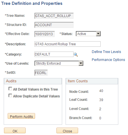

When adding a new tree, you are presented with the Tree Definition and Properties page. Be sure that this tree is based on the Account ChartField (select Structure ID = ACCOUNT):
This example illustrates the fields and controls on the GTAS Account Rollup Tree - Tree Definition and Properties page. You can find definitions for the fields and controls later on this page.
GTAS_ACCT_ROLLUP Tree Definition page

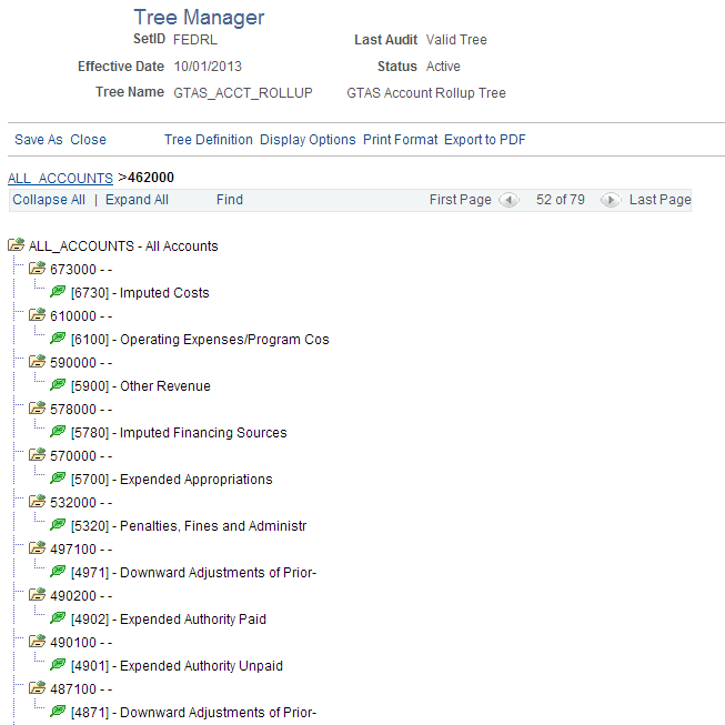

Example 35-1 Sample GTAS Account Rollup Tree
This example illustrates the fields and controls on the Sample GTAS Account Rollup Tree:
Your agency can use any tree and level names as long as you specify these names on the GTAS Attribute Trees page. You must create the GTAS Account Rollup Tree to run the Accumulate GTAS Data process even if your agency uses the 6-digit USSGL accounts as the process uses this tree to determine which GL accounts are subject to GTAS reporting.

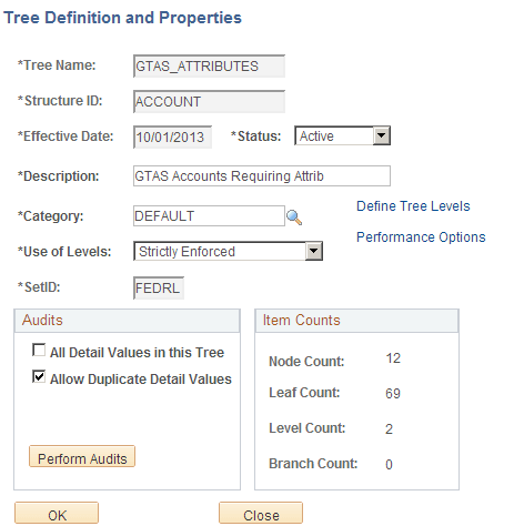

Enter the tree name, (GTAS_ATTRIBUTES, in this example) and click the Add button.
Enter a tree name and click the Add button. When adding a new tree, you are presented with the Tree Definition and Properties page: Be sure that this tree is based on the Account ChartField (select Structure ID = ACCOUNT) and select to allow duplicate detail values. Complete the page as follows:
This example illustrates the fields and controls on the Sample GTAS_ATTRIBUTES - Tree Definition and Properties page. You can find definitions for the fields and controls later on this page.
GTAS_ATTRIBUTES Tree Definition

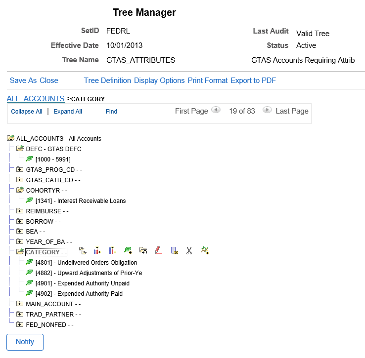

The following presents an example of the Accounts Requiring Attributes tree:
Example 35-2 Sample Accounts Requiring Attributes Tree
This example illustrates the fields and controls on the Sample Accounts Requiring Attributes Tree. You can find definitions for the fields and controls later on this page.
Tree Manager page
The Accounts Requiring Attributes tree stores the relationship between the ChartField attributes that are required for GTAS processing and their associated USSGL accounts.
This tree filters out the attributes for accounts that do not require certain attributes to be reported. After the GTAS Accumulation process accumulates all the attribute data, it checks the accumulated attributes against this tree to determine whether they are required to be reported. If the attribute is not required, it is removed from the staging table and is not included in the GTAS file. To determine the attributes to be reported for any given account, the program takes the agency account from the ledger (such as 4119) and searches for the account in the GTAS_ATTRIBUTES tree. The account may appear under numerous nodes depending on which attributes are required for that specific agency account. Wherever the program finds the agency account in the tree, the attribute is considered as required for reporting. If the program has previously accumulated an attribute value for the account, but is unable to locate the account under that respective attribute's node, the accumulated attribute value will be excluded from the GTAS file.
The U.S. Treasury's USSGL Account Attributes Required for GTAS Reporting of Detailed Financial Information defines these rules. This information is available at the U.S. Treasury Department's website. Build this tree using agency accounts (not necessarily USSGL accounts).

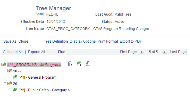

Creating the GTAS Program Reporting Category Tree
The purpose of this tree is to translate the Program Reporting Code values (as indicated on the GTAS Attribute Assignment page) to the values required by Treasury. The PRC is a Ledger Attribute that is associated with a ChartField from which to determine its value using the GTAS Attribute Assignment page.
The Office of Management and Budgets (OMB) supplies and requires the input of Program Reporting Categories for apportioned funds when a USSGL account contains a Y in the Program Rpt Code (program reporting code) column of the Fiscal 20XX USSGL Account Attributes Required Table (http://www.fms.treas.gov/gtas/bulk-file.html). The OMB provides valid Program Reporting Categories from which Federal Program Agencies (FPAs) can choose. The OMB list of Program Reporting Categories serves as a control table or as a reference table for GTAS reporting. FPAs cannot use the OMB-supplied program reporting numbers with the FPA titles. The FPA is also restricted by GTAS from using the default program number and description, 99 All Programs, with other OMB program codes and descriptions or the custom program codes and descriptions of the FPA.
If OMB does not provide specific program reporting categories, then the FPA can use the default program reporting number (99) and description (All Programs). While an FPA can use numbers and descriptions for program reporting categories in addition to those that are supplied by the OMB, they cannot use the 99 All Programs program reporting category with any other codes. If the FPA attempts to add the 99 All Programs category to existing program reporting categories for obligation activity, the GTAS rejects that input because the 99 All Programs category can only be used by itself.
You can use any tree name and level name as long as you specify the desired tree name and level name on the GTAS Attribute Trees Page. This tree is required for the Accumulate GTAS Data process (GLS8302). Following is an example of the GTAS Program Reporting Category tree:
This example illustrates the fields and controls on the GTAS Program Reporting Category tree.

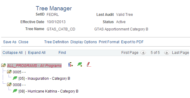

The following is an example of the GTAS Category B Code Translation tree.

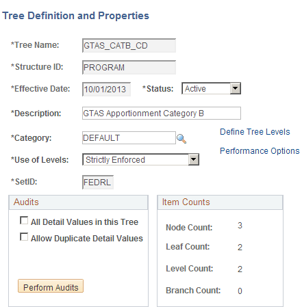

Access the Tree Definition and Properties page. The Structure ID in this example is PROGRAM and is the ChartField that is selected on the GTAS Attribute Assignment page.
Navigation:
Tree Manager, and then Tree Manager, and then Create New Tree, and then Tree Definition and Properties
Enter the tree name, (GTAS_ATTRIBUTES, in this example) and click the Add button (if adding the tree).
This example illustrates the fields and controls on the GTAS Apportionment Category B Program Code Tree - Tree Definition and Properties page.
GTAS Category B Tree Definition
Example 35-3 Sample GTAS Apportionment Category B Program Code Tree
The following tree is delivered in sample data:
This example illustrates the fields and controls on the GTAS Apportionment Category B Program Code Tree.
GTAS Apportionment Category B Tree

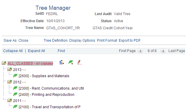

The following is an example of the GTAS Credit Cohort Year Tree. The Structure ID in this example is CLASS_DTL since the Class Field was selected on the GTAS Attribute Assignment page.
Be sure that you have set up all the required ChartField values before you create this tree.
Example 35-4 Sample GTAS Credit Cohort Year Tree
Create a Cohort Year tree with the nodes for each cohort year based on the reporting needs of your agency. Enter the appropriate detail values that identify which ChartField values (loans) roll up to a particular cohort year. The GTAS bulk file requires a four-character Cohort Year.
This example illustrates the fields and controls on the Sample GTAS Credit Cohort Year Tree.
GTAS Cohort Year Tree
The Accumulate GTAS Data process uses this tree to identify ChartField values that represent loans associated with a cohort year for the production of the GTAS Treasury input file. You may also use a different configurable ChartField besides CLASS for this purpose. Because an agency may have projects that are not loans and are not associated with a cohort year, this tree is used to distinguish between the two types of project ChartField values. Each agency should determine the ChartField structure that it needs to satisfy its cohort year requirements.
If your agency does not use Cohort Year, do not create this tree and leave the tree name and level blank on the GTAS Attribute Trees page. See GTAS Attribute Trees Page.

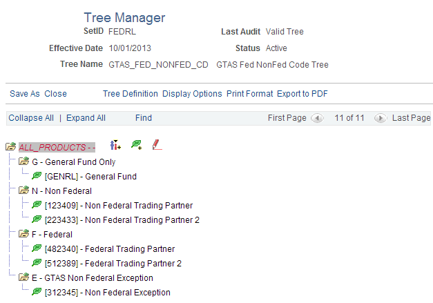

Creating the GTAS Fed Non Fed Code Tree
The purpose of this tree is to map the values in the field defined for Fed Non Fed Code (specified on the GTAS Attribute Assignment Page) to the values required for GTAS reporting for Fed Non Fed Code. The Fed Non Fed Code is a Ledger Attribute that is associated with a ChartField from which to determine its value using the GTAS Attribute Assignment page.
This tree does not denote which accounts require Federal Non Federal Code as this is contained in the Creating the GTAS Accounts Requiring Attributes Tree topic.
The following is a partial example of a GTAS Fed Non Fed Code tree. For this example, this tree is based on the Product ChartField (Structure ID = PRODUCT on the Tree Definition and Properties page:
Example 35-5 Sample GTAS Fed Non Fed Code Tree
This example illustrates the fields and controls on the Sample GTAS Fed Non Fed Code Tree.
GTAS Fed NonFed Code Tree
This tree translates Product into the appropriate Fed Non Fed Code for use on the GTAS bulk file. The ChartField used for Fed Non Fed Code can be the same as Trading Partner and Main Account. See Configuring GTAS Attribute Assignments.

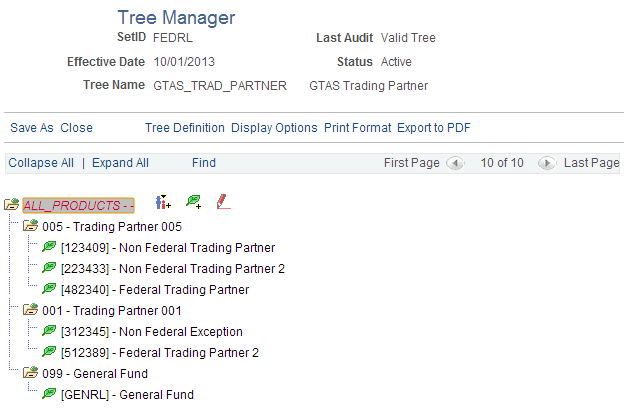

Creating the GTAS Trading Partner Tree
This tree translates the values in the field defined for Trading Partner (specified on the GTAS Attribute Assignment Page to the values required for GTAS reporting for Trading Partner. Trading Partner is a Ledger Attribute that is associated with a ChartField from which to determine its value using the GTAS Attribute Assignment page.
This tree does not denote which accounts require Trading Partner as this is contained in the GTAS Attribute Trees Page
This example illustrates the fields and controls on the Sample GTAS Trading Partner Tree.
Since the PeopleSoft ChartField that is designated for Trading Partner is the Product field in this example (as defined on the Attribute Assignment page), this tree is based on the Product ChartField for this example. Make sure that the Structure ID on the Tree Definition and Properties page is PRODUCT (or whatever ChartField that you defined on the Attribute Assignment page for the Trading Partner).

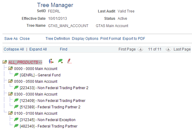

Creating the GTAS Main Account Tree
This tree translates the values in the field defined for Main Account (specified on the GTAS Attribute Assignment Page) to the values required for creating the GTAS bulk file and reporting for Main Account. The Main Account is a Ledger Attribute that is associated with a ChartField from which to determine its value using the GTAS Attribute Assignment page. It can be based on the same ChartField as the Fed Non Fed Code and Trading Partner.
This tree does not denote which accounts require Main Account as this is contained in the Accounts Requiring Attributes tree.
This example illustrates the fields and controls on the Sample GTAS Main Account Tree.
Since the PeopleSoft ChartField designated for Main Account is the Product field for this example (as defined on the GTAS Attribute Assignment Page), this tree should be based on the Product ChartField. For this example make sure that the Structure ID on the Tree Definition and Properties page is PRODUCT.
If your agency is not using the Main Account (for example, in the first year), do not create this tree and leave the tree name and level blank on the GTAS Attribute Trees page. See GTAS Attribute Trees Page.

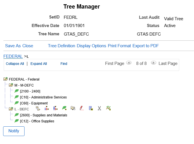

Creating the GTAS Disaster Emergency Fund Code Tree
This tree translates the values in the field defined for Disaster Emergency Fund Code (specified in the GTAS Attribute Assignment Page to the values required for GTAS reporting for DEFC.
This example illustrates the fields and controls on the Sample GTAS DEFC Tree.
