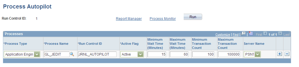

This example illustrates the fields and controls on the Process Autopilot page. You can find definitions for the fields and controls later on this page.
Field or Control Description
Process Type
Select Application Engine for journal edit and COBOL SQL for journal post.
Process Name
Enter the process to run. Journal edit and journal post are available for general ledger.
Active Flag
Select Active to enable the process.
Select Disable to disable an individual process even after Autopilot has started.
Minimum Wait Time
Enter the minimum number of minutes that must elapse between processing runs.
Maximum Wait Time
Enter the maximum amount of minutes that can elapse between process runs, regardless of whether the Minimum Transaction Count parameter is satisfied.
Enter the fewest number of transactions that must be present for processing to occur, unless the Maximum Wait Time parameter is surpassed.
Maximum Transaction Count
Enter the maximum number of transactions that can be processed. If the amount of transactions waiting to be processed exceeds this amount, the process will not run in Autopilot regardless of the other settings.
