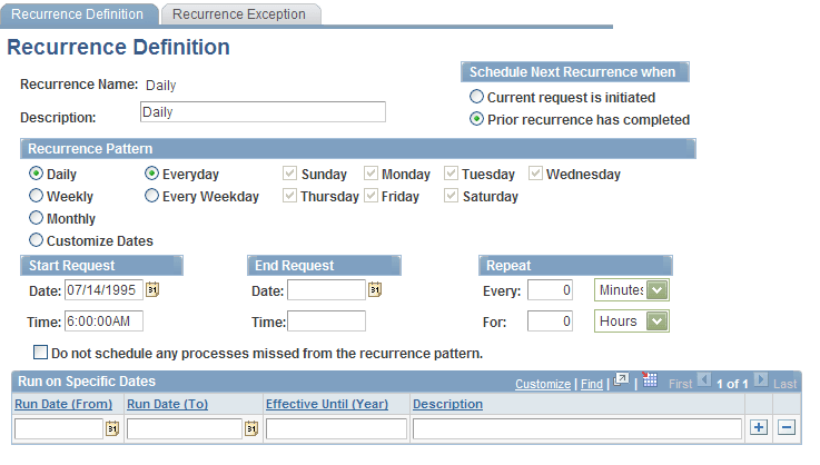

Create a recurrence definition for scheduling the Autopilot process.
Recurrence Definition Page
Use the Recurrence Definition page (PRCSRECURDEFN) for creating a schedule for the Autopilot process.
Navigation:
PeopleTools, Process Scheduler, Recurrences, Recurrence Definition
This example illustrates the fields and controls on the Recurrence Definition page. You can find definitions for the fields and controls later on this page.
The Autopilot process must be scheduled as a recurring process in the Process Scheduler and the wait time for recurrence must be equal to or less than the minimum wait time specified for the batch process. If there is more than one row in the run control, the recurrence time for the Autopilot process must be equal to or less than the smallest minimum wait time in the run control.
