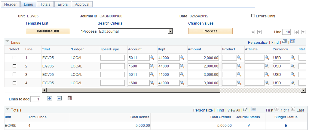

To override budget journal errors, Access the Journal Entry - Lines page (General Ledger, and then Journals, and then Journal Entry, and then Create/Update Journal Entries, and then Lines).
This example illustrates the fields and controls on the Journal Entry - Lines page (Budget Status Error). You can find definitions for the fields and controls later on this page.
Journal Entry - Lines page (Budget Status - Error)
Click the Budget Status field value to open the GL Journal Exceptions page to override the budget transaction in error and view details about the source transaction.
You must have authority to override budget checking.
See PeopleSoft Commitment Control: Commitment Control Budget Exceptions Page.
