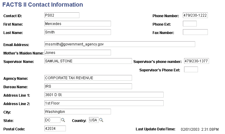

FACTS II Contact Information
F2_CONTACT_INFO
Contains contact information about the person or persons who are responsible for preparing and certifying FACTS II data for each of the appropriations and sending it to the U.S. Treasury in the Preparer file. Only preparers may change an appropriation symbol's SGL accounts or other related information.

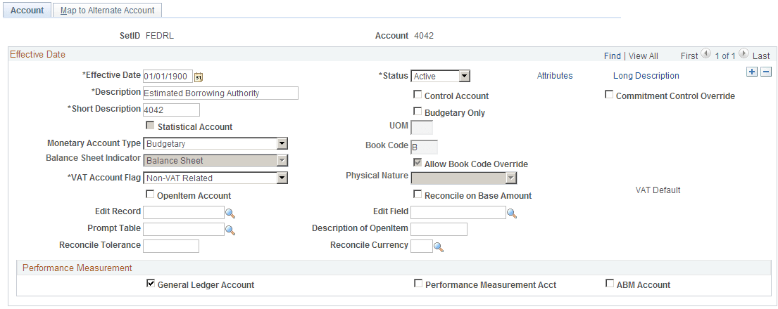

ChartField Values - Account Page
GL_ACCOUNT
Access the Account ChartField to associate with ACCOUNT ChartField attributes.

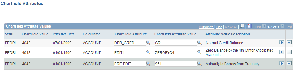

ChartField Attributes Page
CF_ATTRIB_VALUES
Select the ChartField attributes to associate with the selected ChartField value.

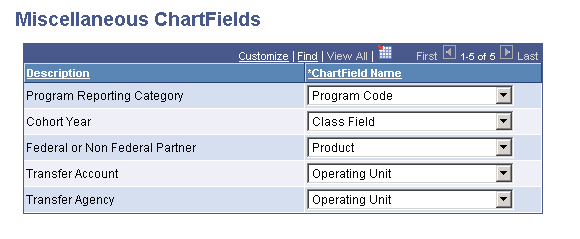

Miscellaneous ChartFields Page
F2_ELEMENT_CF1
Select ChartFields to use for recording Program Reporting Category, Cohort Year, Transfer Agency, Transfer Account, and Transaction Partner information.

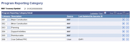

Program Reporting Category Page
F2_PROG_RPT_CAT
Maintain PRC codes by MAF Treasury Symbol. Identify the origin of the PRCs as either resulting from user-defined values or values downloaded from a MAF file.

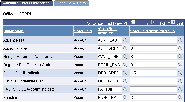

Attribute Cross Reference Page
F2_ATTR_XREF
Enables each agency to decide on the names of the fund and account attributes to be used in FACTS II processing. Each agency can either create its own names or use the names that are presented in this documentation.

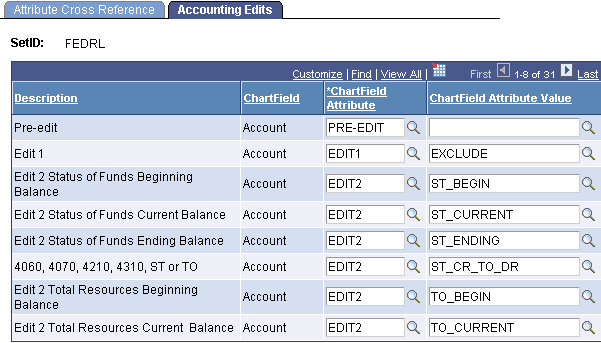

Accounting Edits Page
F2_ATTR_XREF_EDIT
Specify the ChartField Attributes and Attribute values that are applicable to the accounting edits.

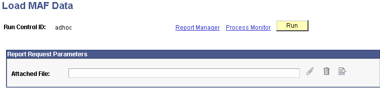

Load MAF Data Page
F2_RUN_MAF
Load the MAF data from a file that is sent by the U.S. Treasury to the government agency to review in PeopleSoft General Ledger.

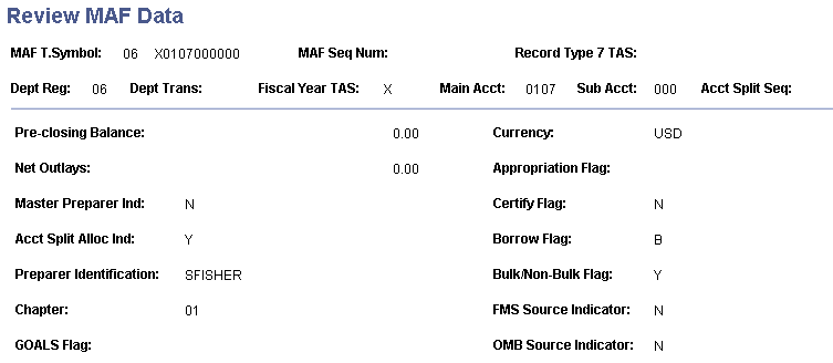

Review the MAF Data Page
F2_MAF_INQUIRY
Review the MAF data that is sent by the U.S. Treasury based on a selected MAF Treasury Symbol. Add, review, and MAF data.

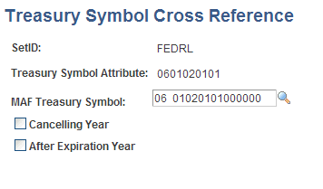

Treasury Symbol Cross References Page
F2_TSYM_XREF
Select the Treasury Symbol attribute that corresponds to the Treasury Symbol that is included in the MAF.
Use the FACTS II Contact Information page (F2_CONTACT_INFO) to contains contact information about the person or persons who are responsible for preparing and certifying FACTS II data for each of the appropriations and sending it to the U. S. Treasury in the Preparer file. Only preparers may change an appropriation symbol's SGL accounts or other related information.
Navigation:
General Ledger, Federal Reports, FACTS II Definition, FACTS II Contact Information, FACTS II Contact Information
This example illustrates the fields and controls on the FACTS II Contact Information page . You can find definitions for the fields and controls later on this page.
<being replaced by GTAS functionality> FACTS II Contact Information page
Field or Control Description
Contact ID
Enter a U.S. Treasury ID number to add or modify information about your agency's FACTS II contact personnel.
First Name and Last Name
Enter the first and last names of the FACTS II preparer.
Phone Number, Phone Ext, Fax Number, and Email Address
Enter the telephone number, phone extension, fax number, and email address of the preparer.
Mother's Maiden Name
For security purposes, enter the maiden name of the preparer's mother.
Supervisor Name, Supervisor's phone number, and Supervisor's Phone Ext.
Enter the name, phone number, and phone extension of the preparer's supervisor.
Agency Name
Enter the name of the agency that is responsible for submitting FACTS II data.
Bureau Name
If the FACTS II data represents a bureau or division of the agency, enter that name.
Address Line 1, Address Line 2, City, State, Country, and Postal Code
Enter the agency's street address (the second line is for information such as building or suite number), city, state, country, and postal code.
Last Update Date/Time
Each time you save this record, this field is updated.

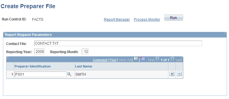

Create Preparer File Page
Use the Create Preparer File page (F2_RUN_CONTACT) to runs the Application Engine GL_F2 CONTACT, which creates the Contact Information Record and Contact Information Record Trailer (Input) record in the indicated input file and creates an output flat file to send to the U. S. Treasury.
Navigation:
General Ledger, and then Federal Reports, and then FACTS II Creation, and then Create Preparer File
This example illustrates the fields and controls on the FACTS II - Create Preparer File page. You can find definitions for the fields and controls later on this page.
Contact File
Enter a contact file name with a .TXT extension. Do not enter the entire path.
Reporting Year and Reporting Month
Enter the year and month for this FACT II submission.
Preparer Identification
Select the preparer's identification number. You can select more than one.
Run
Click to access the Process Scheduler Request page to run the Create FACTS Preparer File process (GL_F2CONTACT).

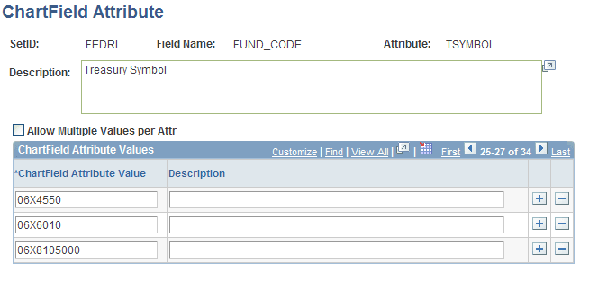

ChartField Attribute Page
Use the Attributes - ChartField Attribute page (CF_ATTRIBUTES) to enter the Fund Code and Account ChartField attributes and attribute values.
Navigation:
Set Up Financials/Supply Chain, Common Definitions, Design ChartFields, Configure, Attributes, ChartField Attributes, ChartField Attribute
You can also use ChartField Attributes for non-FACTS II purposes.
This example illustrates the fields and controls on the Attributes - ChartField Attribute page. You can find definitions for the fields and controls later on this page.
Most field values on this page are based on the ChartField Attributes table that follows the field descriptions for this page.
Important:
FACTS I and FACTS II rely on only one attribute being associated with each respective ChartField. The option to allow multiple values per attribute should not be used with FACTS I and FACTS II attributes.
SetID
Displays the SetID that is set up for your FACTS II data. ChartField attributes are based on a SetID so that they can be associated with more than one ChartField.
Field Name
Enter the type of ChartField that each ChartField attribute applies to. Values are FUND_CODE and ACCOUNT and are based on the ChartField Attribute table.
Attribute
Enter a ChartField attribute from the ChartField table or define your own attribute names for your organization. These names and values are associated with the ChartField names and values that are required by the U.S. Treasury on the Attribute Cross Reference page.
Description
Enter the description of this ChartField attribute from the ChartField Attributes table or create your own description.
Allow Multiple Values per Attr (allow multiple values per attribute)
Note: Do not select this check box for FACTS I or FACTS II ChartField attributes.
ChartField Attribute Value
Enter each attribute value from the ChartField Attributes table or define your own values.
Description
Enter the description of each attribute value from the ChartField Attributes table or create your own description.

FUND_CODE
EX_UNEXP
Expired or unexpired authority
This check box should NOT be selected.
E (Expired Authority)
U (Unexpired Authority)
Note: These are Treasury values.
FUND_CODE
REIMBURSE
Funding authority indicator
D (Direct Authority)
R (Reimbursable Authority)
FUND_CODE
TSYMBOL
Treasury Symbol
Each agency enters its own Treasury Symbol values and descriptions.
Example:
19X0192 (No Year Revolving Fund) 19X0202 (No-Year Fund)
BUDGET_REF
YR_OF_BA
Year of Budget Authority
BAL (Outlay from balances that are brought forward from previous year.)
NEW (Outlays from new Budget Authority.)
Use the ChartField Values - Account page (GL_ACCOUNT), for example, to access the Account ChartField to associate with ACCOUNT ChartField attributes.
Use a ChartField such as Account, Fund Code, or Budget Reference that requires attributes.
Navigation:
Set Up Financials/Supply Chain, and then Common Definitions, and then Design ChartFields, and then Define Values, and then ChartField Values, and then Account
This example illustrates the fields and controls on the ChartField Values - Account page. You can find definitions for the fields and controls later on this page.
Attributes
Click this link to associate the ChartField attributes that you set up for FACTS II with the appropriate Account value (or Fund Code ChartField value on the Fund Code page or Budget Reference ChartField value on the Budget Reference page) that is required for FACTS II reporting.
Use the ChartField Attributes page (CF_ATTRIB_VALUES) to select the ChartField attributes to associate with the selected ChartField value.
Navigation:
Click the Attributes link on an Account or Fund Code page.
This example illustrates the fields and controls on the ChartField Attributes page. You can find definitions for the fields and controls later on this page.
After selecting the Attributes link, a row that contains values for SetID, ChartField Value, Effective Date, and Field Name appears.
Select the appropriate ChartField attribute for this ChartField Value.
Select the ChartField attribute value for this ChartField attribute. You can add as many rows as needed of ChartField attributes and ChartField attribute values for the selected ChartField value (in this example, Account 4042).
Use the Miscellaneous ChartFields page (F2_ELEMENT_CF1) to select ChartFields to use for recording Program Reporting Category, Cohort Year, Transfer Agency, Transfer Account, and Transaction Partner information.
Navigation:
General Ledger, and then Federal Reports, and then FACTS II Definition, and then Define FACTS II Misc CF
This example illustrates the fields and controls on the Miscellaneous ChartFields page. You can find definitions for the fields and controls later on this page.
(replaced by GTAS) Miscellaneous ChartFields page
You can change the delivered ChartField specifications to any configurable ChartField. For example, the FACTS II Data Element FED_NONFED is associated with Transaction Partner. You can change this to any other configurable ChartField. However, you must use different ChartFields for each of the FACTS II Data Elements. The exceptions to this rule are the ChartFields for Transfer Account and Transfer Agency. They can use the same configurable ChartField or two different ChartFields. In this example, Trading Partner is associated with both of these FACTS II Data Elements. Your decision to use either a single ChartField for Transfer Agency and Transfer Account or separate ChartFields has an effect on how you will enter data into your ledger. Some of these ChartField names are the result of a ChartField configuration.
Description
The PeopleSoft application predefines theProgram Reporting Category Cohort year, Federal or Non Federal Partner, Transfer Account, and Transfer Agency data elements and descriptions.
ChartField Name
Select a configurable ChartField for each FACTS II Data Element. Because Transfer Agency and Transfer Account are related, you can assign the same configurable ChartField to them, if you want, or set them up with separate configurable ChartFields. All other FACTS II data elements must be associated with different configurable ChartFields.
Use the Program Reporting Category page (F2_PROG_RPT_CAT) to maintain PRC codes by MAF Treasury Symbol.
Navigation:
General Ledger, and then Federal Reports, and then FACTS II Definition, and then Program Reporting Category, and then Program Reporting Category
This example illustrates the fields and controls on the Program Reporting Category page. You can find definitions for the fields and controls later on this page.
Enter a MAF Treasury Symbol and view its existing PRC codes and the descriptions that you downloaded from a MAF or that you manually entered using this page.
Category
Valid PRC values are 001 to 999.
Description
The description can vary for a Category depending on the MAF Treasury Symbol.
Source
Identifies the origin of a FACTS II Program Reporting Category as user-defined values or as values downloaded from a MAF file.
Last Updated By Operator ID
Identifies the operator ID that last manually entered or modified a PRC code value or description.
Use the Attribute Cross Reference page (F2_ATTR_XREF) to enables each agency to decide on the names of the fund and account attributes to be used in FACTS II processing.
Navigation:
General Ledger, and then Federal Reports, and then FACTS II Definition, and then Attribute Cross Reference, and then Attribute Cross Reference
Existing customers who are implementing this enhancement should reopen the Attribute Cross Reference and Accounting Edits pages and enter the ChartField Attribute names for the new data elements that are introduced by this enhancement.
This example illustrates the fields and controls on the FACTS II - Attribute Cross Reference page. You can find definitions for the fields and controls later on this page.
Description
These are the predefined attributes that the FACTS II processes requirements of the U.S. Treasury.
ChartField
The PeopleSoft application predefines the Field Name for ACCOUNT, FUND_CODE. and BUDGET_REF.
ChartField Attribute and ChartField Attribute Value
Select the ChartField attributes and attribute values that you defined as cross-references to each data element.
Note: The values selected are only examples.
Use the Accounting Edits page (F2_ATTR_XREF_EDIT) to specify the ChartField Attributes and Attribute values that are applicable to the accounting edits.
Navigation:
Click the Accounting Edits tab on the Attributes Cross Reference page.
This example illustrates the fields and controls on the Accounting Edits page. You can find definitions for the fields and controls later on this page.
Select the attributes and attribute values that you defined to cross-reference each of the predefined data elements that is listed on this page.
Refer to Review FACT II Data, Detail Attributes to review attributes for each ChartField value for a selected business unit and period.
Load MAF Data Page
Use the Load MAF Data (load master account file data) page (F2_RUN_MAF) to load the MAF data from a file that is sent by the U. S. Treasury to the government agency to review in PeopleSoft General Ledger.
Navigation:
General Ledger, and then Federal Reports, and then FACTS II Creation, and then Load MAF Data
This example illustrates the fields and controls on the Load MAF Data page. You can find definitions for the fields and controls later on this page.
Load MAF Data page
Add Attachment
Click the Add Attachment button and type the path and file name, or click the Browse button to navigate to the MAF location. Click the Upload button to store the file as an attachment. The file name appears in the Attached File field.
At the beginning of each fiscal year, the U.S. Treasury sends a MAF containing the U.S. Treasury account fund symbols (TAFS) for a specific agency along with the preparer and certifier IDs for each symbol.
With this data, the U.S. Treasury sends a spreadsheet containing the attributes for each SGL account. You can use this spreadsheet to validate that your data is set up correctly.
Run
Click to upload the file using the PS/GL MAF Load (F2_MAF_LOAD) process. This process loads the date from the file to the appropriate database table.
The Add, Delete, and View Attachment buttons work the same way as they do for FACTS I.
Use the Review MAF Data page (F2_MAF_INQUIRY) to review the MAF data that is sent by the U. S. Treasury based on a selected MAF Treasury Symbol. Add, review, and MAF data.
Navigation:
General Ledger, and then Federal Reports, and then FACTS II Review, and then Review MAF Data
This example illustrates the fields and controls on the Review MAF Data page. You can find definitions for the fields and controls later on this page.
MAF T.Symbol (master accounting file treasury symbol)
Stores the Treasury Symbol in the format that is defined by the U.S. Treasury for FACTS II processing. This Treasury Symbol is different from the Treasury Symbol format that is required by most other U.S. Treasury reporting.
MAF Seq Num (master accounting file sequence number)
The U.S. Treasury supplies this number. If the U.S. Treasury sends the agency a new MAF file, this number is increased incrementally.
Record Type 7 TAS (record type 7 treasury appropriation fund symbol)
The application displays a three-digit numeric code that is attached to the end of the Treasury Appropriation Fund Symbol. This code identifies the type of fund resources, such as Fund Held Outside of the Treasury, Authority to Borrow from the Treasury, and Unrealized Discounts.
Dept Reg (department regular)
Displays a regular (versus a transfer) department number that is associated with this MAF Treasury Symbol.
Dept Trans (department transfer)
Displays a transfer (versus a regular) department number that is associated with this MAF Treasury Symbol.
Fiscal Year TAS (fiscal year treasury appropriation fund symbol)
Displays the funding period of the appropriation that applies to this MAF Treasury Symbol.
Main Acct (main account)
Displays the main account that is used for this MAF Treasury Symbol.
Sub Acct (sub account)
Displays a sub account that is used for this MAF Treasury Symbol.
Acct Split Seq (account split sequence)
Displays the account split that is provided by the Office of Management and Budget interface file. Any number that is greater than 000 is an account split.
Pre-closing Balance
Displays the remaining appropriation balance for this department prior to the close of the fiscal year.
Net Outlays
Displays the net collections and disbursements that are reported to date to the U.S. Treasury by this department for the current fiscal year.
Master Preparer Ind (master preparer indicator)
Identifies whether a master preparer is required. This value is only necessary if an account split applies to this account.
Acct Split Alloc Ind (account split allocation indicator)
Indicates whether the master preparer divided the account balance among the members of an account split.
Displays the FACTS II preparer's name for this department.
Chapter
Displays the chapter number that is used in the U.S. Treasury's Annual Report.
GOALS Flag (Government Online Accounting Link System flag)
Indicates that the FACTS II file can be imported to the Government Online Accounting Link System (GOALS).
Appropriation Flag
Indicates that an appropriation is associated with this MAF Treasury Symbol.
Certify Flag
Indicates whether this MAF Treasury Symbol is required by the Budget Reports Branch of the Financial Management Service.
Borrow Flag
Indicates whether a borrowing source is required for this MAF Treasury Symbol.
Bulk/Non-Bulk Flag
Y indicates that you want to send the FACTS II information in a bulk transfer file. N indicates that you want to send the FACTS II information in a non-bulk transfer file.
FMS Source Indicator (Financial Management Services source indicator)
The FMS interface indicator.
OMB Source Indicator (Office of Management and Budget source indicator)
The OMB interface indicator.
Use the Treasury Symbol Cross Reference page (F2_TSYM_XREF) to select the Treasury Symbol attribute that corresponds to the Treasury Symbol that is included in the MAF.
Navigation:
General Ledger, and then Federal Reports, and then FACTS II Definition, and then Treasury Symbol Cross Ref, and then Treasury Symbol Cross Reference
This example illustrates the fields and controls on the Treasury Symbol Cross Reference page. You can find definitions for the fields and controls later on this page.
SetID
Select the SetID that applies to the FACTS II reporting data.
Treasury Symbol Attribute
Select the attribute that corresponds to the MAF Treasury Symbol.
MAF Treasury Symbol (master accounting file treasury symbol)
Select the MAF Treasury Symbol, which is imported from the U.S. Treasury MAF file.
Cancelling Year
Select this option if the Treasury Symbol is beyond the cancelling year. FACTS II determines the cancelling year by adding six years to the last year of availability. You must select this option to enable Edit 10 to process.
After Expiration Year
Select this option if this Treasury Symbol expired. If a Treasury Symbol expires, zero-balanced rows cannot be reported to the FACTS II Import file. To identify the accounts that are associated with an expired Treasury Symbol, you must select the Ignore on Expiration (IGN_ON_EXP) attribute and select Y for the attribute value on the Attribute Xref page.
