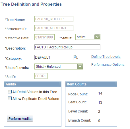

Use the Tree Definition and Properties page (PSTREEDEFN) to create a new tree to identify the tree name, related structure ID, SetID, and any other rules or characteristics of the tree.
Navigation:
Tree Manager, and then Tree Manager, and then Create New Tree, and then Tree Definition and Properties
You can copy an existing tree structure or create a new one.
This example illustrates the fields and controls on the Example of a FACTS II Account Rollup tree definition.

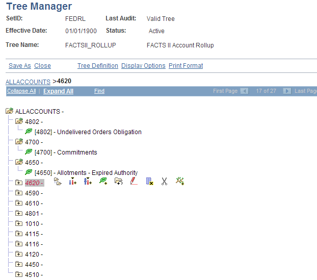

Creating a FACTS II Account Roll-up Tree
Use the Tree Manager page (PSTREEMGR) to access an existing tree with options that enable you to access and modify the tree definition and properties, and print and configure tree display options.
Navigation:
Tree Manager, Tree Manager, Find an Existing Tree, Tree Manager.
Create a FACTS II Account Roll-up tree in PeopleSoft Tree Manager similar to this example. Before you create this tree, you must define your Account ChartField values and determine your detail structure.
This example illustrates the fields and controls on the Example of a FACTS II Account Roll-up Tree. You can find definitions for the fields and controls later on this page.
The FACTS II Account Roll-up Tree stores the hierarchical relationship between SGL accounts that you report to the U.S. Treasury for FACTS II and an agency's posting accounts. The FACTS II Accumulation process uses this tree to roll up the posting level account ChartField values into the SGL accounts. Each agency may have a different combination of lower-level posting accounts that roll up to an SGL account structure that is mandated by the U.S. Treasury for FACTS II reporting. Determine the lowest level of detail that you need for your Account ChartField structure to capture all possible combinations of USSGL accounts and FACTS II attributes, as well as additional agency-specific posting detail.
Your agency can use any tree and level names as long as you specify these names on the FACTS II Tree Group. You must create the FACTS II Account Roll-up Tree to run the Accumulate FACTS II Data process.

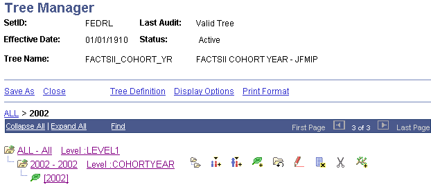

Creating a Cohort Year Tree
Create a Cohort Year tree similar to this example:
This example illustrates the fields and controls on the FACTS II Cohort Year Tree Manager page. You can find definitions for the fields and controls later on this page.
Create a Cohort Year tree at the COHORTYEAR tree level for each cohort year based on the reporting needs of your agency. Enter the appropriate detail values that identify which ChartField values (loans) roll up to a particular cohort year.
The Cohort Year tree is the exception to the rule that the FACTS II tree node names should always match the values that are required by US Treasury. In this instance, Cohort Year values in the FACTS II file are only two positions. However, the tree is set up with four character node names to keep it consistent with the Cohort Year tree in earlier releases, as well as with the way the program derives the Cohort Year values. The program will take the third and fourth character of the node name to derive the FACTS II file Cohort Year values, for example, 2005 becomes 05 in the FACTS II file.
The Accumulate FACTS II Data process uses this tree to identify ChartField values that represent loans associated with a cohort year for the production of the FACTS II Treasury input file. In this example, the loan numbers roll up to the COHORTYEAR tree level, which contains the cohort year information that is required for FACTS II reporting. You may also use a different configurable ChartField for this purpose. Because an agency may have projects that are not loans and are not associated with a cohort year, this tree is used to distinguish between the two types of project ChartField values. Each agency should determine the ChartField structure that it needs to satisfy its cohort year requirements.
You must set up the ChartField values before you create this tree.

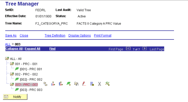

Creating a Category A Tree
Create a Category A tree in PeopleSoft Tree Manager based on this example:
This example illustrates the fields and controls on the FACTS Category A Tree Manager page. You can find definitions for the fields and controls later on this page.
The Accumulate FACTS II Data process uses this tree to identify category A programs and to extract the three-digit program sequence number and category A program description that is needed for the production of the FACTS II Treasury Input file. Your agency may have programs that are both category A and non-category A programs. This tree is useful to distinguish between the two. Each agency should determine the ChartField structure that satisfies its category A and non-category A reporting requirements. The tree level that is specified on the FACTS Tree Group page identifies the node values and node descriptions that contain the three-digit sequence number and category A program description, respectively.
The OMB supplies and requires the input of Program Reporting Categories for Category A apportioned funds when an SGL account contains a Y in the Program Rpt Code (program reporting code) column of the Fiscal 200X USSGL Account Attributes Required Table. The OMB provides valid Program Reporting Categories from which Federal Program Agencies (FPAs) can choose. The OMB list of Program Reporting Categories serves as a control table or as a reference table for FACTS II reporting.
FPAs cannot use the OMB-supplied program reporting numbers with the FPA titles. The FPA is also restricted by FACTS II from using the default program number and description, 99 All Programs, with other OMB program codes and descriptions or the custom program codes and descriptions of the FPA.
If OMB does not provide specific program reporting categories, then the FPA can use the default program reporting number (99) and description (All Programs).
While an FPA can use numbers and descriptions for program reporting categories in addition to those that are supplied by the OMB , they cannot use the 99 All Programs program reporting category with any other codes. If the FPA attempts to add the 99 All Programs category to existing program reporting categories for obligation activity, the FACTS II rejects that input because the 99 All Programs category can only be used by itself.
You can use any tree name and level name as long as you specify the desired tree name and level name on the Accumulate FACTS II Data page. This tree is required for the Accumulate FACTS II Data process (GLS8302).
You must set up Program ChartField values before creating the Category A tree.

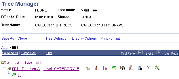

Creating a Category B Tree
Create a Category B tree in PeopleSoft Tree Manager based on this example:
This example illustrates the fields and controls on the FACTS Category B Tree Manager page. You can find definitions for the fields and controls later on this page.
The Accumulate FACTS II Data process uses this tree to identify category B programs and to extract the three-digit program sequence number and category B program description that is needed for the production of the FACTS II Treasury Input file. Your agency may have programs that are both category B and non-category B programs. This tree is useful to distinguish between these two types of programs. Each agency should determine the ChartField structure that satisfies its category B and non-category B reporting requirements. The tree level that is specified on the FACTS Tree Group page identifies the node values and node descriptions that contain the three-digit sequence number and category B program description, respectively.
You can use any tree name and level name as long as you specify the tree name and level name that you want on the Accumulate FACTS II Data page. This tree is required for the Accumulate FACTS II Data process (GLS8302).
You must set up Program ChartField values before you create the Category B tree.

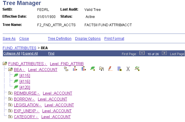

Creating the Accounts Requiring Fund Attributes Tree
Create an Accounts Requiring Fund Attributes tree using PeopleSoft Tree Manager based on this example:
This example illustrates the fields and controls on the FACTS II Account Requiring Fund Attributes Tree Manager page. You can find definitions for the fields and controls later on this page.
(replaced by GTAS) FACTS II Account Requiring Fund Attributes Tree Manager page
The FACTS II Accounts Requiring Attributes tree stores the relationship between the ChartField attributes that are required for FACTS II processing and their associated SGL accounts.
This tree filters out the attributes for accounts that do not require certain attributes to be reported. After the FACTS II Accumulation process accumulates all the attribute data, it checks the accumulated attributes against this tree to determine whether they are required to be reported. If the attribute is not required, it is removed from the staging table and is not included in the FACTS II file. To determine the attributes to be reported for any given account, the program takes the account from the ledger (such as 4119) and searches for the account in the FACTSII_ATTRIBUTES tree. The account may appear under numerous nodes depending on which attributes are required for that specific account. Wherever the program finds the account in the tree, the attribute is considered as required for reporting. If the program has previously accumulated an attribute value for the account, but is unable to locate the account under that respective attribute's node, the accumulated attribute value will be excluded from the FACTS II file.
The F2_REQ_ATTR_ACCTS Tree and ACCOUNT Level are examples of values that the FACTS II processes can use. You can create your own tree name and level name, as long as you specify the tree name and level name on the FACTS Tree Group page. You must set up this tree to run the Accumulate FACTS II Data process (GLS8302) and the GL Activity with Attributes Report (GLS7017).
Make sure that this tree consists of all accounts that are required by the U.S. Treasury for each attribute. If your agency does not use an account that the U.S. Treasury requires, then the agency does not have to define the account on this tree. The fund code and account ChartField attributes are predefined and delivered in the PeopleSoft sample data.
Four node names must be named exactly as specified:
  • PUBLIC_LAW
  • FED_NONFED
  • TRF_AGENCY
  • TRF_ACCT
All other nodes must be named exactly the same as the attributes that are listed on the Attribute Xref page. For example, if the user has called their Authority Type attribute AUTH instead of AUTHORITY, then the node name must be AUTH.
These attribute nodes are not required on the Accounts requiring Attributes tree:
  • The Normal Balance, Debit and Credit, and Begin End attributes because they are always required to process FACTS II. The program does not check against this tree for these attributes.
  • The TAFS status attribute because it is not required in the FACTS II flat file.
  • The Transfer To/From and Deficiency Flag because these values will be derived by the U.S. Treasury.
The U.S. Treasury's SGL Account Attributes Required for FACTS II Reporting of Detailed Financial Information defines these rules. This information is available at the U.S. Treasury Department's website.

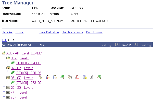

Creating the Transfer Agency Tree
Create the Transfer Agency tree using PeopleSoft Tree Manager based on this example.
This example illustrates the fields and controls on the FACTS Transfer Agency Tree Manager page. You can find definitions for the fields and controls later on this page.
This tree contains nodes for each of the transfer agencies. If you have decided to use the same ChartField for both Transfer Agency and Transfer Account, then the values in your ledger for that ChartField will represent both Transfer Agency and Transfer Account at the same time. The tree will allow the program to translate the combination Transfer Agency/Account value of the ledger to the Transfer Agency value that is required by the U.S. Treasury.

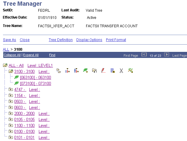

Creating the Transfer Account Tree
Access Tree Manager to create the FACTS II Transfer Account tree.
This example illustrates the fields and controls on the FACTS II Transfer Account Tree Manager page. You can find definitions for the fields and controls later on this page.
(replaced by GTAS) FACTS II Transfer Account Tree Manager page
This tree contains nodes for all the U.S. Treasury transfer accounts. The leaves are made up of ChartField values from your ledger representing Transfer Accounts. If you decide to use the same ChartField for both Transfer Agency and Transfer Account, then the values in your ledger for that ChartField will represent both Transfer Agency and Transfer Account at the same time. The tree allows the program to translate the combination Transfer Agency/Account value of the ledger to the Transfer Account value that is required by U.S. Treasury.

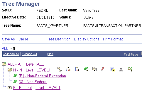

Creating the Transaction Partner Tree
Access Tree Manager to create the FACTS Transaction Partner tree.
This example illustrates the fields and controls on the FACTS Transaction Partner Tree Manager page. You can find definitions for the fields and controls later on this page.
The three nodes on this tree represent the three types of Transaction Partners: Non-Federal, Federal, and Non-Federal Exception. The leaves represent all the detail transaction partner ledger data that roll up into each type of Transaction Partner for FACTS II processing.
Before this release update, you had to set up variations of account numbers to indicate whether the account used in any particular transaction pertained to another federal organization. You did this by adding suffixes to account numbers. For example, the suffix G was added to account 1610 to create account 1610G. Also, the XPARTNER attribute was only capable of indicating one attribute value at a time. Now, the PeopleSoft system enables you to use one of the configurable ChartFields to record the Transaction Partner attribute. This means that the Transaction Partner attribute is independent of the Account ChartField, which eliminates the need to create and use variations of the same account.
If you are an existing customer, you can use the new separate ChartField approach or you can continue to use the multiple account approach. If you have used the multiple account approach in the current year, you must continue to use this approach until you get to the end of the year because all of your existing year-to-date data uses this method.
If you are using the older method, your Transaction Partner tree is designed differently and should be based on the following example:
Node ALL - All Transaction Partners
  • Node E - NonFederal Exception
    • 1010 E
    • 1020E
  • Node F - Federal
    • 1010G
    • 1020G
  • Node X - Non Federal
    • 1010X
    • 1020X
